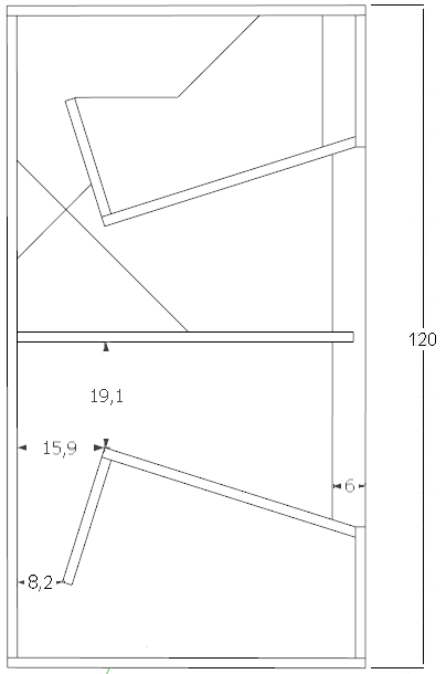

Hi boys, anyone has the plans for dual sub based on evx 180B?
Xsub, qrx218, dynacord alpha, there are couple more with these drivers.
Already got 2 amps p3000 got 4 drivers evx180b melted. Recone kits are on the way.

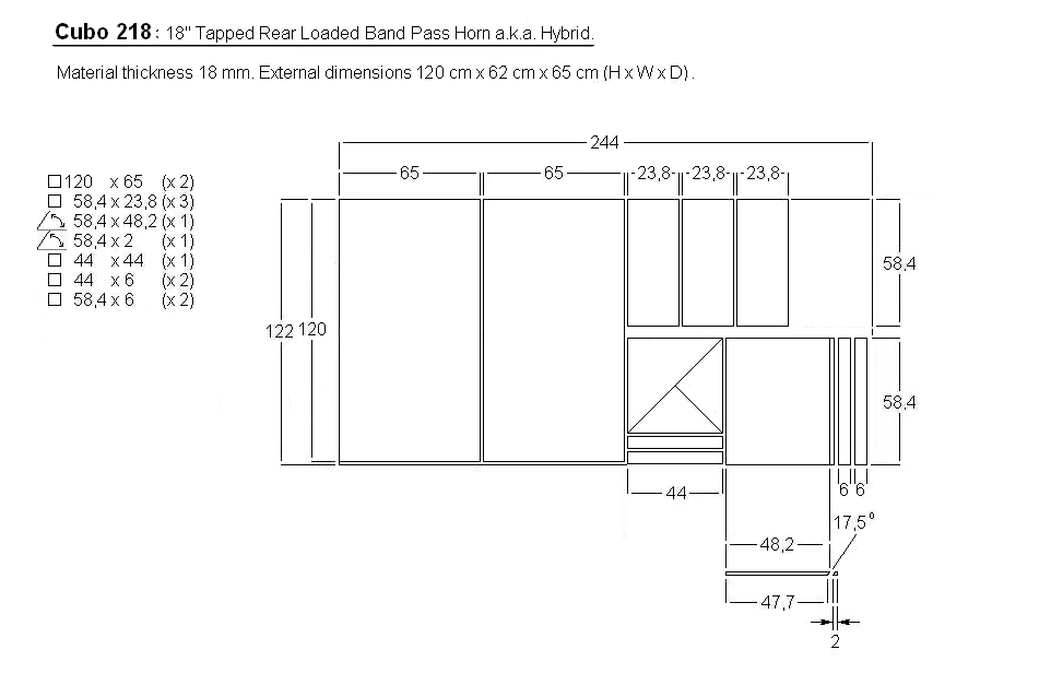

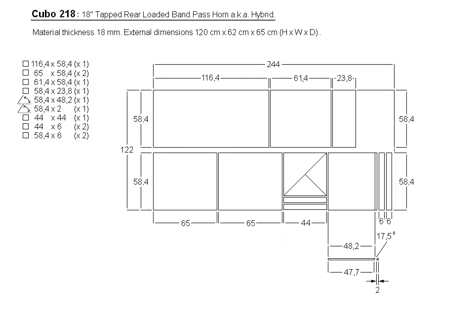

You could use Cubo 218 (basically 2 x Cubo 18 joined together). I've added the plans.
