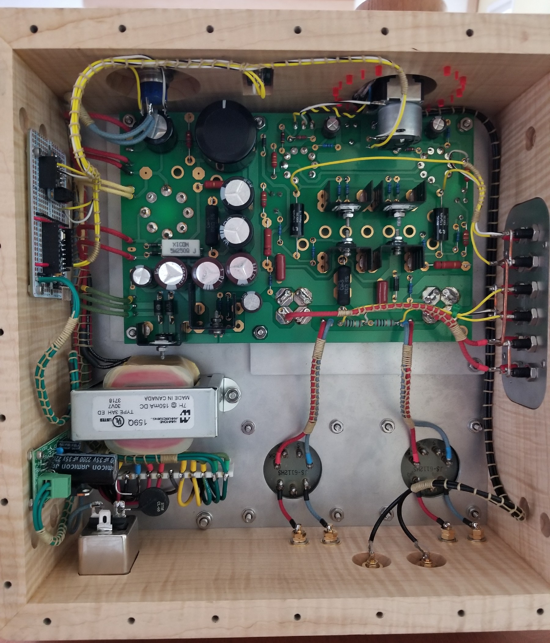

Finally received my board after a month (and belgian customs keeping the package for ten days before asking me to shell out the price of my order as 'import and treatment fees')
Here it is, already populated, only missing a few parts, semi-conductors and terminals.
If somewhat was kind enough to check if I did a good enough job soldering? I used Mundorf Supreme 10% silver solder heated to 290°C. There was some flux splatter, but apart from that, every joint seems good and sturdy.
Great to see your progress!
I'm not qualified to critique your soldering job.
The only comment I will make is that I think your cathode bias resistors should be on the opposite side of the board, if you plan on mounting the board under the chassis top plate. Not just for clearance, but also for cooling.
