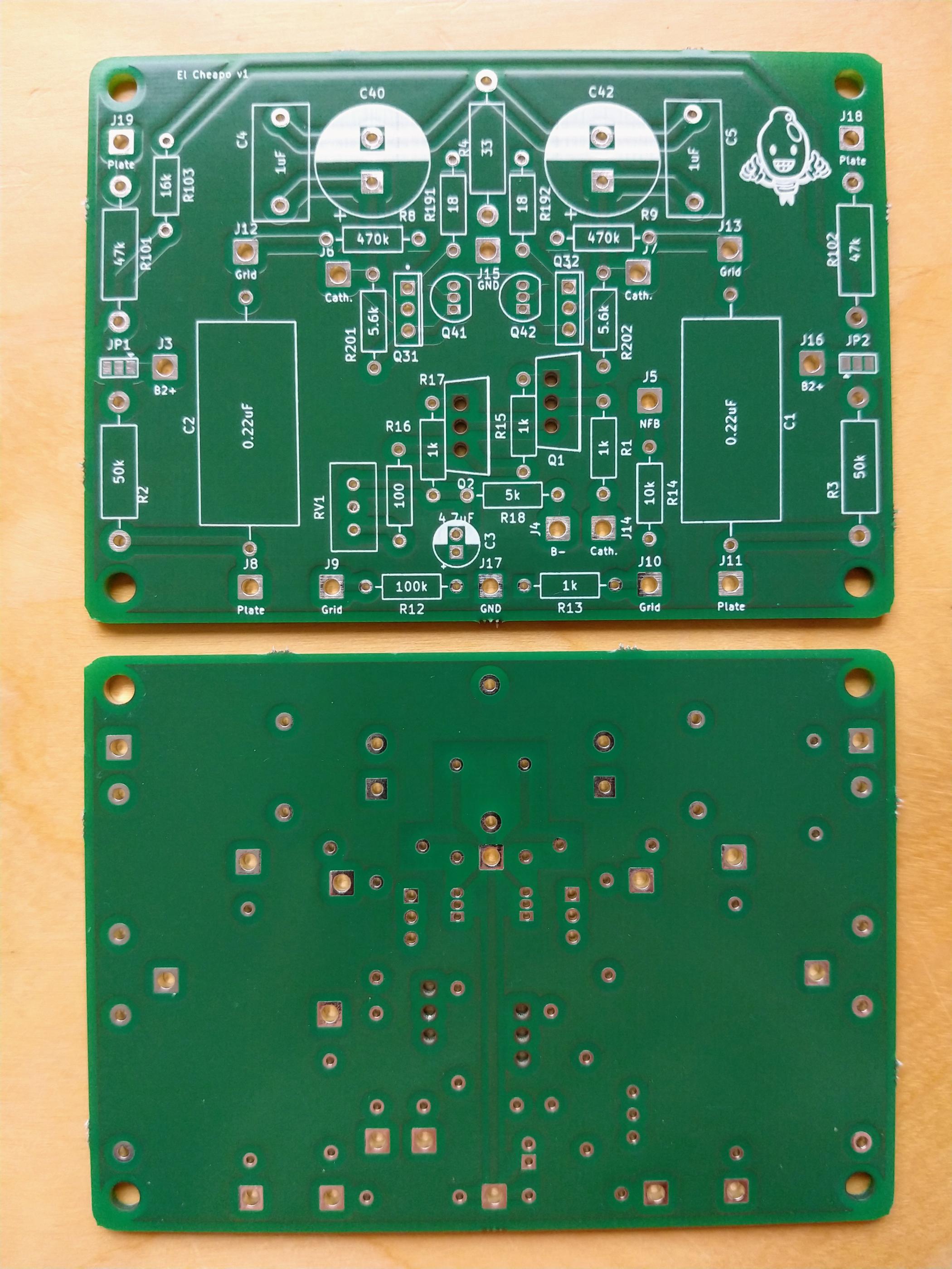

I've also made my first PCB, which I'm planning to send to Aisler for manufacturing.
I've made the schematic in diylc as I've done before, but also in kicad once I thought a PCB would be nice. I also made a layout, not nearly as detailed as I would like, but I needed some hardware to make it more tangible.

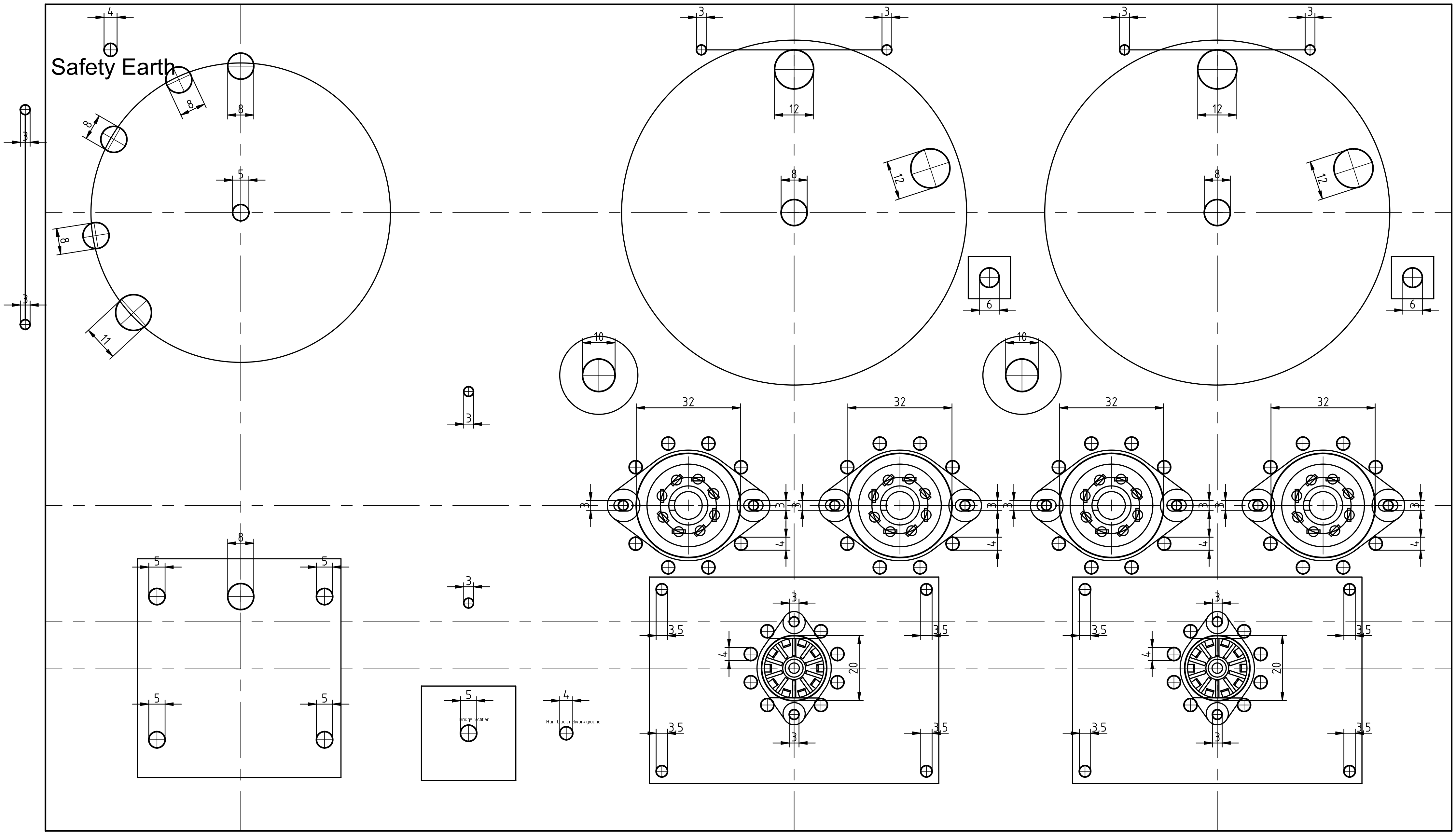

Lastly, I made my first CAD drawing in QCAD. I've had good results with just printing (previously using inkscape) that to scale and stick it to the chassis for drilling. I've tried CAD programs before, but they were not my cup of tea. Somehow QCAD seems a lot more compatible with me.

Pcb looks very nice (to a noob...). Only thing that looks weird are the pads of Q1&2. It seems that the 'model' I used in Kicad was has no solder mask. Any tips how to remove that?

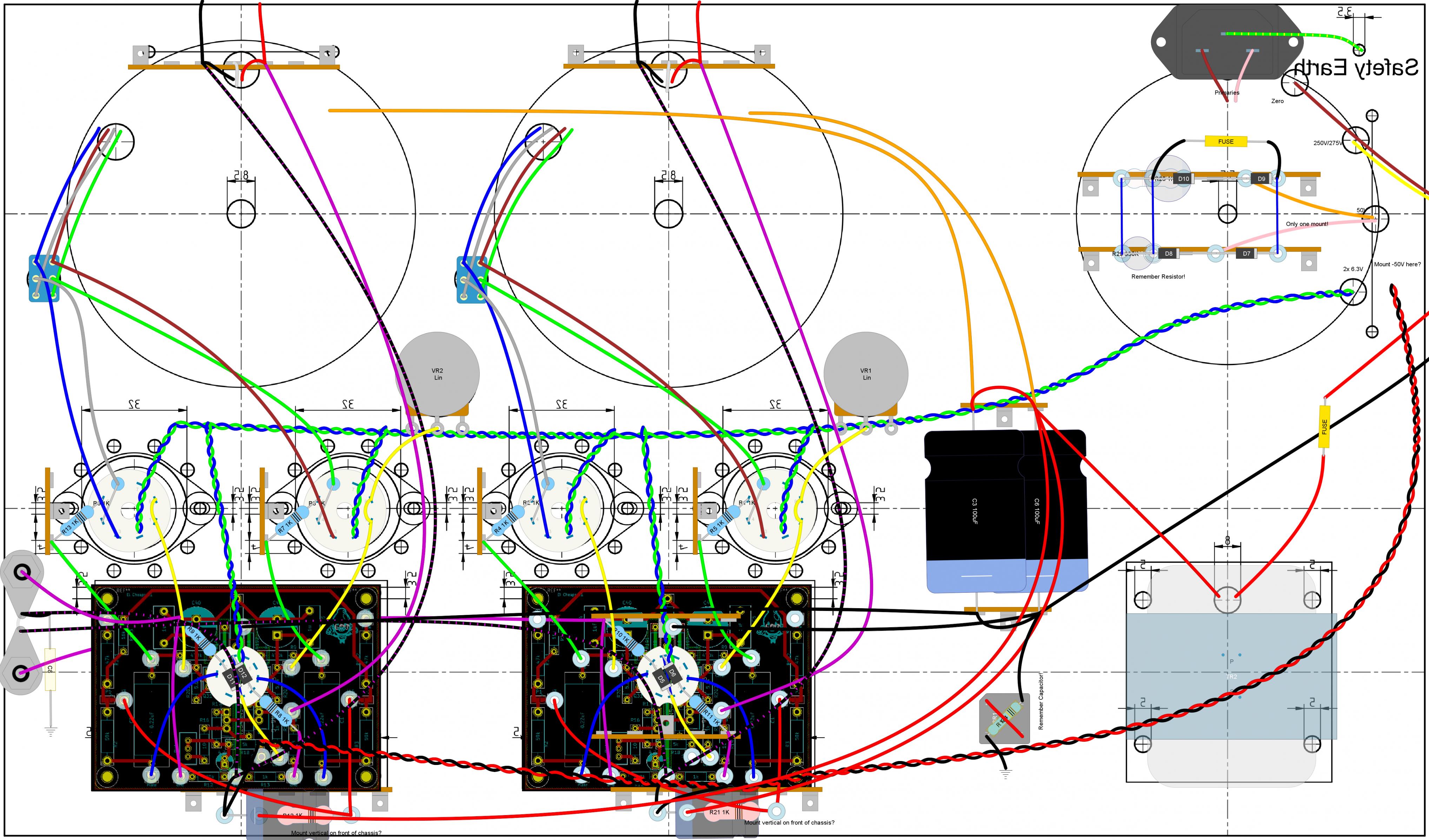

Most (hopefully all...) parts have arrived. I _think_ I have the layout and the 'drill plan' as ready as can be. I measured a lot of components and added bounding boxes. This weekend I plan to make a prototype from a thin piece of woodlike material.
Anything I completely overlooked?
