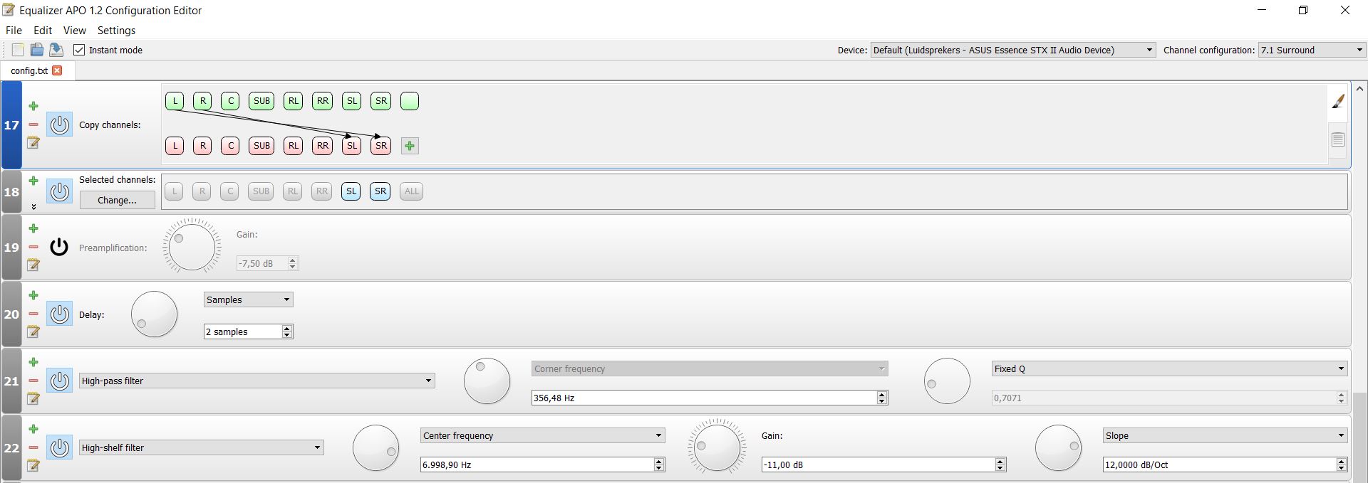

During the adjustment of time alignment of front and rear,
it seems I'm relatively sensitive voor imaging in the midrange.
Just aligning low or high frequency, does not create the image like the midrange is able to. Therefore current time alignment is based on midrange frequencies, other frequencies are being filtered out at the rear speakers, limiting their distortion on the image effectively.
However, now the sense of spacioussness has decreased. The low pass filter in the rear speakers was replaced with a high shelf filter, of which the gain was adjusted at the most comfortable compromise betweet sense of space, and image clarity.
When listening to only the front pair of speakers, I enjoy the reflections of the rear wall. When listening to the double pair, rear wall reflection distorts the image. A very large pillow is placed centrally against the rear wall, effectively removing reflections that travel from front speakers->rear wall->LP. Image has become less distorted. Compared to only the front speakers, the size of the perceived space has grown and the image is more clear. I am conflicted about the space. Should it realistic in comparison to the listening room, or should it be whatever is in the recording? For now it seems to be more comfortable to let the space be what it wants in stead of conflicting with the room. The perceived central image does not feel very connected to the perceived space yet.
About the time alignment:
The attached shows that delay to the rears is quite low, especially considering that both front channels have to pass through more external DSP.
I was expecting more delay was needed because of physical positioning.
With some albums, delay settings have to be changed to get the maximum effect.
The sound card has a seperate board for the surround channel ouputs. The DAC's on there are different from the main 2-channel output.
An internet search revealed that there are users who report a delay of the rear channels. I will need to measure the difference in delay of the stereo ouputs, the surround ouputs and the digital output+dsp/dac for a comparison.

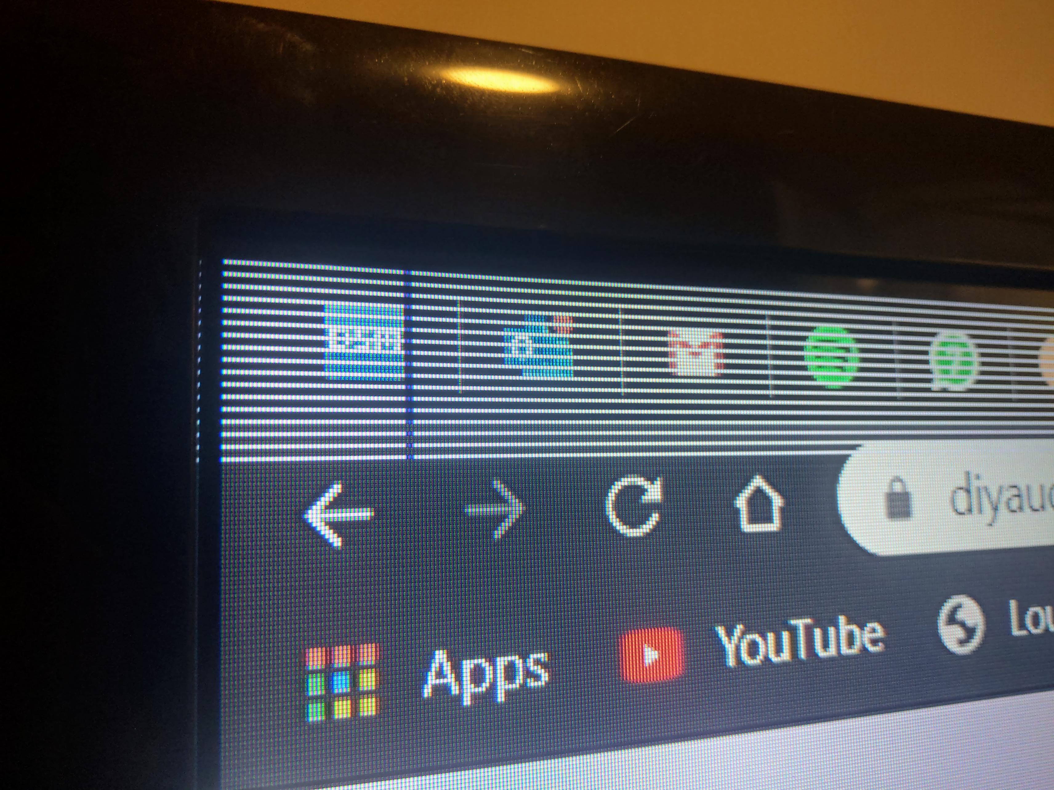

Lastly, attached is a picture of my broken TV.
I wonder how it can break in this weird way.
It looks like it has some interlaced artefacts, I was suspecting a driver or DSP fault, but I found that the screen uses "phased array" to drive the pixels that render the image. So it could be a hardware problem as well, like a signal trace gone bad. Interesting to see that in this distorted area, you can see noise that is related to what it is displaying down below. Sometimes you can even read text in this area that isn't supposed to be there. If wanted I can make more pictures of it.
Phased array sounds interesting...
And UltraSonic Imaging too.
Is knowledge of other types of imaging useful for sound image reproduction?

Robbintip, your TV set's screen is distorted because of a failed interconnect ribbon cable.
Depending on the set, the mylar cable is either clamped or glued to the screen itself.
Time to look for another set.

@wiseoldtech: thanks. I'll have a look inside to see if the ribbon cable is visible/repairable before I buy something else.

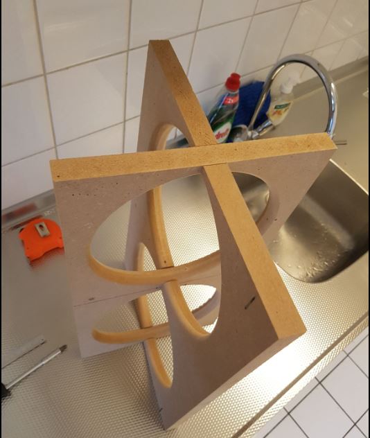

I've been working on a little something special. (second experiment)
Have some Full-Range drivers to go in the baffle.
This means I will have to modify the drivers a little bit because they are too deep, the accoustic offset is problematic.
It's not much, but it might be the kitchen-sink project that could change my experience drastically.
Think of it: when a bass note is hitting the cone of the driver in one direction, the high frequency stuff that's modulated on top of that wave, will be thrown into the same direction. Isn't it logical?
