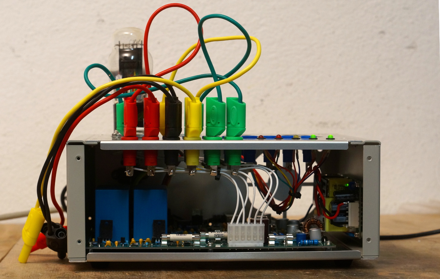

Kit arrived!
Ok, about 1 h after taking that photo most of the housing was assembled, and the eTracer board and the PSU were installed. I hooked it up to my computer and it connected to the software fine (eTracer software 2.12 running under Wine 3 on Ubuntu Linux). Looking good so far.
I have not yet built the top plate with the tube sockets, so I have not yet connected any tubes to the eTracer, and I can't comment on the performance yet. That will have to wait until after the holidays...
Questions and comments so far:
- The manual says that the GND of the USB connector might be in contact with the enclosure. It's a bit unclear if that is a good thing or not. I feel it would make sense to have the eTracer GND connected (or disonnected) from the enclosure in a more defined way.
- The manual also says that it's ok to connect the safety earth from the IEC block to the chassis. I don't agree with this. As far as I can tell, this is MANDATORY, not just ok.
- The chassis has a rather large hole for a cooling fan (which is not part of the standard eTracer configuration). It's easy to stick in a finger or other things that do not belong in there while the eTracer is connected to mains power. This is not safe, so I'll mount some kind of a grille or similar to avoid bad things from happening. It would be better to revise the chassis to use smaller holes to keep fingers etc. away from the eTracer internals.
I spent some more time in the workshop fussing around with the Molex connectors, the LEDs+wires, the safety bananas, and installation+wiring of the tube sockets. This took some time and patience, and I have not not finished all tube sockets, but my eTracer is working fine so far!
The configuration file I received from essues seems to have a slight zero offset. I guess I'll have to recalibrate my unit to get everything spot on.

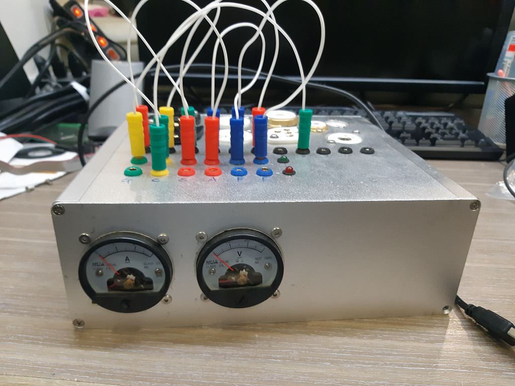

Cool!

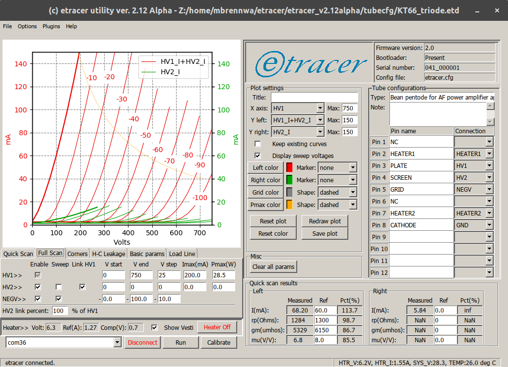

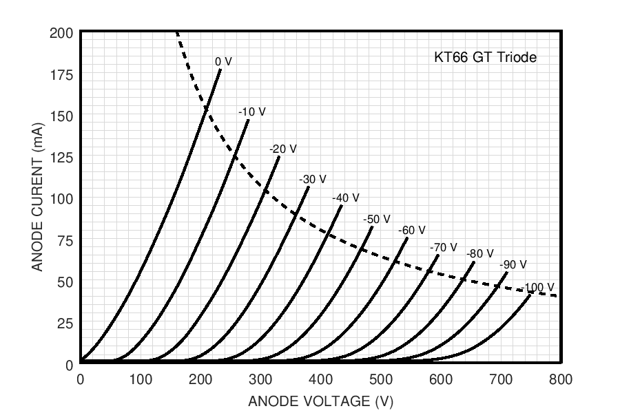

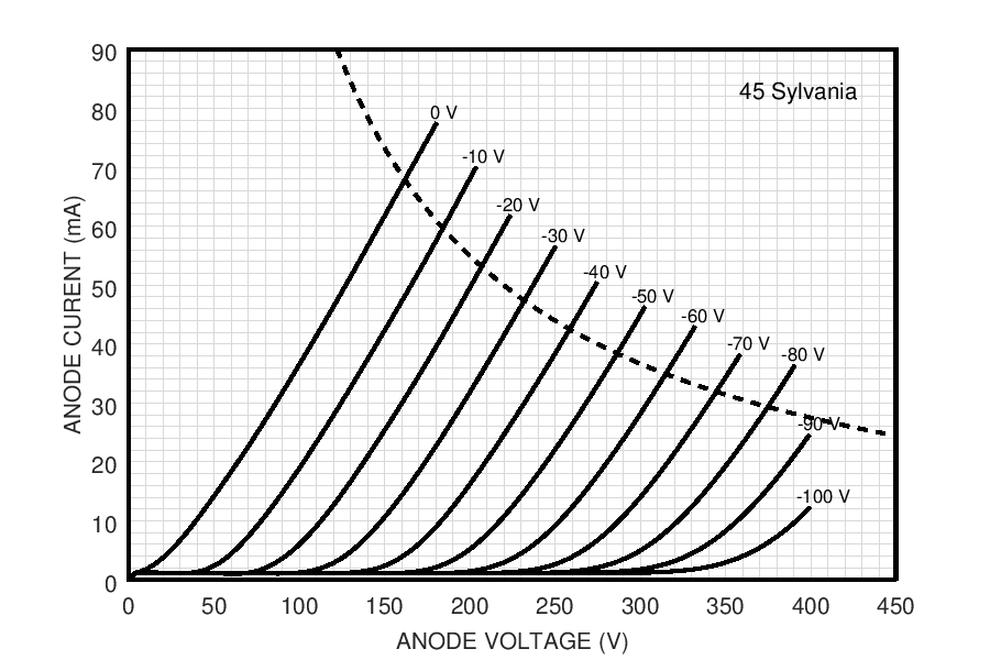

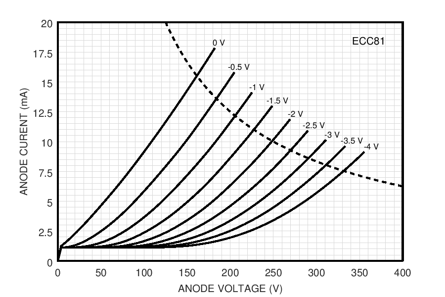

Thanks for sharing your experience with us. Here are my opinions on the grounding issues.
As stated in the manual etracer PCB does not need any grounding arrangement to work properly. If the USB GND contacts the chassis it means the chassis will be at the same potential as the USB GND at the other end (a PC or a laptop). If the USB GND doesn't contact the chassis then the potential of the chassis is either equal to E if the E terminal of the AC mains is connected to the chassis or floating. People might not like like the idea of a floating chassis but that's how most of modern devices like iphone or Macbook works.
As to the E terminal on the AC mains. Connecting the E terminal to the chassis is only effective when the AC mains is properly grounded. In many regions or countries where two-prone AC plugs are common connecting the E terminal to the chassis does nothing. Even if the AC mains is properly grounded if the cable is only two-prone (eg. AC adapters commonly used for laptops) or three-prone with the earth pin remove then the grounding also fails. To sum up, grounding (tying E to chassis) is recommended but it might not be as useful as one might expect.
I am no expert on safety measures, but I guess if there is a three prong mains connector, the protective earth (PE) pin must be connected to the chassis, no matter if the PE is implemented in the house wiring. All conductive parts of a unit must be connected to the PE pin (there may be exceptions to this depending of the safety regulations in place, such as with "Class II" devices with double insulation).
If I wanted to make a firm and well defined connection from the eTracer PCB GND to the chassis (not via the whacky USB GND), where would be the right spot on the PCB to make this connection?
For the PCB ground you can use the mounting pin of J1 (The shield of the USB connector) and bring a wire with a solder tag to the mounting hole as indicated by the attached photo.
I just looked into this. Before soldering a wire to the USB shield I disconnected the USB cable from the PCB (J1), expecting that the GND-to-chassis connection would be broken now. It's not! It seems the PCB GND is connected to the chassis via the mount screws / holes. Is this intended? If so, that's a much better path to connect the PCB GND to the chassis than via the USB shield.

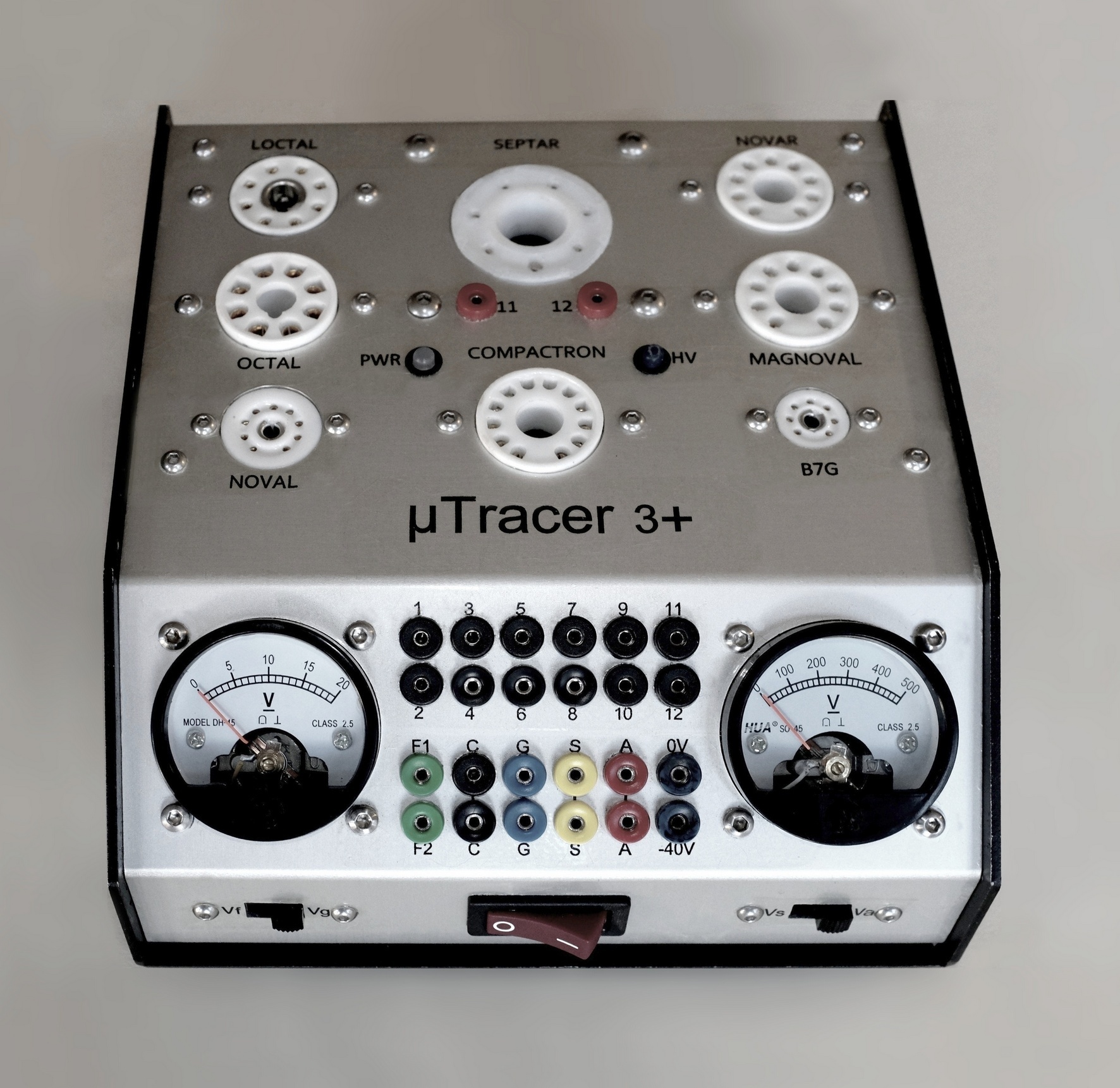

Hi Chris,
Well, in that case, if you don't mind, I will stick to this tracer
Thanks for response anyway.
Cheers, E.
No problem. utracer is a great idea. I have one too. And the mixed experiences with it initiated the etracer project. Many etracer users are also utracer owners and they do appreciate the differences between these two products.
