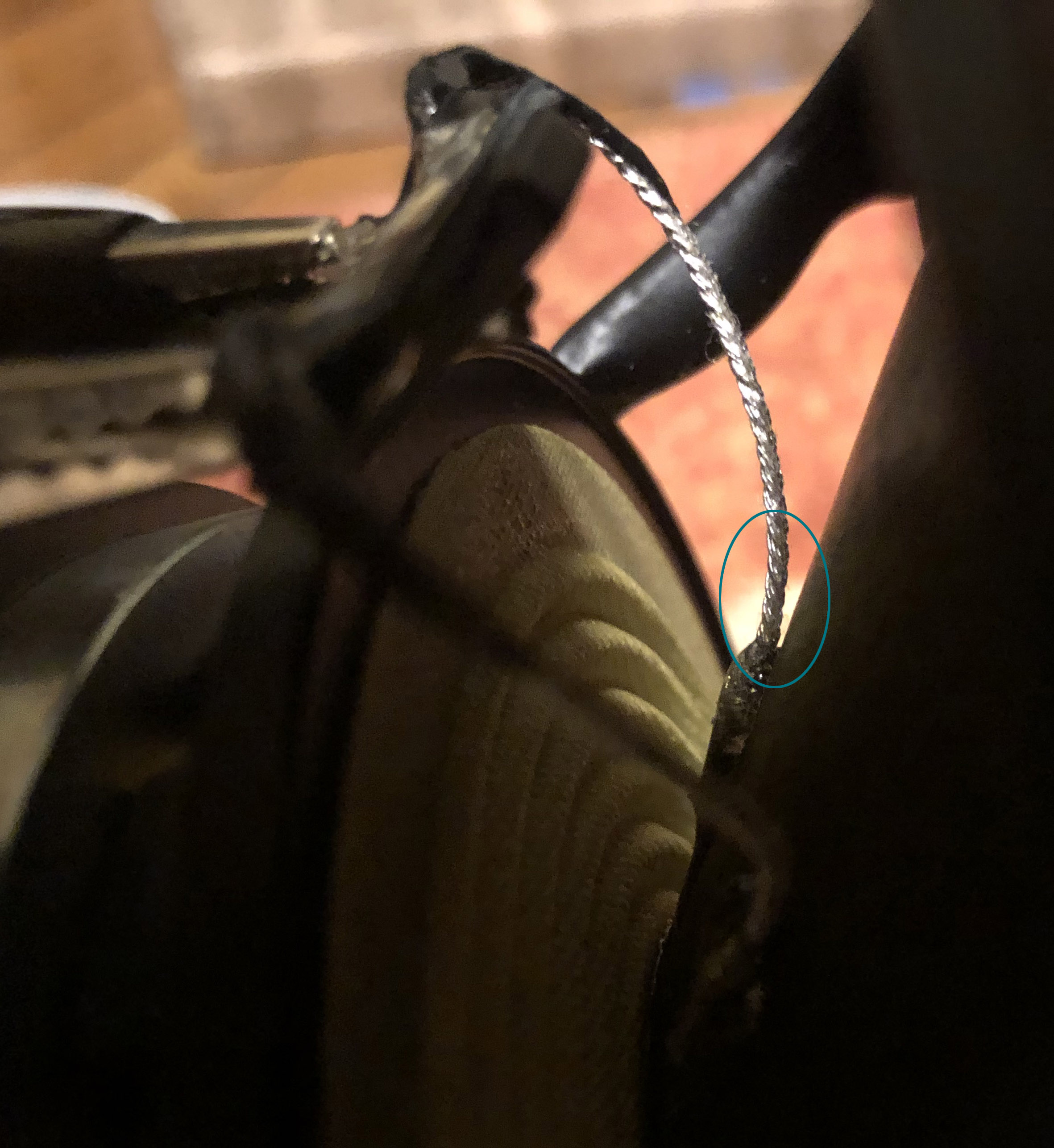

Dear DIY People,
“Just” as info :
I noticed some construction problems in some Eton 7-375/32 HEX (in 2013-2014, I thought it’s a "casual" thing!) and then again I have the same problem in 2018-2020 with some Symphony II 7-312/C8/32 HEX!
The wires connection that goes from the terminals to the coil hits the cone during excursion.
We can mainly notice it when the woofer reproduce continuos low frequencies with excursions of +-2mm or more, and it's not just a question of "noise", it brings also to higher distortion.
Incredible to believe that we can have such a basic mistake on this price point drivers (over 200,00€ per piece),
NOT necessarily all drivers have this problem! Some does (more or less pronounced) some don't. Question of luck.
ALL DEPENDS on how "carefully" they glued the wire to the cone! Above the glue point the cable is very close to the cone.
I guess they should have found a better solution that it's not so sensitive to human error.
I will try to attach 1 photo and a Video (at the end of the page). In the videos is clearly possible to see-hear what I mean.
The test was made at 30, 35, 40 and 45 Hz, and I did the same test with drivers of the cost of 20,00/40,00€ values and there was no any noise! 🙁
But it’s enough to play records like the Billie Eilish one and you will clearly ear it…

I have seen this many on many drivers. Mostly PA drivers.
Some of them bend the wire and make an "arc bridge" attached on the middle yellow suspension.
On one of my 18Sound 18'' drivers the wire broke at that point, but I've managed to repair it.
You could try to bend it a little towards the frame or shortening it, but depending on the angle, it could break then near the cone.
Make sure when You shorten it, You manually move the cone to it's Xmax positions or it will impede cone movement afterwards.
You can also lengthen the wire making a larger arc glueing around the coil.

Hi MAACO,
Thank you fro your feed back.
I forgot to write in my post that I did fix the problem already.
I CHECK ONE BY ONE THE DRIVERS AND FIX THE PROBLEM using some EXTRA glue between the wire and the cone, it's a bit tricky but the problem is "fixed". But this is not how it should be…
I put a bit of glue between the cone and the wire (just above the glued point made by the factory), in this way (when the cone is moving back and forward) the wire is not anymore hitting the cone, no anymore noise.
The glue is not thermal kind of glue, I use an "elastic" kind of glue and transparent.

Waaaay back Eton had -cough- not the best reputation on mfg consistency and reliability. Such a shame, their R&D was a class higher. Seems not much has changed.

Hi HeadShake,
Don't worry for the 3" mid you have, I think you will not have this kind of problem (and anyway it's not happening to all drivers), over 100 hz you really will not! 🙂
It is not really related to a certain low frequency, I just input to the drivers a frequency that make them move "well".
They don't resonate to a certain frequency, it's simply a physical problem. If the wires above the gluing pointe (on the cone) are too close to the cone then when the cone is moving continuously back and forward the wire may vibrate (hit the cone) and make the noise.
Please note:
- Eton drivers have a very good natural sound quality, with a great image-3D reproduction. Better then some other good drivers in the market. And they are also capable of a very good dynamic!! 🙂
- With acoustic music it's very rare to have a not changing "continuous frequencies" (I mean a 45 hz sine wave like in the test I made). You can have it with Organ, or maybe with a Contrabass in some cases. The music is more "impulsive".
But I did ear this problem DURING music listening! It was during pop music record that had some continuous low frequencies (3 tracks from the Billie Eilish CD, or Lana Del Rey and so on...), but it was also possible to ear it in some acoustic music records but it was more rare and less prominent.
Still... it shouldn't happen!
Best! Andrea

More info...
For who may think that I am driving this 7" Eton driver as crazy to get the "wires to cone vibration" problem, then look at this 2 videos. Before I fix the problem and after I fix the problem. Are you able to ear differences? As you can see we are here around a +-2mm xmax!! Music is from Billie Eilish CD, track 9 (but this problem is audible also with other musics and tracks). Best, Andrea View attachment 01-IMG_2612-.mp4

Also had this issue with 18Sound and model 15LW1401 many times with 4 different batches varying from 2004 to 2014 😓I have seen this many on many drivers. Mostly PA drivers.
