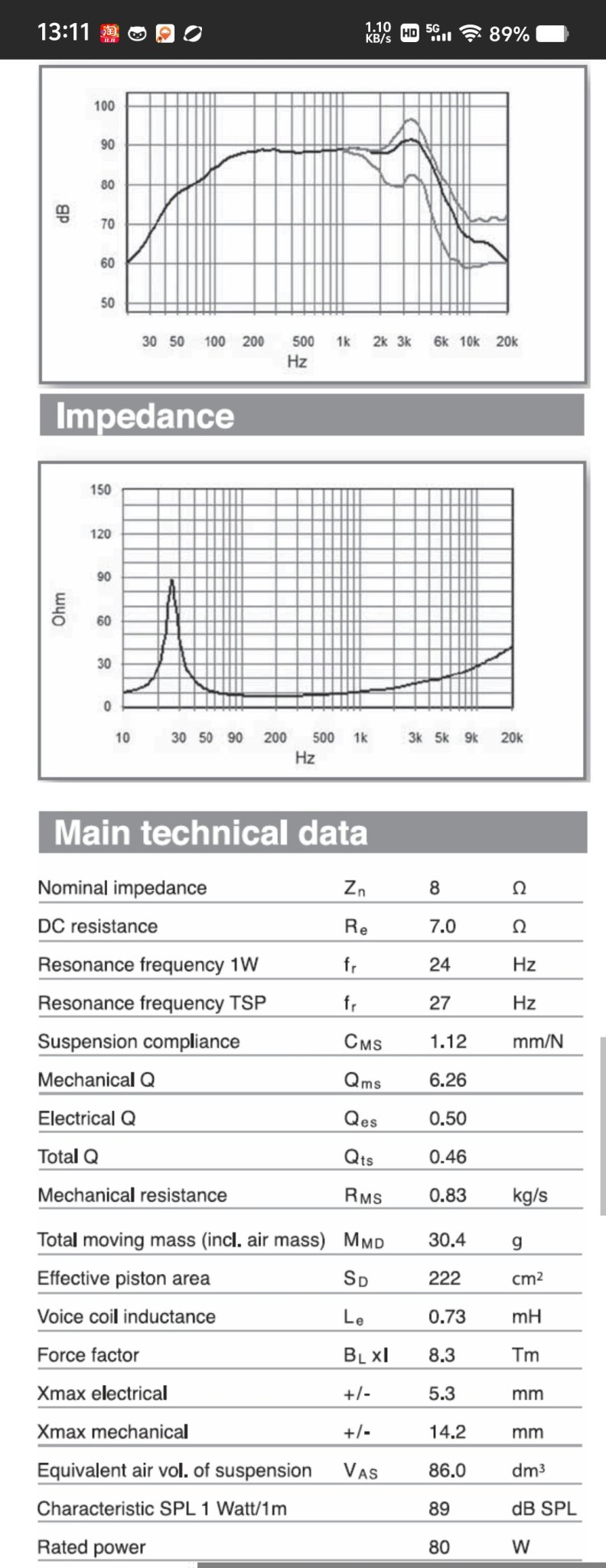

Thanks for the alert. I'm now trying to land a used pair... The page suggests sealed cabs but the published FR chart doesn't seem to support 40s usage sealed, -12dB infinite volume. Please help me understand this. Also, XO low-pass info/experience appreciated.I, too, was intrigued about the potential low 40's f3 in a sealed box.

Is there something wrong with this 8" driver's response curve? Infinite baffle, 700L. Eyeballing: inflextion 120hz -3dB; 85hz -6dB; 55hz -10dB; 45hz -12dB; 35hz -18dB; Fr TSP 28hz, Fr 1W 25hz. Thanks.

Dunno but maybe Eton's graph is b.s. Then again, K&T's test of its brother 8-212 is in the ballpark https://www.hifitest.de/test/lautsprecherchassis-tiefmitteltoener/eton-8-212c837-hex-17177
Thanks for the reply. High-Qts 8-412 and the similar 8-512 seem to fall off 1.25-1.5 times faster in dB than the low-Qts 8-212. I had thought it should be the other way around....Dunno but maybe Eton's graph is b.s. Then again, K&T's test of its brother 8-212 is in the ballpark

This is a nearfield plot taken at about 3mm I think. It is 3dB down at 47Hz (so not the low 40's but low enough for me).
My Q is a bit more than .707, I never computed it. In a bit bigger box the -3dB point might be a bit lower.
These drivers are kind of unobtainium now. Sealed box drivers are not as popular as they once were although there are still some suitable ones out there.
