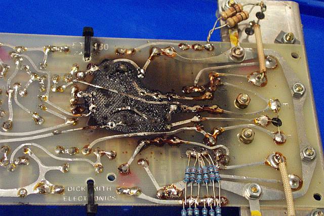

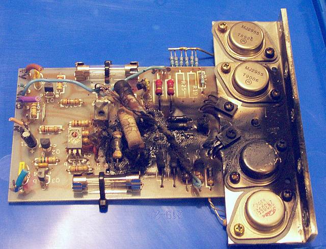

My wife was using the system today when it suddenly made a "strange noise" and smoke suddenly poured out the top of the box and filled the room. Stunk the whole house out it did. Killed both of my AUD$30 sub drivers too. :( No obvious reason why it quit. Think I might just have to transplant a gainclone setup into it now.

Hi Graham, perhaps your wife is partying while you are out. :eek:
I have not seen an ETI-480 go RF before - dodgy interconnects contacts perhaps, or needs impedence compensation across the drivers ?.
Anyway you now have a reason to try those WES PP 8" drivers that we spoke of. ;)

mikee12345, That's quite a possibility, because the emitter resistors of the driver transistors got it full blast. You can see then right in the centre of the board going at a slight angle. They look about as thick (and as burnt) as a cigarette. The ones I used were wirewound ones (inductive, uh oh stability?!?!?!) because they had been cooked before because this amp had been used as a high power ultrasonic source in a previous life and was redlined for extended periods e.g 1 week day and night on several occasions. Actually those resistors have the wire windings right close to the surface and it seems they set the green caps alight first...
Another possibility is that mentioned by sajti, that is the voltage rails. The original magazine article said + / - 40v was ok at low levels but at full power they should droop to + / - 33v with a 28-0-28v 2A transformer. The (free) tranny I used has a 28v 4A and 29v 7A windings. The rails are a little lopsided but sometimes the higher one sits at 42v. With the bigger tranny the rails wouldn't droop as much as intended. Lookout safe operating area! Maybe the mains was a little high that afternoon? Seeing I wasn't home I can guarantee the volume was at max (doesn't quite clip at max setting BTW), and also my subs are pretty inefficient courtesy of the 60 gram coin collection stuck on the front to lower the resonance. Another thing, only one of the fuses popped. All of the burny stuff is not fused.
