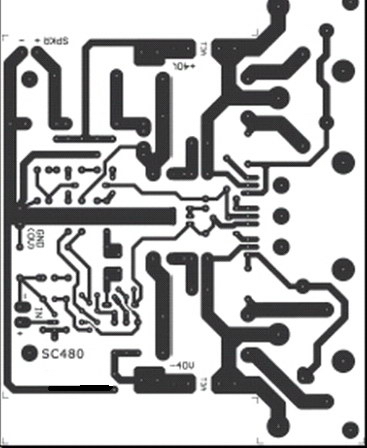

Carlos, you have the design of the pcb? can you send to me?
destroyer X said:Please, your personal E mail adress.
I had it, but computer was formated, all data deleted.
regards,
Carlos

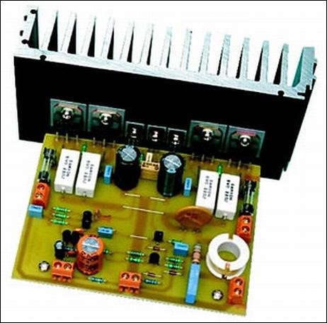

M Evil, i suggest you to forget this amplifier...really not so good!
The amplifier is something that you can call average (medíocre) having not special sound.
I tested it deeply, i changed all transistors for hi speed units, Miller capacitors reduced, used Silver Mica units.... bias adjusted, no off set, voltages correct, nothing wrong with it related construction.
SC480 really have adequacy to its price...low price and also low quality
The amplifier sounded week in power, without good presence, showing some peak around 250 Hertz
Top high frequencies disappeared from my unit, well, amplifiers never the same, another can give better response.
Bass is out of control, seem a big drum with the acoustic leather loosen... too much short in timing and frequencies
seems to be the same all the time, alike one speaker with terrible ressonances related 250 Hertz...so, when driven
always will convert some frequencies to something different.
Details disappeared, and i tried using very special capacitors too, also reduced the Miller in a try and error basis,
output inductor changed to lower values but negative, work better with enormous 5,6 microhenries.... and 150N to
ground!...Oh! my God!
The input capacitor was changed many times, ceramic, bipolar electrolitics, poliester and Tântalum, beeing the last
one producing better results.
The amplifier is not so sensitive, but saturates easy, and the distortion, when over driven is something that came
from eleventh underground stage, there!...deep in the hell.... seem gases beeing liberated in the bass region.
I think it is a very poor amplifier.

My unit will receive a double barreled shot... 2 twelve gauge will kick it out!
But this do not seems that the amplifier is always bad.
As i told you, Mr. Mateus made one very good sounding unit, and he prove that making professional recordings and send me to check...really, his unit is wonderfull related the sound i could achieve in my home....maybe my speakers...well, those things are dependable of too many variables, judgment of quality is not always precise, and normally subjective.
Even comparison tests will depend from the speaker you choice as "Monitor unit!"
regards,
Carlos
regards,
Carlos
carlos, i will mount this amplifiier to iniciate in solid state amplifiers... Is this apropiate?
Tks
Tks
Carlos, don't be crazy 😎 . Do you have a scope ? I was looking at this schematic - it is very similar to Tiger .01, which is good amp. If you show photos of curves at scope, probably I will can to tell you where is mistake 😎.
