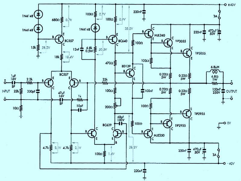

I had built ETI-480 100W amps but I cant make it work the right way is runs on 50+50v 8 ohms load the 100 Ohms resistors "Test resistors" burn every time so I found a way to make it work I jumped the protection transister becuase I have the idea the problem are that. so can somebody please tell me to to get rid of that protection transistor, Q6 I disconected it and put a that varible resister in paralell with the C6 cap and i tried to get the voltage +- 3.5 V and in the RV1 place I put a 470 Ohm resistor and that all worked for a thew hours and them it gets unstable the two amps are om a heat sink with 2 pc supply fans so it keeps cool.
So after a thew hours were coms s sss sss sound out of the speaker output i tested it it's not my speaker, it even blowed up one of my small tested speakers shame hehehe, well anyway can somebody please help me to get that bugger of a protetion out of this amp.
Your problem is probably HF instability due to your construction - these modules were never designed to have the heatsink/outputs/drivers separated from the main board. Try twisting the wires to each transistor together ie. 3 twisted wires to each tansistor - this may help.
Q6 is not really protection, it is vbe multiplier to set and stabilise quiescent current - with this disconnected the output is in danger of thermal runaway.
Also, if your are using the original 2N3055/MJ2955 transistors, DON'T run them on +-50V - the original +-40V is pushing it.
Cheers
Graeme
edit: BTW, shouldn't this thread be in Solid State??
I made one amp without putting that RV1 on parellel with the cap C6, and it worked by taking R14 and R18 out, but the amp do not have all the power it need, becuase the bass dissort so I think that R14,18 that are 47 Ohms must be a larger or smaller Ohms becuase im using 50v maby everthing are mixed up the orginal plans are 40v I dont know if it can make any diffrence but you newer know

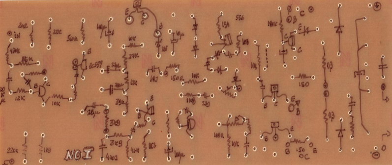

Showing here, to you, the Ìon Obelisk board i made, not to produce mistakes and explosions..... what a shame, when i think about Jan Dupont and Jens Rasmussenboards.... this is a trash compared to their work!...the are the world best in boards design and construction, simply the world best, they are unbeatable, Jans and Jens, both are incredible competent in this area.
Íon Obelisk is some amplifier already posted in our forum, i think the scientist Padamiechi have something related to it..Eastern Europe wonderfull guys....alike Pavel, Epupa and some others.
