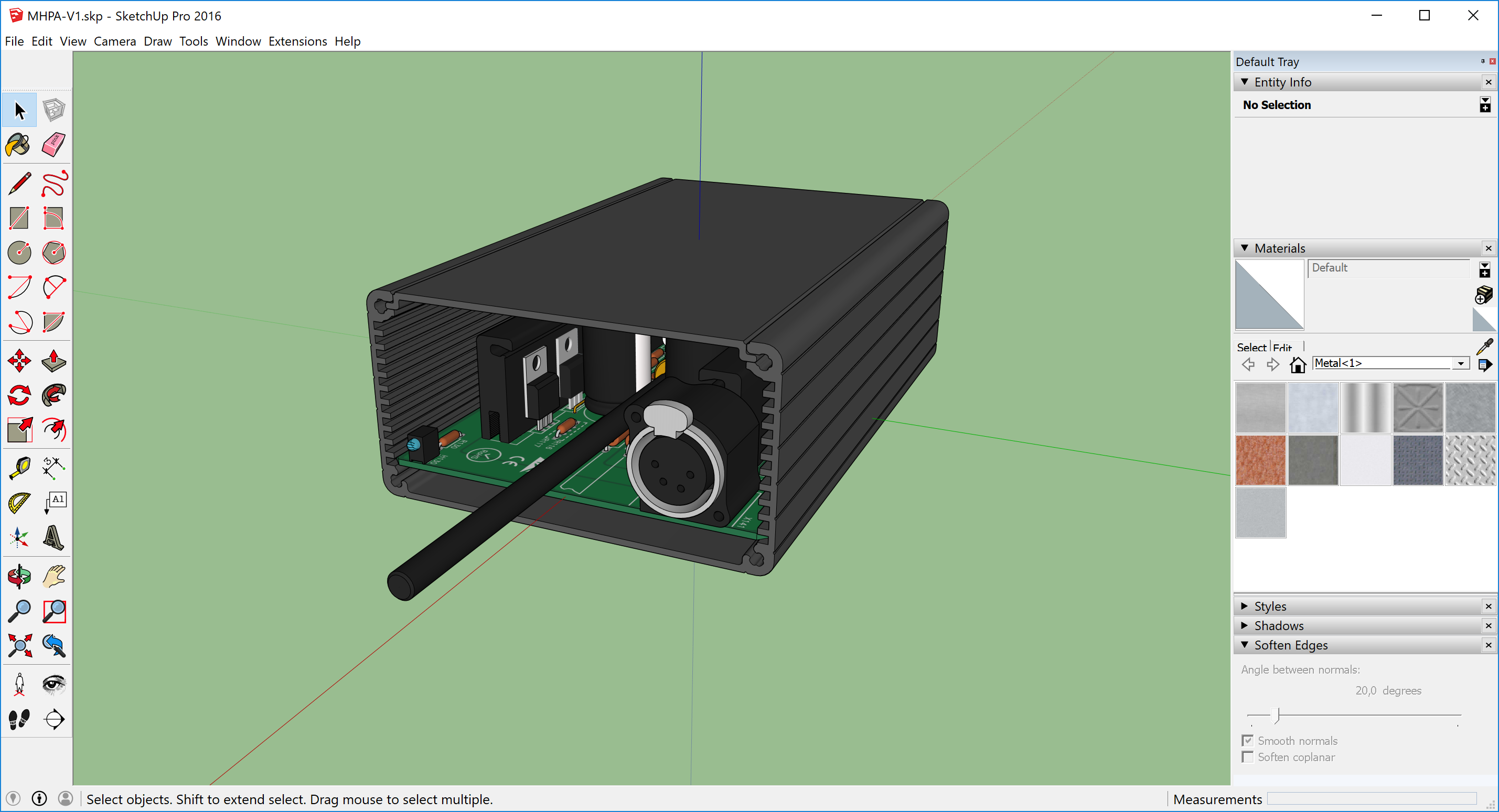

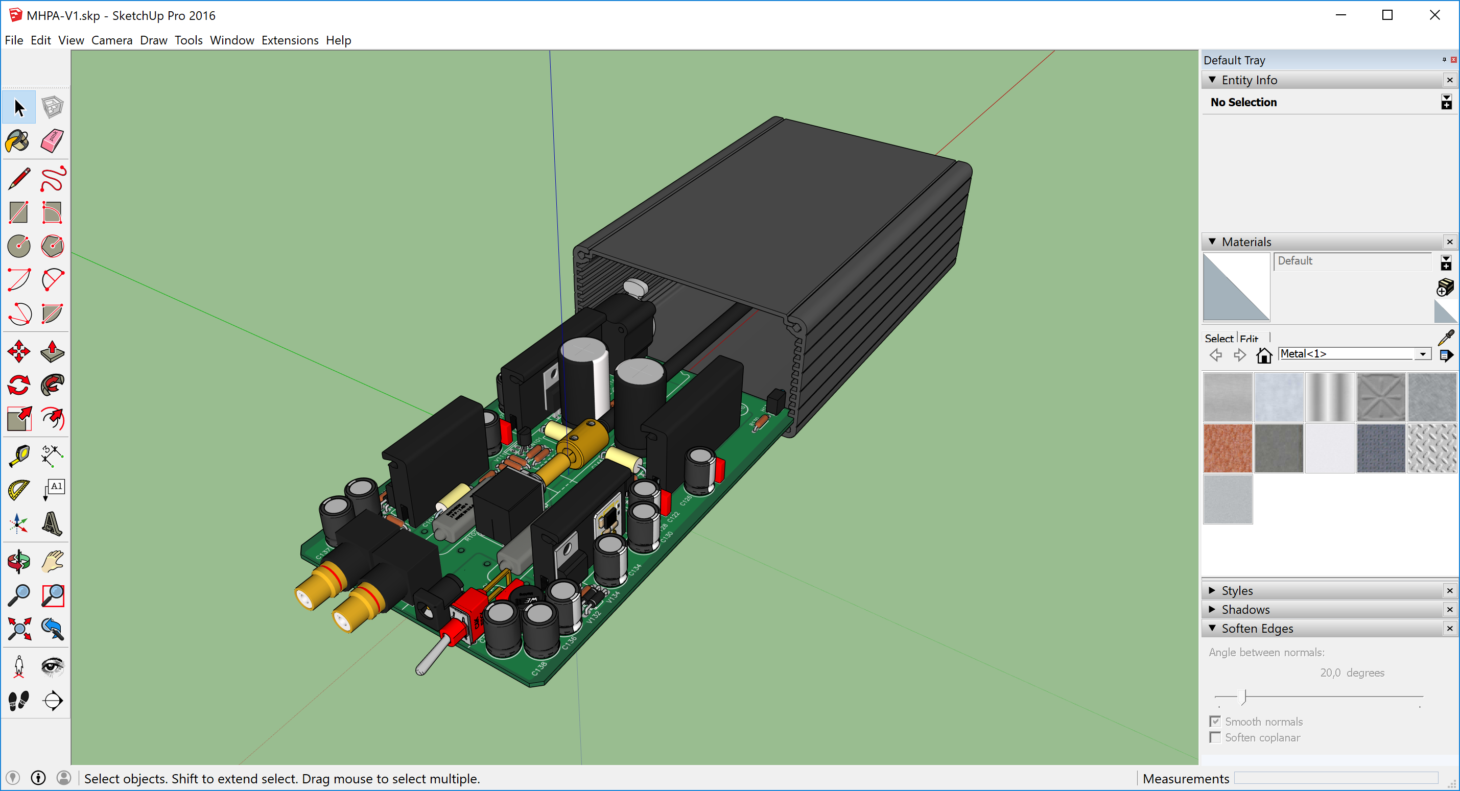

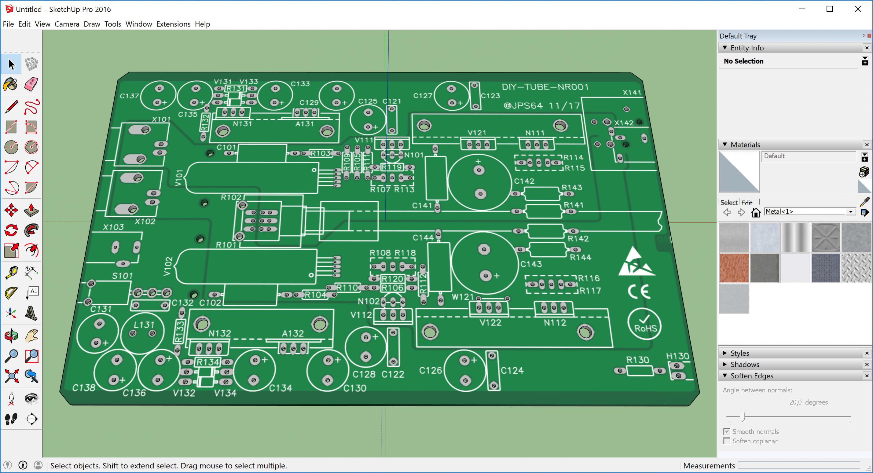

Here, after successful test, 1AD4/IRF510 Headphone Amplifier.
I will order a batch of 5.
JP
JP
Nice work JP. What DC-DC step up are you using? Note that you need to use the LM317HV for the CCS of the SE Class A output stage. I tried regular LM317 and it did not work. Very finished design.
I bet with the 24V supply it will be ok.
