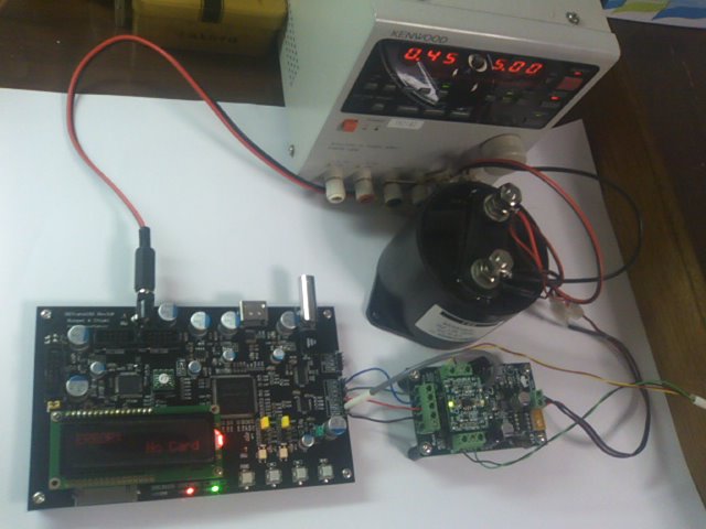

My power supplies are very humble and simple as shown on this photo,
but suitable for various experiments including Class-D amplifiers.
1. +-18V, +8V, -6V Kenwood regulated DC Power Supply with
CDE(Cornell Dubilier Electronics, Inc.) 100uF 600V Film capacitor
(The power supply itself is not for audio grade. However, the CDE Film capacitor makes it of audio grade.)

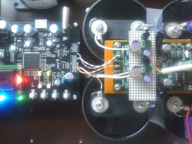

First, I really want to express my true gratitude to Coris.

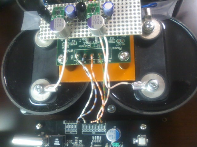

For bypass capacitors on AVCC power line of ES9018 (Buffalo II), I tried 100 microF 800V film capacitor (944U101K801) manufactured by Cornell Dubilier Electronics (CDE) at the output side of my DIY linear regulator sub board.
(The big "oil tanks" in the attached pictures are CDE film capacitors. Only two of four in the picture are actually connected.)
The result of sonic improvements are astonishing.
I felt better in all aspects of its sonic characteristics.
At the same time, I realized a great potentiality of this DAC chip as well as that of TPA Buffalo II board.
I do not believe ordinary audiophiles will not try the same use of the capacitor. However, I am simply satisfied with this personal experience in my experimental environment. "Music is wonderful!"
Thank you, Coris, Russ & Brian and Dustin! Thank you, Chiaki!

Thank you too Bunpei, for your nice words. I`m very glad that your results after using large bypassing caps, are the same as mine... I`m only a little bit perplexed about why the most of the interested members who have been in to this thread/forum are so sceptic to try a new or another "perspective" in this field... But anyway...
As I can see in your pictures, you use your own regulators for AVCC of ESS9018 (as I do too...). It is there two 1500µ/6v OSCON (if can I see right...). So, you paralled those OSCON with two huge 100µF film caps? It is right?
I just wonder why you used a so big tension caps. It is that because they are so big... It was a special reason to use so high tension caps, or it was just by chance you had those nearby?
I think I will get it a try to your configuration, but with some much smaller film caps...

Most/all high capacitance film caps come with a high voltage rating. I think that this is intrinsic to the way these caps are made, i.e. the size of these caps does not get smaller/cheaper with lower voltage rating.

The reason why the Sanyo OS-CON 1500 microF is there is just by a chance. Before trying the CDE film capacitor, I had tried the OS-CON without any deep consideration. Just under "Just try it!" policy. I added CDE FCs to there because it was not easy to remove the OS-CON. I will remove the OS-CON soon. The contribution of CDE FCs was far larger.
When you try the CDE film capacitor, please remember the 100 microF 800V model is the only choice. My friend measured a phase parameter of various models of the same type of capacitors manufactured by CDE and found the model ( pink line in the following plot) only keeps ideal frequency independent 90 degree (theoretical) value.

I wanted to use LT1763 that Buffalo II employed because the liner regulator chip has a very low noise profile. However, Toshiba TAR5SB regulator which is almost compatible with LT1763 was easily available with very reasonable price in parts shop in Tokyo. I just used it without any special modification to its reference schematic.

I see that your mounted the OSCON on the output of the regulators, and not right on the ESS9018 AVCC pins. Your film caps are placed in same way as OSCON (on the regulators output)?
I personally think that is quite important to have very short connections from bypass caps and the target chip, and those caps be coupled right on the respective pins (or as close as possible). But I understand that when is to use so big caps is quite difficult to succeed in this "rule".
Did you tried with all 4 your film caps?
