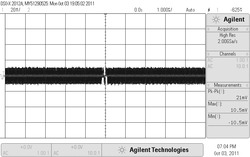

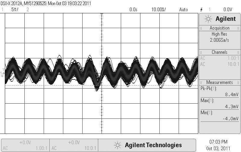

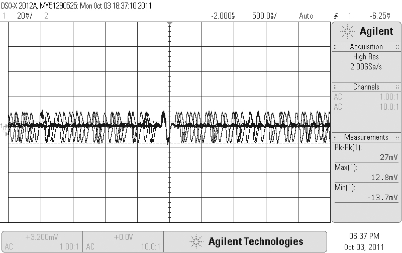

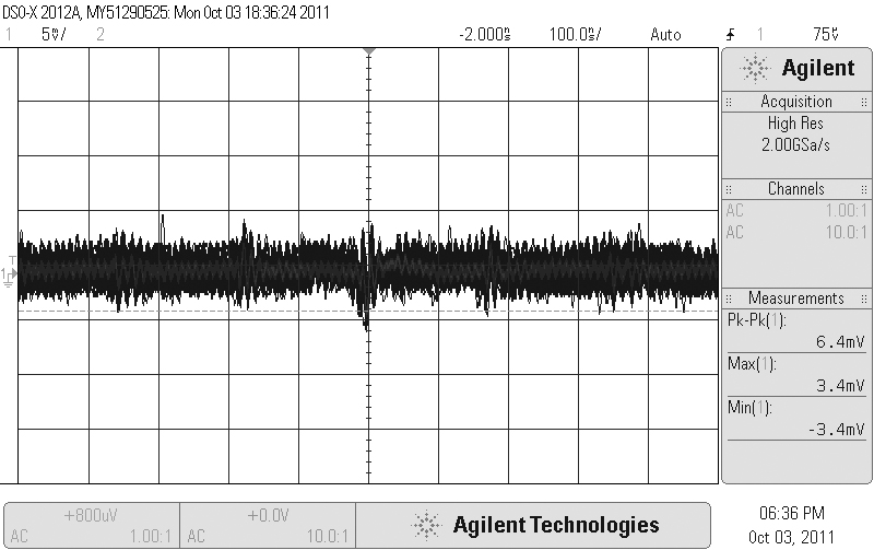

This time I`ve made some measurements in case of an 100Mhz oscillator (a Buffalo one...), and a standard 125Mhz oscillator (20ppm). The pictures are here to. The measure points are: oscillator output/clk input pin of ES9018, the DAC chip analogue output (before I/V stage), on finally output (RCA).
I have to precise here that I have no any filter between I/V stage and final op amp stage. Only an 10pF paralleled on the I/V resistor and 4pF paralleled on final op amp feedback resistor... I found out that the best sound ever is in this no filters set-up. But this is another discussion...
A little bit increasing in output noise by using 125Mhz is evident, but not substantial... On the finally output (RCA), when using 125Mhz the noise level is quite lower then using an 100Mhz Crystek oscillator.
With this occasion I`ve made again listen/comparing tests with this two oscillators. A big improvement still be in place when using 125 Mhz oscillator. Big increasing in dynamics, even deeper and penetrating bass, a very good spatial separation of the sounds, and wider sound stage. I`m very convinced now about the improvement when using 125 Mhz, even though the measurements are not so evident in this respect... I`m waiting now for the 122,88 Mhz oscillator for test with.
Still not finding the best explanation of all this...
