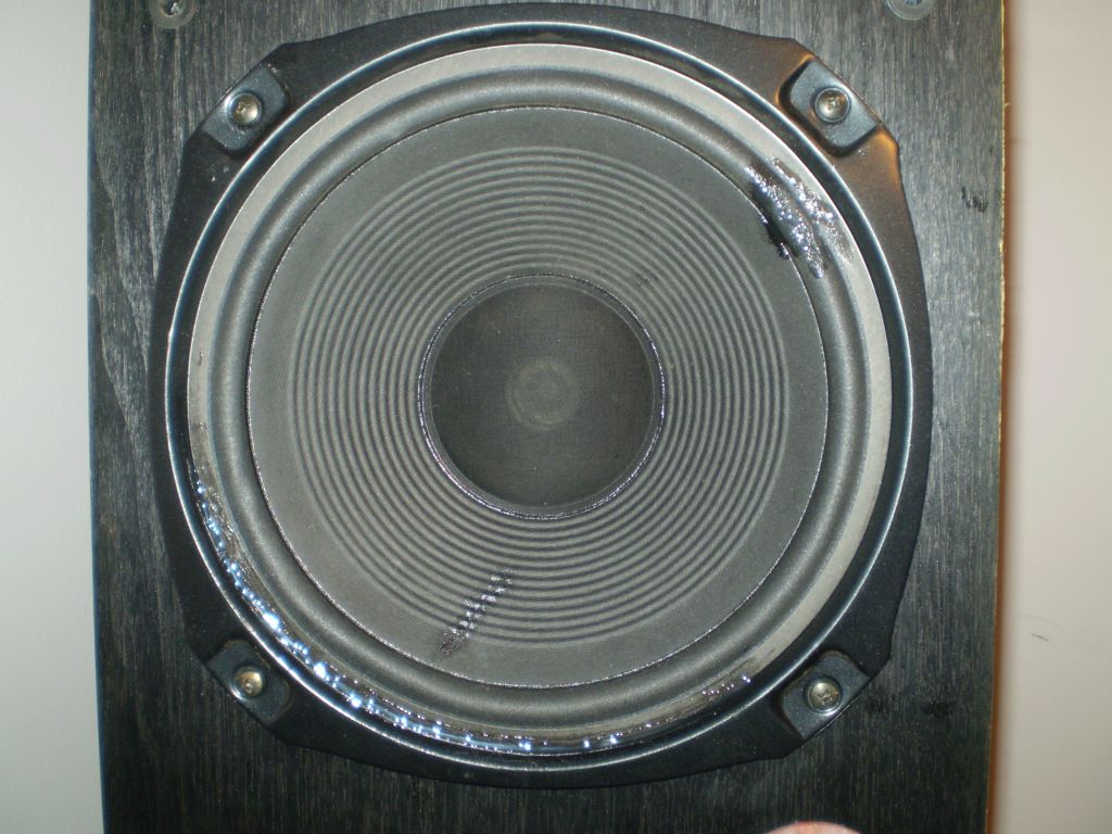

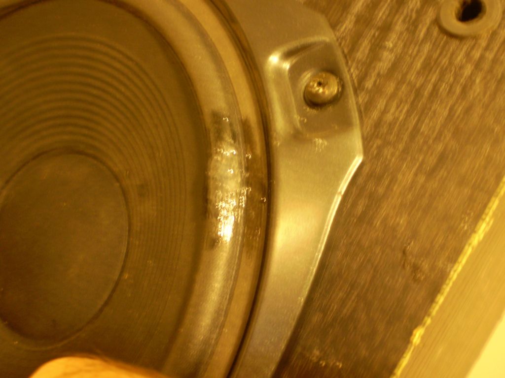

The speakers in question are ESS Classic CS 1 Heil Air Motion Transformer speakers. The problem is the woofers (10") have what looks like Butyl rubber surrounds that appear to have been sliced around the outside edge with a razor knife. About 60% of the perimeter of one and about 33% of the other seems sliced (or torn very neatly.)
I see a few options;
1) Try to repair surrounds.
2) Replace surrounds.
3) Measure speaker parameters, and find the closest match possible.
4) Measure the cabinet and port, freq check the tweeter for high pass, and reverse engineer the best driver possible.
What says the collective wisdom of DIY Audio?

You could try repairing the surround with a Flowable type silicone rubber sealant.
I have done this with good success on a couple of my woofers recently.
I used Part NO. 75009 flowable silicone clear windshield & glass sealer from VersaChem.
This stuff has the consistency of epoxy and I just smoothed it on with my finger and (as well as a toothpick for the tight spots) built it up with a few layers until I got the thickness that I required.
You may be able to apply it with a small paint brush,I couldn't find one at the time I had used it.
I used it on a foam rubber surround and that had lifted from the basket around 30% of the circumference as well as a little hole that eventually turned into a large tear.
It cured very nicley just as the regular stuff would, but was much much easier to work with as it is Flowable.
It is very soft and has not failed yet.
I may have gotten a little to much on it but it works good.

Gerald,
That sounds like a good low cost solution. I might do this, if for no other reason than to get a sense of what the speakers sounded like originally. If I like it and it looks good, I can stop there, or buy a surround kit and repair it "properly."
Thanks for the heads up on "VersaChem 75009 Windshield Sealer."

Well at least you can get them working again with a minimal amount of change of characteristics should you decide to measure them for a suitable replacement.
Also it is a good glue should you choose to go through the procedure of replacing the surrounds as well.
I would mend them with a very thin coat to start with as the stuff was stronger than I expected it to be.
You see I did make it a little thick and it is a bit firm because of this, But this shouldn't be to much of an issue if you are mending a crack along the edge where the flex point is as long as you use it sparingly ( thin coat).
