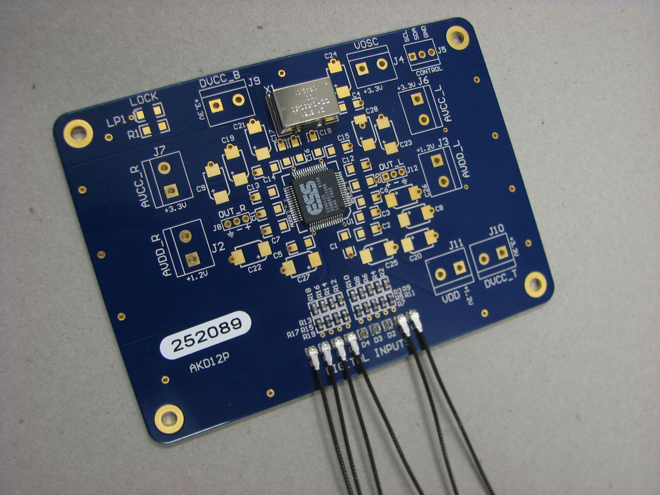

Well, I'm using Buffalo II where the spdif input is wired to DATA1 and LRCK of I2S is also connected to DATA1 (per datasheet) so if spdif and I2S are playing, there will be a conflict.
Since all 8 channels of I2S data only require 4 pins (DATA 2,3,4,5), then if one puts spdif in pins 6,7 or 8 there will not be any conflict. RayCtech's DAC seems to be configure in such way. So if I play I2S and select SPDIF in say pin DATA 8, then in theory pins DATA 1-DATA7 can be ignored
So in short, I can't test my hypothesis in BuffII...

i'll test this out and get back. but again, I am not talking about a conflict with the physical pins, i'm talking about the internal mux not being able to switch i2s off.perhaps when I tested i2s vs spdif last time I did have a physical conflict somehow, i'll try again
I understand. Register 8 allows you to choose between I2S/DSD or SPDIF. I can also turn off AUTO detection of SPDIF in reg 17. Thus (in theory) I can "listen" to the I2S pins or the SPDIF pins. In theory I could also have 3 active SDPif signals and only "listen" to the one I select.

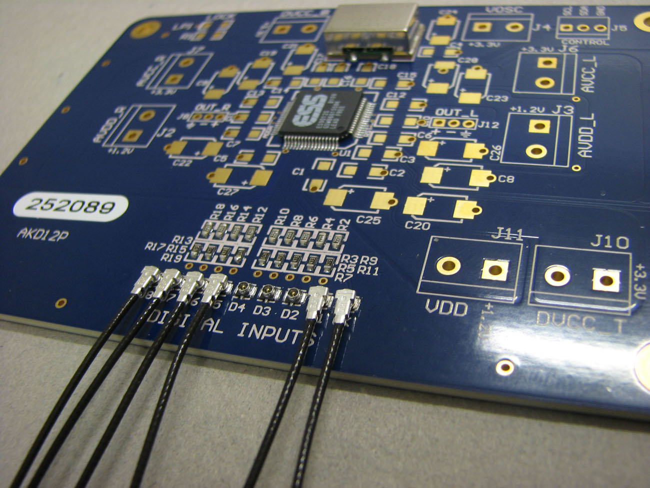

thanks, I have some new toys i'll be building up/populating over the next week or so that will facilitate testing this out easily. I havent set up the terminal connection to the ackodac MCU yet and dont have any arduino shield, so havent had direct access to the registers as such, but will be setting all of that up in the coming weeks (not auduino, the terminal and iphone/ipad control), have been a bit idle with my testing with the sabre of late as have been waiting for this to show up 😎
got here Xmas eve, so all the things i've been planning to do I can do without thinking I would be redoing them all over. need to test out the iphone/ipad software too, not sure how far along they are with the apps. already posted this over in the D1 thread, but thought it might be of interest here and I think its pretty 😀 we'll see if PTFE provides any audible benefits; also from these hirose mini BNC headers for the 2s signal integrity, i'm sure there will be some measurable with the XO paths in particular. TBH I dont care if it sounds the same as the standard ackodac, which was already excellent, the subjective/psychological benefits are bound to be huge 🙄
BTW the cables are not hooked up to anything, so connections are meaningless, was just taken for my mate

There is a very good reason for the way the Buf II inputs are configured. It allows you to do stereo SPDIF/DSD/and I2S without having to reconfigure anything at all (except the SPDIF switch if it is not TTL) , not even firmware.
We could have skipped easy DSD support, but since we already have a great MUX there was really no need. Also I am glad we did not because the DAC does wonderfully with DSD input. 🙂
SPDIF multiplexing is still really simple with the BUF II, it is just external in our case. This is likely the best solution in any case since then you only need one comparator for SPDIF, and not one for each input. This cuts out a lot of unnecessary (for most) stuff and adds isolation between both the source and the MUX. Since we have the "MUX" there was no good reason to multiplex at the DAC itself.

Is there an easy way to tap into Data 6, 7 or 8 (via or resistor), thus providing a separate spdif line in.
They 7 and 8 are connected to GND. So you would have to lift those pins. 6 is connected to D2.

Buffalo II is simply not intended for that application.
Here is how the input are connected.
DCK = DATA_Clock
D1 = Data1 and Data5
D2 = Data2, Data4, and Data6
Data3, Data7, and Data8 are connected to GND
Now with this information and the datasheet all your questions will be answered. 🙂
