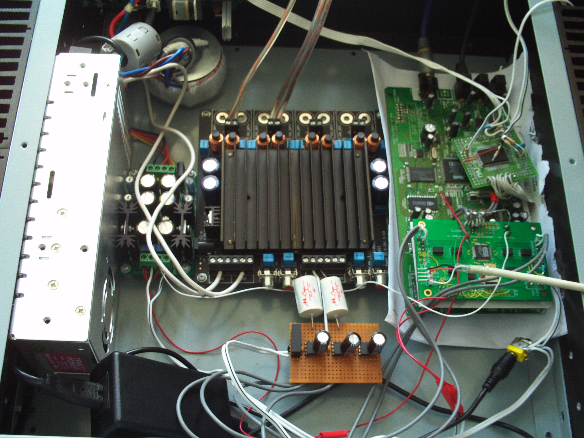

Hi, all,
Here's another of my famously long posts, but I've tried all sorts of things to fix this final issue I'm having...
I'm STILL messing with my amp build - it has been sitting on the shelf for the past seven months but I really want to finish it now.
I bought a small prototyping adapter so I can now fit the CPU chip (from a Denon 1905) next to the Denon DSP board into my amp chassis.
For a bit of background info - my previous ramblings and a close-up photo of the DSP board + Sabre DAC are here...
http://www.diyaudio.com/forums/digi...-reference-dac-8-channel-144.html#post2007575
I've attached another photo of the current layout of the amp.
I'm now testing some THAT1200 opamps as an output stage for the Sabre (2 channel only atm). They appear to work great, and provide very good ground isolation which stops all the "ground loop" type noise I was getting before.
The THAT1200 outputs go through some 1uF M-Caps and then directly into the Sure amp module.
Firstly, the good news is that I've now confirmed that the cause of the digital noise when the Sabre first locked onto a signal was indeed caused by the default "low" DPLL bandwidth value of the Sabre. When I set it to medium bandwidth (via I2C using a buspirate), the noise disappears completely!
The problem I'm having now is that the Sabre locks onto the I2S audio from the DSP perfectly fine when using an optical input from a DVD player, but...
...If I use the optical output from the PC (tried two different sound cards), the Sabre locks on and plays audio for three seconds, then it looses lock for one second and the process repeats?
The sound cards work perfectly through optical to a commercial amp (even through a very cheap 5 metre optical cable). I tried three different cables with the Sabre DAC and I still have this "lock" problem?
The decoded I2S signals from the DSP board look identical on the scope whether I'm using the DVD player optical output (audio fine), or PC optical output (audio intermittent)?
Of course, on my amp build, the Denon DSP is responsible for decoding SPDIF and converting to I2S for the Sabre, so it's probably the way I have it all connected (as usual 😱 )...

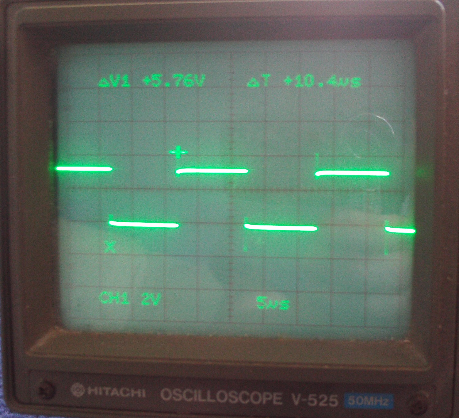

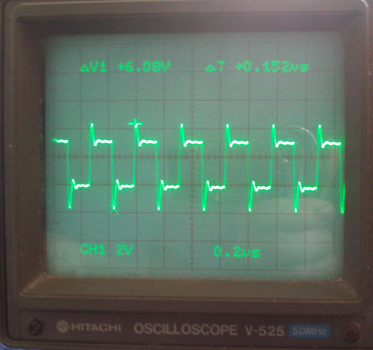

The I2S signals from the DSP board are at 3.3v levels, but I'm getting a huge amount of overshoot? Is this likely due to incorrect impedance matching, or the use of a "1X" scope probe?
I've attached o'scope shots of the I2S bitclock and wordclock going into the Sabre board (please note the different time / division).
You can see that the overshoot is pretty huge. The flat peaks are at 0v and 3.3v (0V at same position when scope input set to "GND"), so the overshoot actually goes BELOW 0v and ABOVE 3.3v?
Apart from the overshoot, the I2S signals stay solid at ALL times even when the Sabre looses lock? Assuming the overshoot is not an artifact of the scope impedance, could it be the cause the Sabre loosing lock?
The CPU / DSP / Sabre ground is now isolated from the Sure amp / Tracopower SMPS / mains ground. I do appear to have around 130mV of noise on the CPU / DSP / Sabre ground though (around 295KHz, so very likely to be SMPS switching noise).
It's important to know that the I2S signals pass through some buffer chips and series resistors on the DSP board before they reach the Sabre.
The Sabre PCB also has a 47K pull-down resistor on each digital input line, and then has a 22 ohm series resistor between each input and the ESS chip.
The buffer chips on the DSP board are all powered from 3.3V. So, the signals follow this path...
(Note: Bit clock and Word clock generated by Sanyo LC89057 SPDIF receiver. So, clocks recovered from SPDIF PLL.)
LC89057 -> 47ohm -> 74LCX244 -> 47ohm -> (47K pull-down) -> 22ohm -> Sabre chip.
(I2S audio data generated by SHARC DSP. SHARC is also clocked by the Sanyo SPDIF receiver.)
SHARC -> 74LVX157 mux -> Sabre chip.
Note: The CPU uses the mux chip to "mute" the I2S audio signal (tie output to ground) when it detects a decoding error. The mux is not activated while the Sabre looses lock, so it's basically just a buffer.
Should I bypass some of the series resistors on the Bit clock and Word clock to try to reduce the apparent overshoot?
EDIT: The overshoot on the actual I2S audio signal is only around 0.48v above / below the flat peaks (ie. around 4.26v between lowest and highest overshoot).
Thanks in advance,
OzOnE (Ash). 😎

The bitclock scope trace isnt very good. You'd better measure it with your probe in 10x, measure it the closest to the DAC pins, not the other side, this is where it matters. Sounds like an impedance mismatch, it oscillates quite a lot. Repost the new shots.
The wordclock, though not the best, doesn't seem to oscillate, so ok there is little overshoot so there is some impedance mismatch (hey... wires are soldered/plugged in it after all).
Also, try simply unplugging the bitclock, afair the Sabre can lock without it (not sure about it).
The problem you describe is strange, would frequencies not match it would not lock at all, sounds like a jitter problem, but why? Ok some jitter probably can pass the spdif decoder, but to this point? Tried connecting directly the optical receivers' output to the sabre in spdif mode (crappy, but worked)?

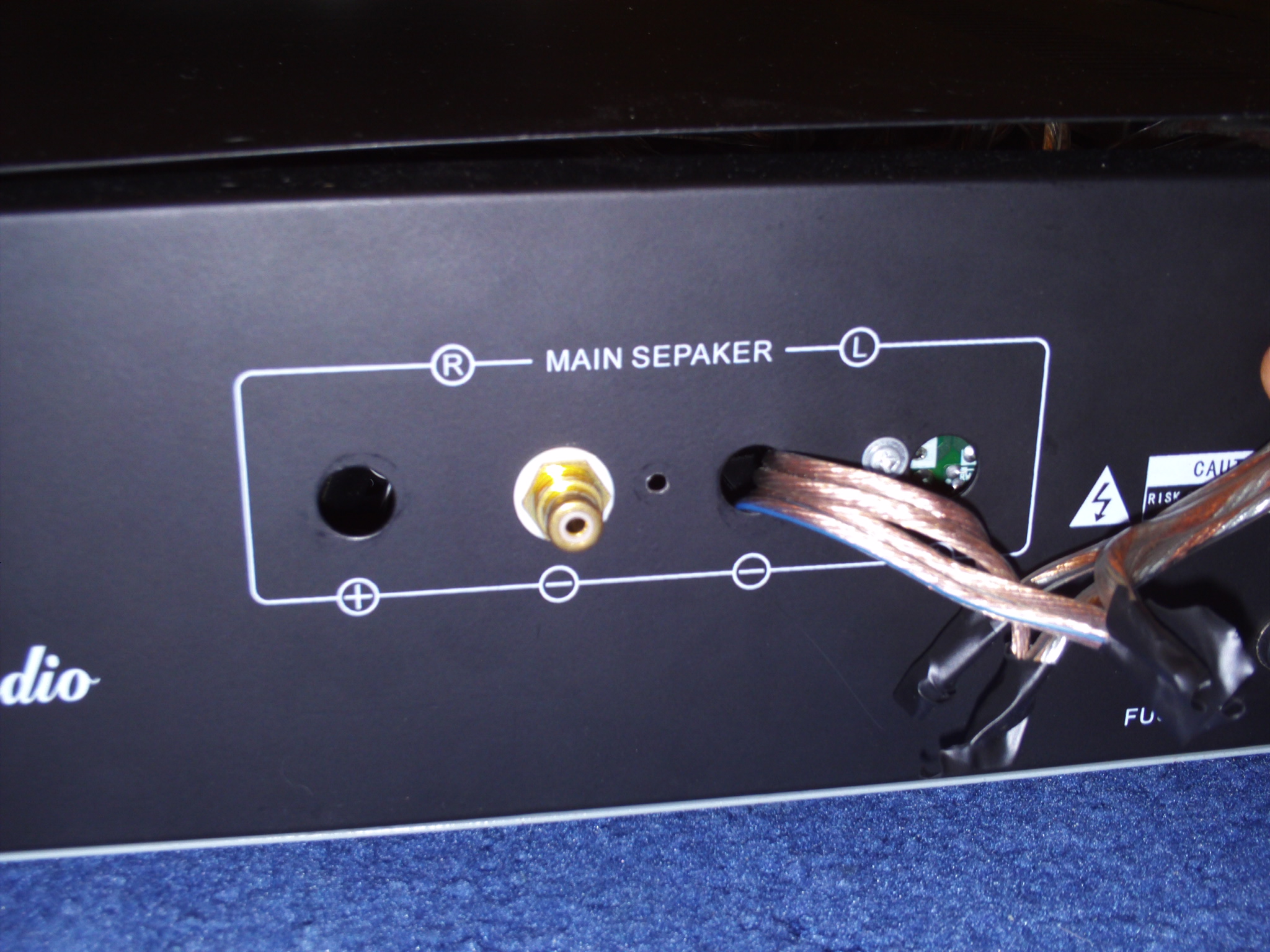

@Adrculda - btw, I was just checking out your ThermalTrack build thread and noticed that you'd bought a similar case to mine (although mine is single-unit sized)...
I thought that the attached photo might be somewhat amusing.
I haven't decided where to put my "Sepaker" binding posts yet. 😀
Also note my highly advanced method for connecting the speaker wires during test. 😱 Don't laugh, those black strips (which look like electrical tape) are in fact carbon nanotube wraps. They also contain a mixture of Ritz Sidecar and snake oil.
OzOnE.

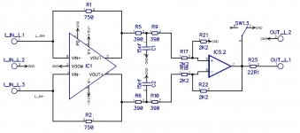

btw, does anyone know of a cheap I/V stage suitable for the Sabre chip? Would something like a modified IVY III type circuit work OK (if only single-ended outputs were needed)?...
This would save a fair bit in the cost as I would then only need eight OPA1632's and four LME49720's.
OzOnE.
P.S. I hope it's OK to post this circuit on here? Please let me know if not, and I'll remove it.
Note: it is NOT the original IVY III schematic!! It probably won't even work properly without some resistor changes etc.

Yep, that's where I got it from, but the schematic I posted was modified by me (doesn't include the second OPA1632 gain stage / differential outputs).
I didn't want anyone to use this schematic and get it mixed up with the proper IVY III schematic (especially since it's unlikely the schematic I posted will even work properly as-is).
If anyone would be kind enough to make and sell some PCBs / kits for a similar circuit which does I/V + filtering + single-ended conversion for multi-channel Sabre setups, I'm sure there would be a few people who would buy a kit.
