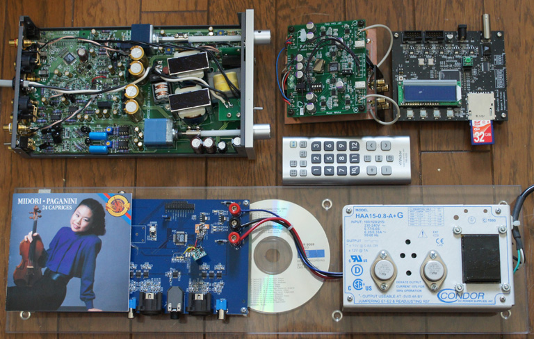

This evening I preliminary connected NDK OCXO to Twisted Pear Audio Buffalo II+IVY III.Anyway, we will try it.
Based on Dustin's valuable advice, I adopted the easiest way.
As the output voltage range of OCXO is +-1.6V, I just concentrated on giving a necessary bias. I employed a simple UM-1 1.5 V battery for this purpose. At the same time, I also used a bunch of UM-1 batteries as +12V, -12V power supply for the OCXO.
Fortunately, the Buffalo II with standard MCU runs without any signal level tuning of the clock.
The result is marvelous! I have never listened to such a smooth and clear digital sound before. Absolutely no harshness. It is effective on both 44.1 kHz / 16 bit and 352.8 kHz / 24 bit sources. My transport is Chiaki's SDTrans192 upgraded with NDK low phase noise oscillators and RayCTech's JFET-based voltage regulators. On this condition, DXD ( 352.8 kHz/ 24 bit PCM WAV) files can be played without any noises on Buffalo II.

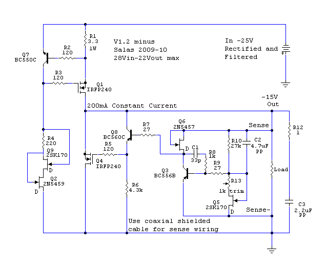

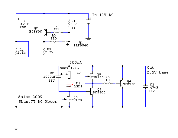

Have you tried Salas Simplistic Shunt Low Voltage regulators?
3.3V
5V
15V example schematics. There is a trimmer for choosing Vout, make that 5k. Use 12V raw DC to feed the reg. Don't adjust less than 5V output. You can use 22uF medium esr output electrolytic capacitor in place of 2.2film + 1R output Zobel network (22uf substituting for both Zobel elements), for better general stability with unknown loads if you don't have means to check oscillations thoroughly.
Thread link: http://www.diyaudio.com/forums/powe...listic-salas-low-voltage-shunt-regulator.html

Yesterday, I had a chance to listen to sounds of a brand new ES 9018 based DAC made by a Japanese audio vendor, Fidelix. Its type name is "CAPRICE".
The DAC has an I/V stage using a discrete JFET circuit and its sounds were very excellent. I realized an I/V stage design and implementation gave more influence on sounds than a clock source quality for ES 9018.
The Fidelix CAPRICE DAC has both preamplifier, head-phone amplifier functionality and an I2S input interface option based on LVDS standard with a HDMI connector. Clock frequency for ES 9018 is 96 MHz.
I could play 352.8 kHz/ 24 bit DXD files without noises connecting SDTrans192 via I2S on LVDS/HDMI connectors.
