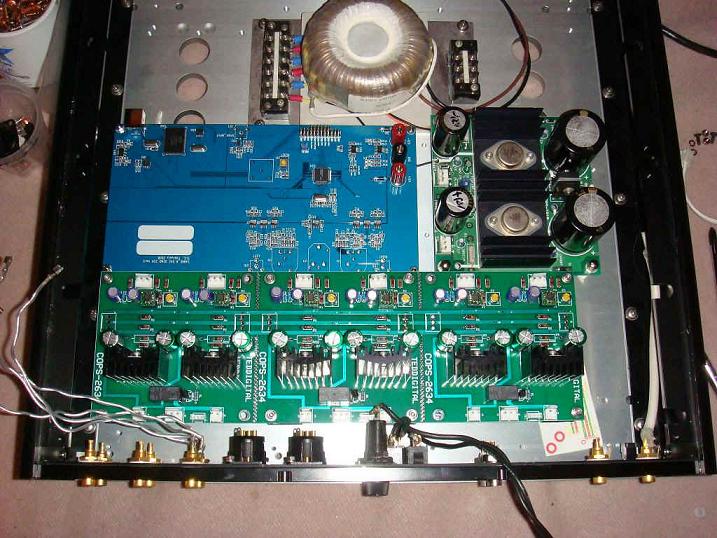

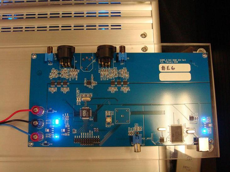

This is ES9008 EVA-Board.
We compair with ES9008S(I/V=AD797) and ES9018(I/V=AD797).
They are big difference sound, ES9018 is very smooth and low distortion.

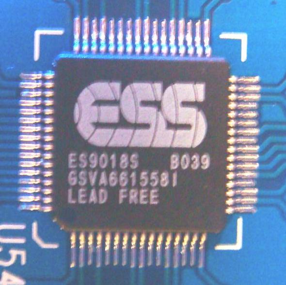

ES9018 Digital Filter
64-bit accumulator/32-bit internal data word length
NPC SM5847 Digital Filter
32-bit accumulator/25-bit internal data word length

FuriousD said:Thanks for the Master Clock confirmation.
Additionally....
On the SPDIF input of the demo board, there is a note on the applications note on the ESS website stating that the SPDIF input has a 75 OHM in series with the input and that this shows an incorrect input impedance to the SPDIF input.
However, it does not specify how this should be remedied. Any ideas anyone, as I have a demo board ready to go and would like to get it setup correctly before I start.
cheers
D.
Hi Furious,
Yes this was a total goofup on my part on rev1 of the boards. This has been changed over a year ago. The 75 ohm should go to ground instead of in series. I cant beleive what I was thinking. Obviously I was not.
Dustin

power supply units
Hello georgehifi,
When I heared ES9018, ES9008 and mod'ES9008 board,these power supply units are attached by ESS eva-board one.
ES9018 eva-board's and silver chassis's psu is same one.
This is very low ripple noise and good voltage stability than my LM350/LM333 regulator with super ring troidal core transformer.
I made black chassis ES9008S unit with this troidal transformer, but I must make new regulator pcb.
