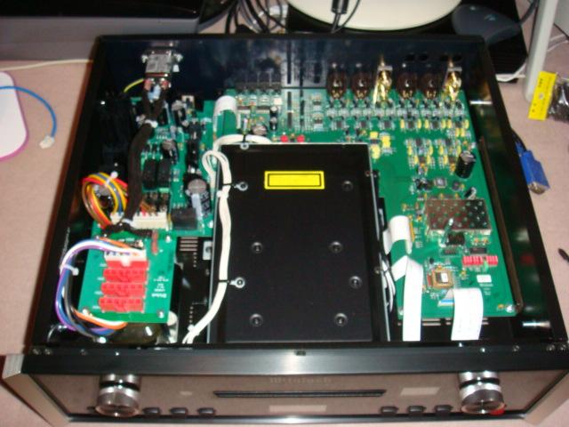

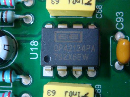

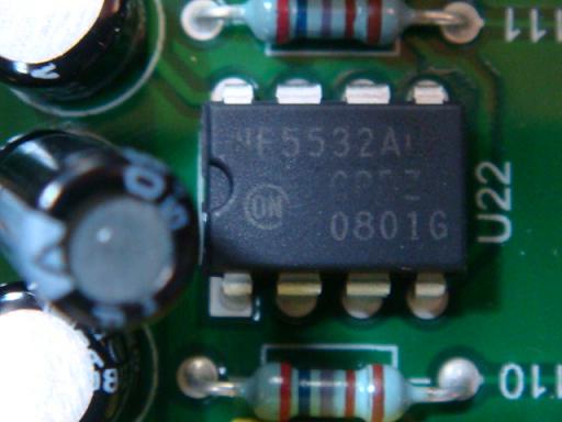

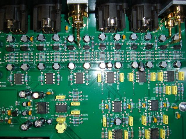

In its February issue, the german Audio magazine Stereoplay presents a review of the new McIntosh MCD 500 player, which is probably the first commercially available player with the ESS 9008 Sabre chip. It plays almost everything, CD, SACD, WMA, MP3. Digital inputs allow external sources to utilize the quality of the Sabre chip. The price of the player is said to be 8000 Euro.
The review sais that McIntosh uses an OPA2134 after the DAC, followed by some NE5532 as line output drivers for both balanced and unbalanced outputs. Interesting, that they measured 612 ps of jitter. I don't know how they really measure jitter, but they seem do this on all players they test, so figures are probably comparable among different players. However, irrespective of this, they judged the sound as excellent, with stunning resolution and clarity, about comparable in quality to the (also top rated) Ayre C5 XE. They recommend to use the balanced output, as they found the sonics to be superior over the unbalanced RCA.

interesting .. that 5532 balacing stage might be very common in recording though anyway. But that jitter figure, pleaazeeeee 😀😀

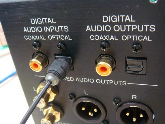

Why McIntosh use CS8416?
McIntosh MCD500 has 192kHz24bit digital input RCA terminal.
I checked this Digital Interface Reciever IC, it was CS8416.
I wonder why McIntosh uses CS8416 conventional PLL DIR-IC, because ES9008S has very nice non PLL / Time stump based DIR circuit.
Do you know who it is?
