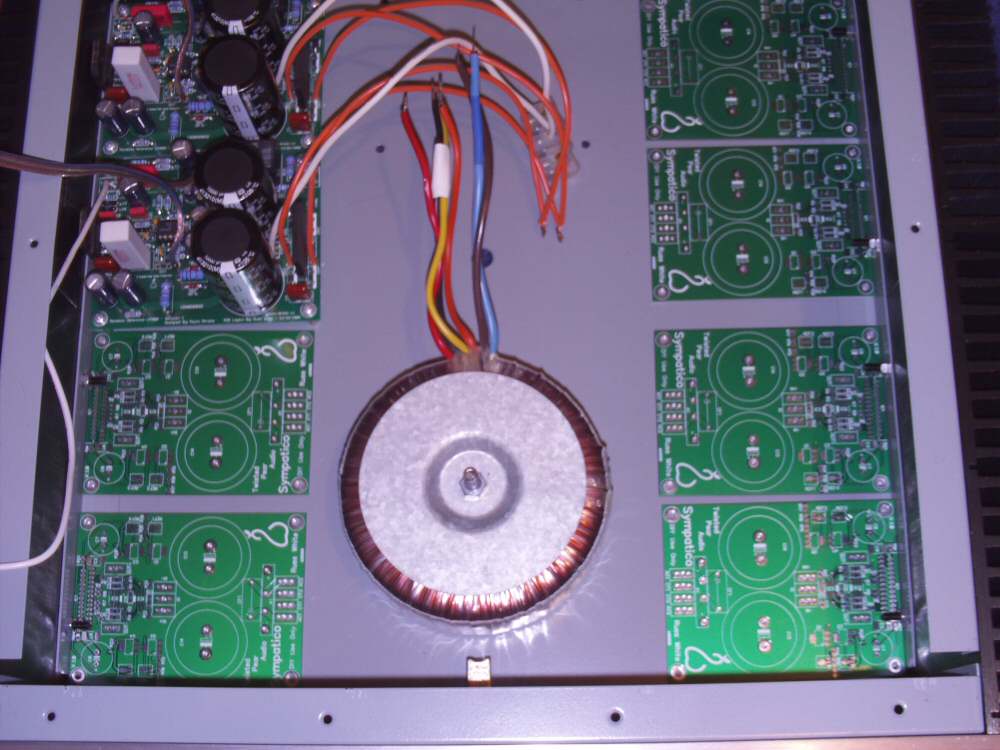

Ok, so I finally got my amp chassis (after many months of waiting for it to arrive from Hong Kong), I also have a Sabre IC, and seven Sympatico PCBs !!....
What I'm looking to do next is to design a PCB for the Sabre chip. But, as I want to do full 7.1 surround, I was wondering if it would be possible to use multiplexors on the Sabre DAC outputs so that you could switch between "8 channel" mode or "2 channel" mode.
The mux chips would simply combine the four DAC outputs (per side) for "Stereo Quad" output in 2-channel mode.
This would give the best DNR etc. for stereo music, while leaving the option for full surround output (giving the best of both Worlds). This also saves the cost of three or four Sabre chips for people who want to do full surround on a tight budget (like me :bawling: )
The question is, would the use of mux chips on the outputs do any harm to the DNR etc? (which would null the benefits of combining the outputs for 2-channel mode in the first place)?
I'm basically looking for any endorsement of this idea so I can go ahead and design a PCB. A candidate for the mux chip would be something like TI's MPC507A....

I've attached a photo of my amp (with the boards laid out) to give some "inspiration". Just so you know I'm serious! 😉
My RevC amps are also sitting in there just for reference.

Hi OzOnE,
Nice work!
I would probably not use an analog MUX myself as they tend to impart more distortion and noise than I would like. What I would probably do is use a good quality relay. Something like a G6K.
Even better in my mind would just be to use 4 sabre chips and run them all quad stereo, and then simply rout your digital signals appropriately.

The mux chips have too much on resistance to directly combine the outputs of the Sabre.
If you used seperate op-amp I/V conversion on all 8 outputs that would give you the 7.1 you want.
Then another pair of op-amps to sum each of 4 to combine them to stereo outputs and giving you 10 total outputs from your PCB. That may be workable. Without using 4 Sabre chips 😀
I wouldn't use the mux chip for the summing of I/V conversion circuits either, the on resistance of the mux inputs is probably not matched well enough.
