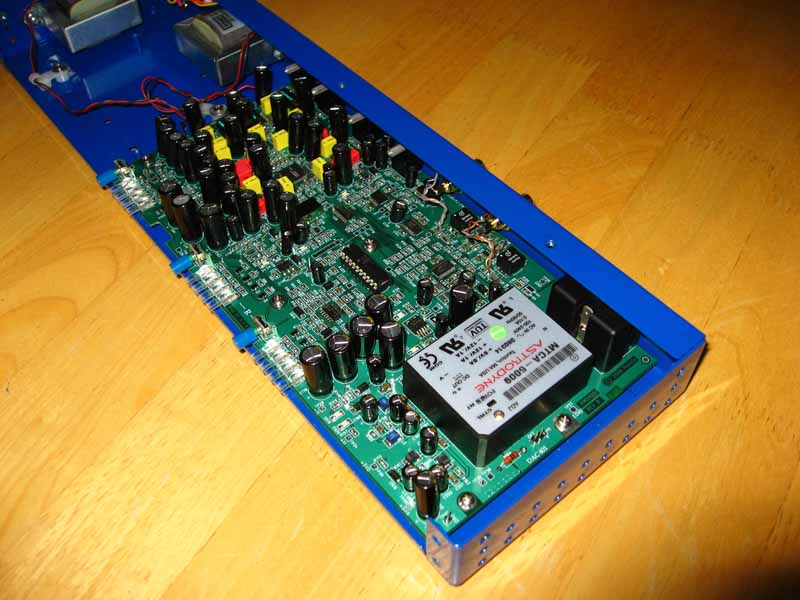

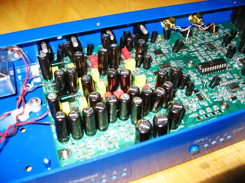

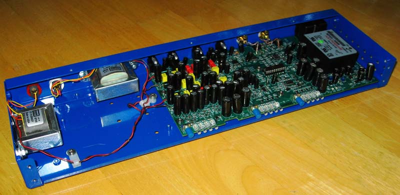

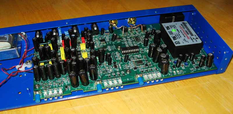

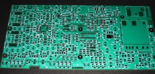

Sabre8 prototype DAC
My Sabre8 prototype is turned on and making music.

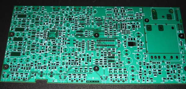

The circuit board. It is a 4-layer boards. There was a few problems with the first one so this one is revision B. I was able to tweak the first one to get excellent sound and I made those changes in this version.
Layer2 is a solid ground plane. All digital traces are impedance controlled. The analog section has an AVCC plane and planes for the +/- analog supplies. Digital side has plane for 3V3.

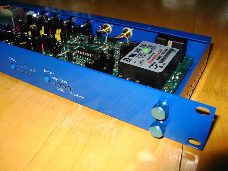

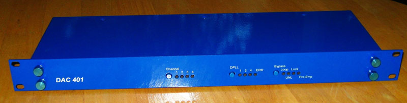

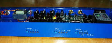

The DAC features a 4-input switch and a processor loop. The processor loop allows the switched signal to be sent out to a DSP equalizer and then returned to the Sabre8.
After the input switch the switched signal is sent out a TOSLINK port and also goes to a mux. A front panel switch controls the mux and selects either the switch output or the processor loop input.
