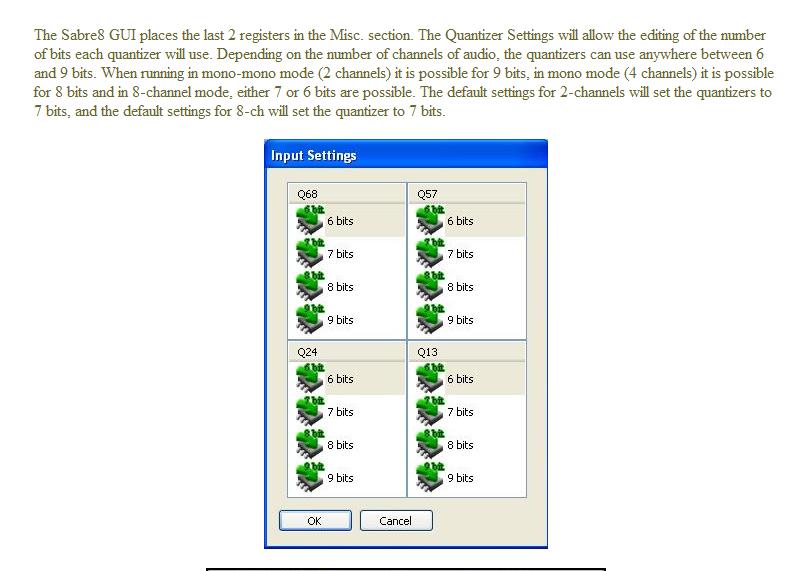

ESS Sabre GUI incomplete
Hi Dusfor99 (or whoever can help me),
i need you help for a problem with ESS Sabre GUI.
I'm owner of an ESS Sabre EVB. I have a problem with some
registers setting through the most recent release 2.0.2.1. (but the problem there is also with the previous version) of Sabre8 GUI (2.0.2.1.): I was not able to find in any section of the GUI the window called "Input Settings (Quantizer Setting)" where to editing the number of bits each quantizer will use. While setting in stereo mode the DAC (2 Channel) i cannot set the value of the quantizer. Through the "List all register" button I see the Register 15 setting to 00000000 (6 bits quantizer), but i cannot find the "Quantizer Settings (Input)" Window where to modify the value to 7, 8 or 9 Bits. I attach the screen capture taken from the Sabre8 Gui Help file show the windows that I cannot find.
Oherwise could you sugest another way to modify those values?
Also I don't find where to midify the "differential" from "True" to "Pseudo". I use the EVB with I2S input.
Sabre firmware is updated to the latest version available in
http://www.esstech.com/techsupp/drivers.shtm#sabre.
Thank you.
