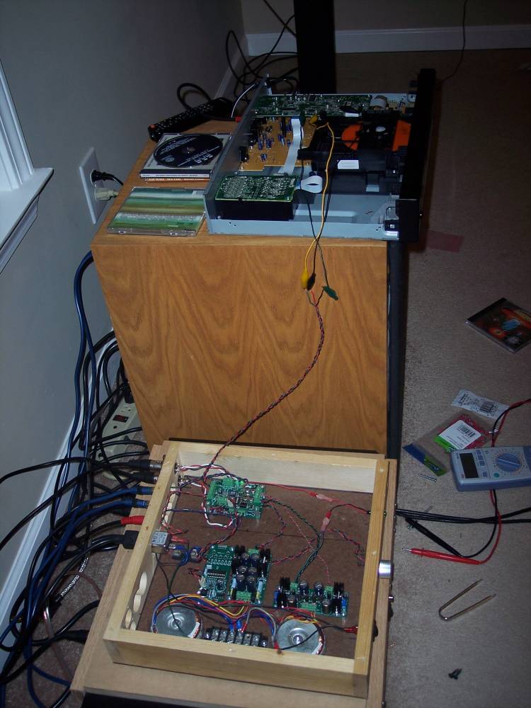

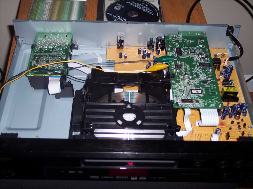

Denon DVD-1920 DSD MOD
OK for those of you who don't mind risking a Denon DVD-1920 and want to get DSD out of it...
Here is how I am doing it:

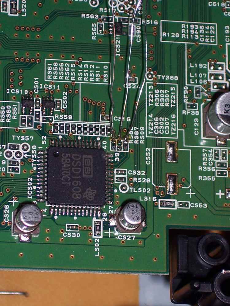

There are three vias at DBK,DSD1,DSD2. Solder a tiny wire into each via.
I am not sure how I will run these to the panel, but for now just to test the DAC I just used allegator clip jumpers to wires which are installed in the DAC.
It actually sounds very good despite the makeshift wiring! It is definitely much better than the stock DAC, but that would not actually take much. 🙂
The DVD-1920 is much easier to modify than the DVD2910, so I would go that route personally.
Cheers!
Russ
Here is a picture of the wires soldered into the whiskers.
Great posts Russ, just what I was looking for 🙂 I think i remember reading somehwre in the thread that you tried DVD-Audio out as well. Where did you tap that?
Edit:
Would pin 46,47 and 50 get me PCM output and could I run that to TP SPDIF module?

Hello,
I have not tested PCM to SPDIF on this player yet, but it looks like you will want to take the PCM signal from:
PLRCK (51) - Left/Right clock
PBCK (50) - Bit Clock
PDATA1 (46) - PCM DATA for channels 1 and 2 (Usually front left and right).
I am not sure the format yet, I will let you know when I try it.
