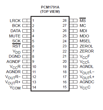

Hi Russ,
Interesting with the information on how to get DSD data from a player using the PCM1791 D/A.
I checked the data sheet for the 1791 and pin 1 is LRCK, pin 3 is DATA and pin 5 is SCK (dash below). Just to make sure - are those the pins to be used?
Jesper
Hi Russ,
Jesper
Re: DVD-2910 mod
As you can see here Russ has said which pins to use. Dustin also mentioned it earlier in the thread. Unless Russ's suggestions were incorrect 🙂 But just pointing out.
Russ White said:Since I have received a few emails asking how its done here is how you get DSD from any SACD player which uses the PCM1791 like the Denon DVD-2910.
Pin 1 is DATA R
Pin 3 is DATA L
Pin 5 is the bit clock.
Then you just need GND.
Cheers!
Russ
