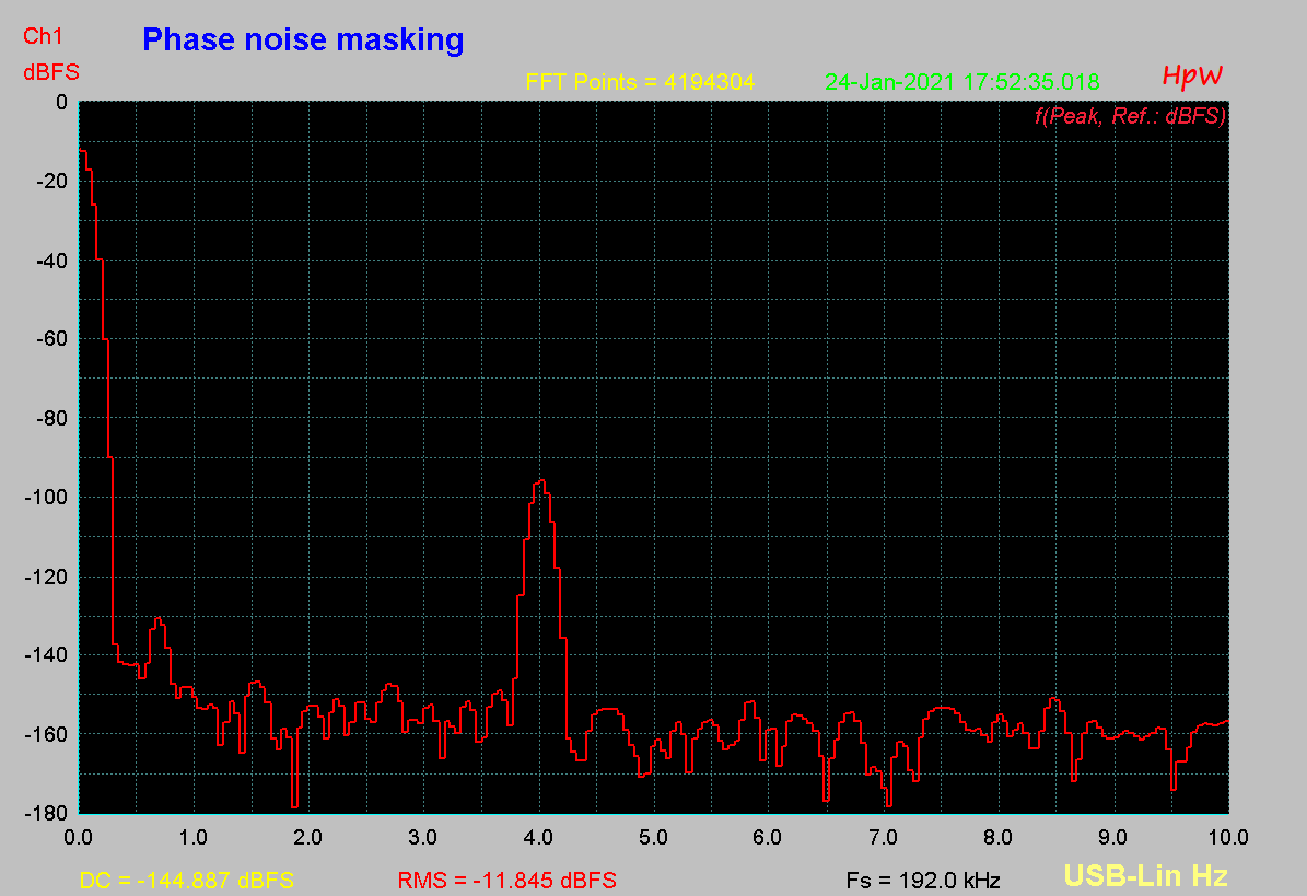

Waited to long to edit the last post... My own interest relates primarily to clock phase noise in DACs. For ADCs then phase noise of an analog signal generator could be a complicating factor.
Attached, using Lynx L22 loop back 1000.0Hz -12dBFS, 1004Hz -96dBFS, BH7 FFT Window, 4M Samples, SR 192kHz
IMHO things could be complicated:
. 1. Instrument plays 1. Har at 1500Hz
. 2. Instrument plays 501Hz, so 3. harmonic would be a 1503Hz
so masking would be really possible if the tone of both instruments changes over time (as they will) and gets within the phase noise 😱

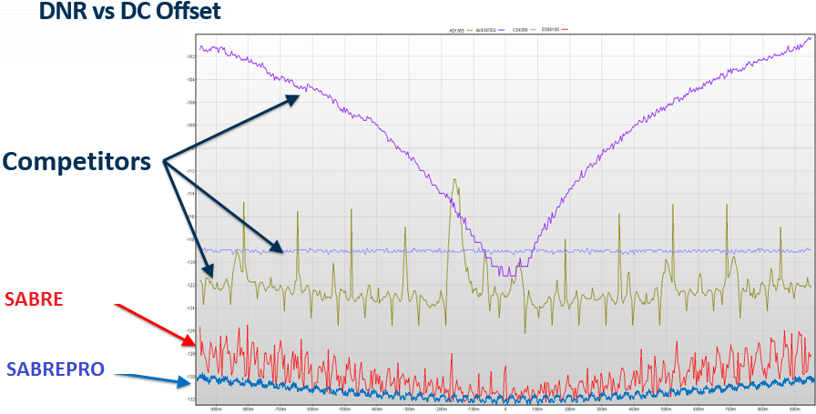

I have seen some DNR graphs dependent of various ESS competitor given from Martin Mallinson ESS.. and currently have no glue how they made this graphs...
Look at given pictures and orange rectangle...

These are interesting data. They measure AC noise at different DC level. The noise level at higher DC level generally increases due to voltage reference noise. The peaks at particular values are switching noise, I would think they are primarily present in R-2R type DACs.
I am curious if anyone made noise spectrum measurements (not just total DNR) at different DC levels. It can help identify the noise spectrum of the voltage reference. For example, different bypass capacitors would lead to different spectrum.
Noise levels changing with dac DC output level in sigma-delta dacs tend to be caused by the modulator that frequency shapes switching noise so it is mostly outside of the audio band. Spurs seen in such testing are likely another issue from the modulator called idle tones.

Thanks for posting an interesting reference. My understanding is that in latest DACs these digital modulation issues have been mostly solved, hence SABREPRO shows fairly flat shape as a function of DC. But the analog issues, like the stability of the voltage references, is still up to the designer.
Its not only the stability and noise of the reference, its how it sounds when its other characteristics are more or less imprinted upon the dac analog outputs. Output impedance verses frequency verses current draw, phase response, nonlinearity, layout, output capacitor characteristics (if the design uses one), etc.
