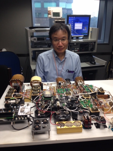

Thank you very much for your reply. My friend, Chiaki released one first prototype board and three second prototype boards. All these prototype were exclusively distributed to users of his previous ES9018S Dual Mono DAC board for an initial evaluation purpose. No further release plan has been announced yet. The reasons why he has no plan so far is that he can't expect so much prospective users;
1. Some DIYers in Japan are releasing their variety of ES9038PRO DAC board kits.
2. Chiaki's ES9038PRO Dual Mono DAC second prototype board costed more than 1,000 USD/piece.
3. A great effort is required to get a full advantage in sound quality of his board. For example, Bunpei prepared totally 10 separate power supply lines for the DAC board, for his transport SDTrans384 and for DuCULoN OCXO.
(Please look at the picture attached to this post.)
If you are very eager to get an ES9018PRO Dual Mono DAC board, please post your comment here.

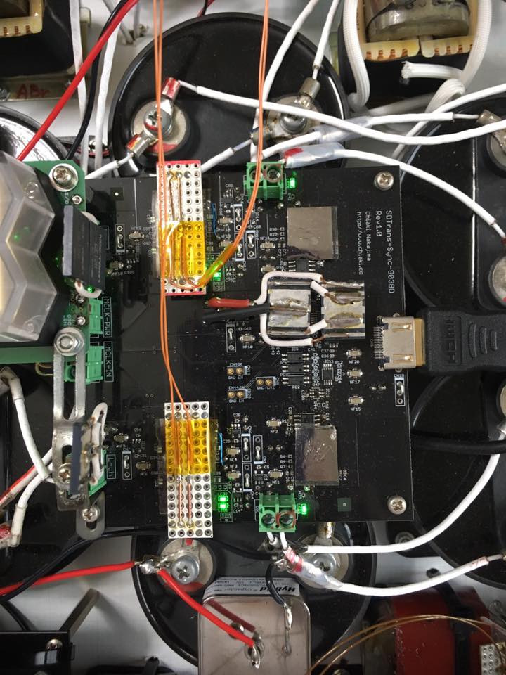

Some DIYers for ES9038PRO based DAC boards may have difficulties in designing of an I/V stage as ES9038PRO provides more analog current per channel than ES9018S does.
For example, a Japanese designer created such a I/V module for his "Monster" ES9038PRO Quad DAC board.
CrossOver >> pg16
In my case, an alternative simple approach was tried for analog outputs of Chiaki's ES9038PRO Dual Mono DAC.
As a left analog output, all eight channels of DAC chip for left are merged, and as a right analog output, all eight channels for right, respective for + and -. ( as shown in the first picture attached.)

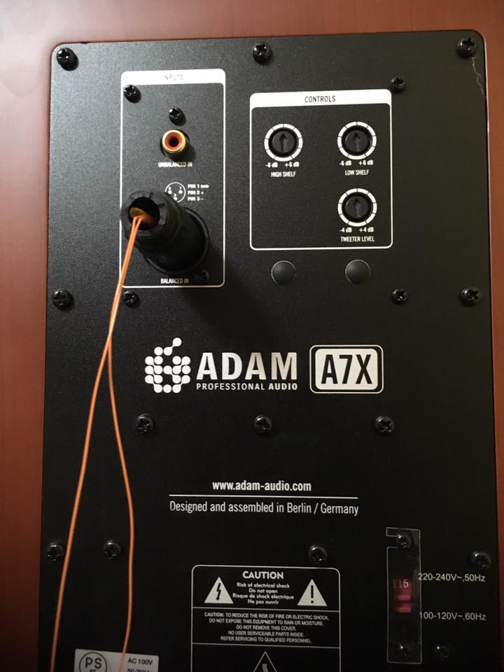

These lines for analog+, analog- are directly connected to a balance input XLR connector of an active studio monitor speaker. Here, no GND connection is applied.( as shown in the first picture attached.)
The resultant SQ is satisfactory!

Thanks for the report, Bunpei. The input impedance of the A7X is listed at 30K ohms. Have you tried more demanding inputs, or perhaps headphones? Sound quality while driving more demanding gear?
Cheers!
Hi, francolargo! I appreciated your reply!
Yes. When necessary, I usually monitor the raw analog output of ESS DAC chip connecting Etymotic Research ER-4S (original in-line resistors were removed and connected in a balance topology).
In this case, I can listen to a crude sound of delta-sigma modulation.
