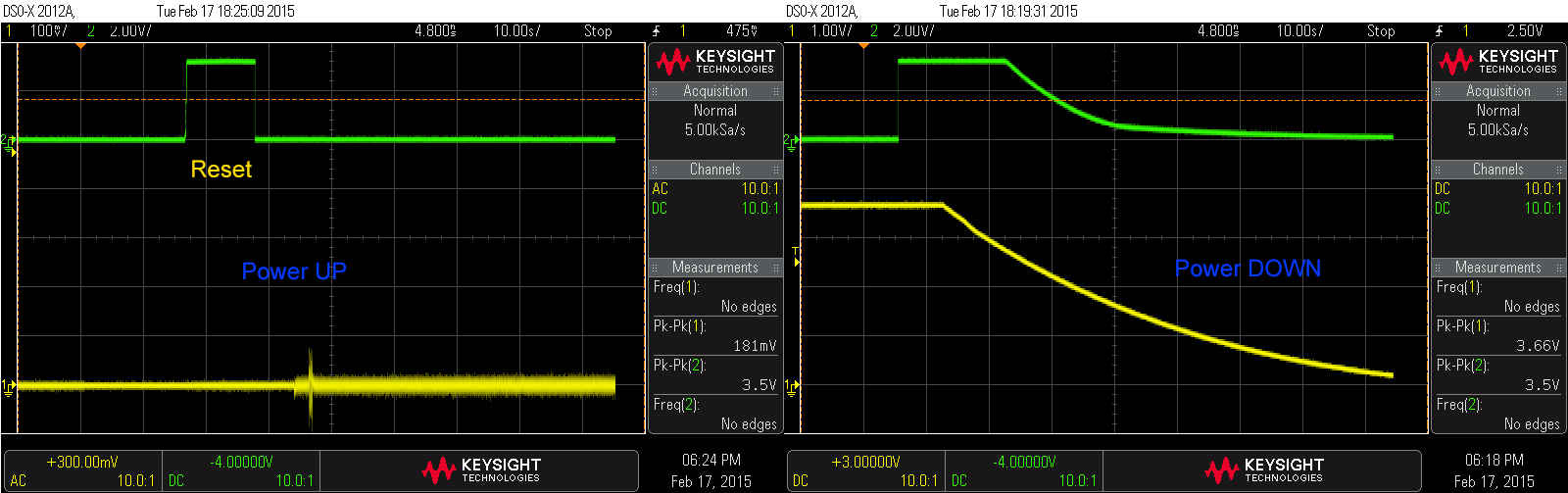

Any idea about details on how it may works RESET (global) for ES9018?
It may be active on zero. Any confirmation?
May be a hardware reset on the chip pin be readable on I2C lines, so to permit to the rest of a eventual system this DAC may be part of, to understand the need to reprogram (firmware) the chip registry?
You can confirm your idea by looking at the circuit connected to the RESET pin shown on a schematic of ES9008 evaluation board.It may be active on zero. Any confirmation?
http://www.esstech.com/PDF/Sabre_8_2Channel_64PIN_V3_SCH.pdf
I assume you had checked a datasheet before you posted this question.
As you may know, there is no documented register that holds any reset history.
The signal, RESET, is an one-shot pulse which is essentially required at a boot phase. Even if the pin is kept low for a long period, you can't read out this state. The chip is down at the period.
No programmer of firmware that controls the DAC chip in his commercial product assumes someone like you might make the RESET pin low.
