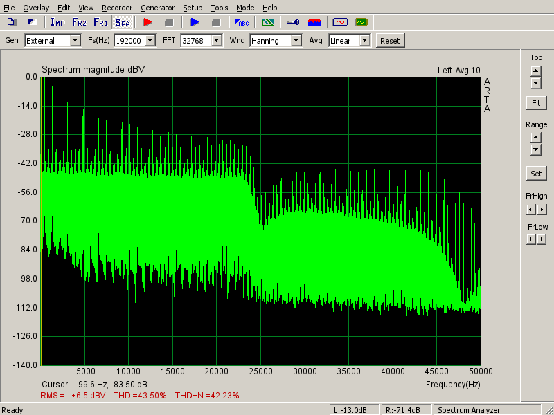

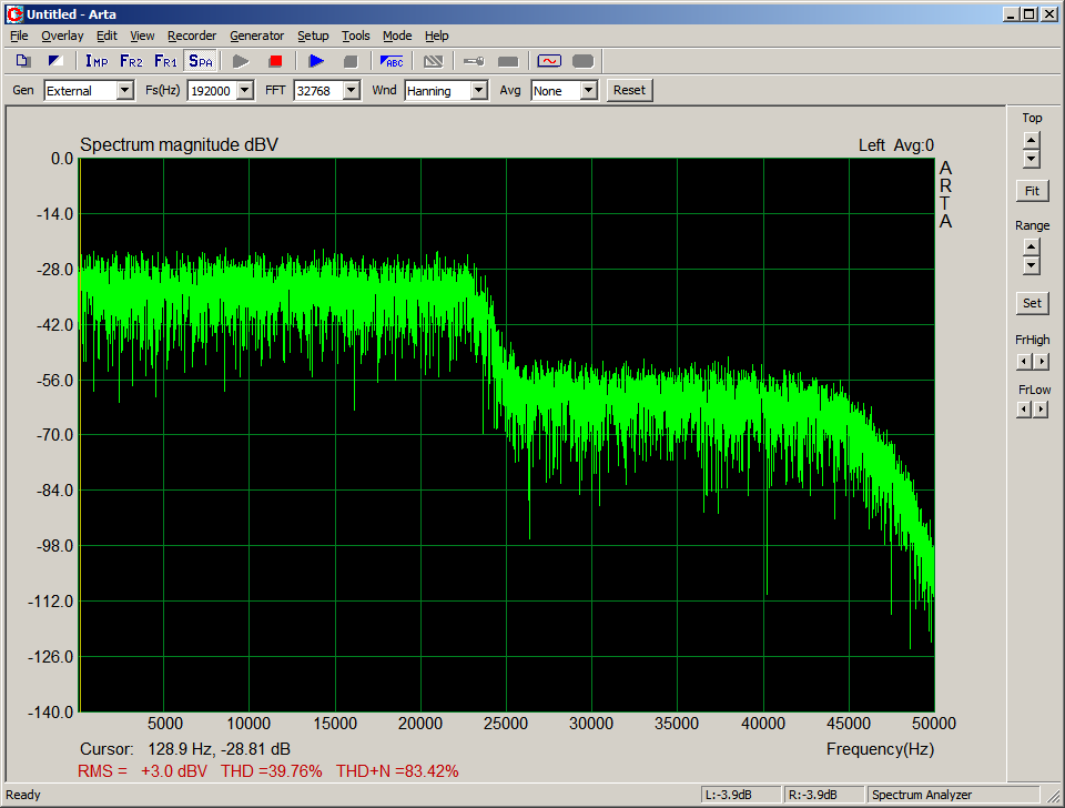

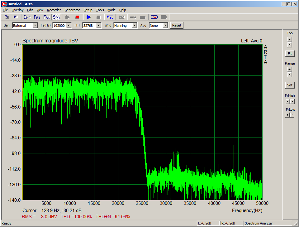

Has someone noticed huge noise after the filter rolloff frequency with I2S source?
http://www.diyaudio.com/forums/twis...embedded-audio-applicance-13.html#post3859330
I might have something incorrectly configured, but the I2S timing seems to be alright:
http://www.diyaudio.com/forums/twis...embedded-audio-applicance-13.html#post3860103
Notice: The I2S source is BeagleBone Black with internal low quality oscillator and the Linux with sound driver I've wrote -- http://bbb.ieero.com/ ... so there might be problem with my driver also.
I've been doing more research on the roll off noise issue with ES9018 described above.
Recent findings:
- the white noise in SoX->BBB->I2S->Buffalo is louder by 6dB than ARTA->PC->SPDIF->Buffalo
- when playing via I2S with volume reduced by 6dB the roll off noise is actually better than with SPDIF
- white noise with volume reduced by less than 6dB has roll off issues

From the stats I think that full volume white noise should not cause the issues. Or am I wrong and the volume must be really reduced?

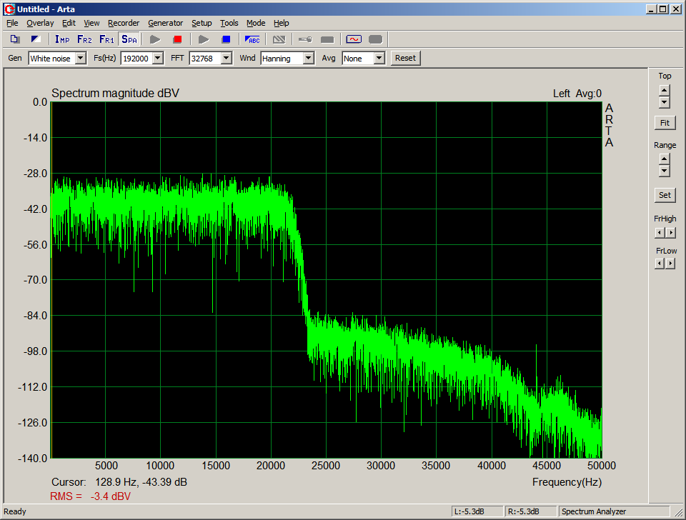

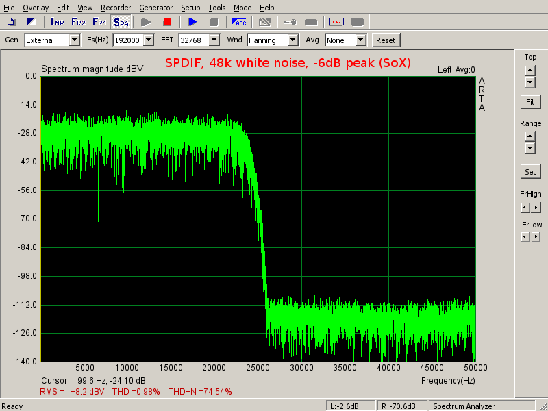

The same situation happens with SPDIF input.
Measurement setup (Linux):
SoX -> Int. soundcard -> SPDIF -> Buffalo 3 -> Preamp -> Juli@ -> ARTA
But now, the SPDIF white noise -6dB is correctly filtered. The measurement in previous post was done on different PC with Windows.

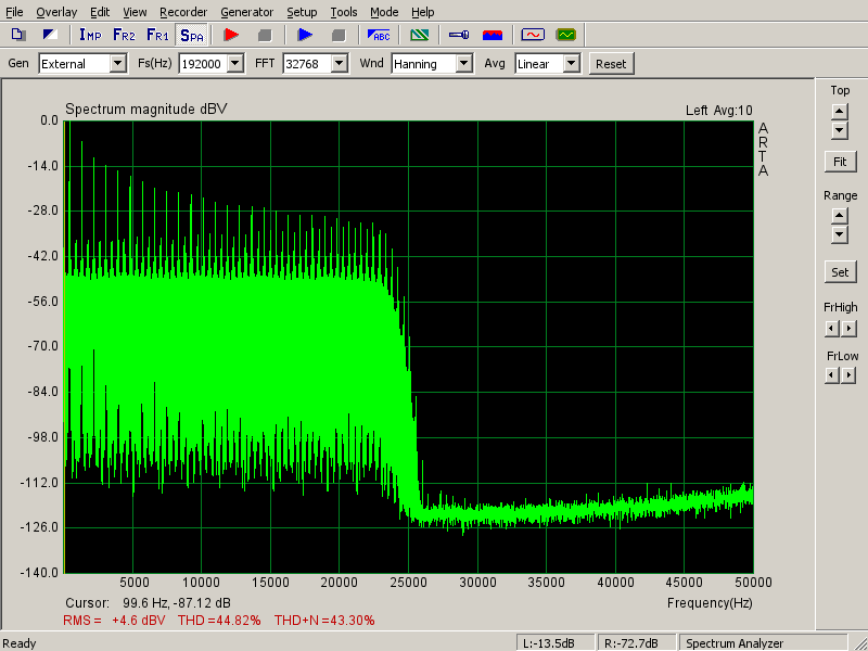

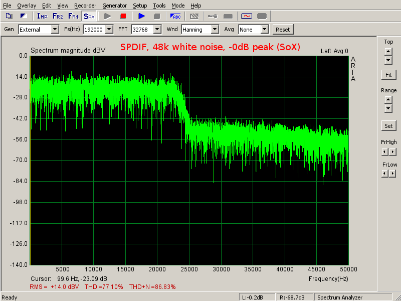

Is the white noise with peaks at -0dB a valid test signal?
DAC oversampling is not supposed to clip the output, it should have a safety margin, unless the DAC's filter coefficients are a bit too hot...
Can you post a scope trace of what happens during this clipping ?

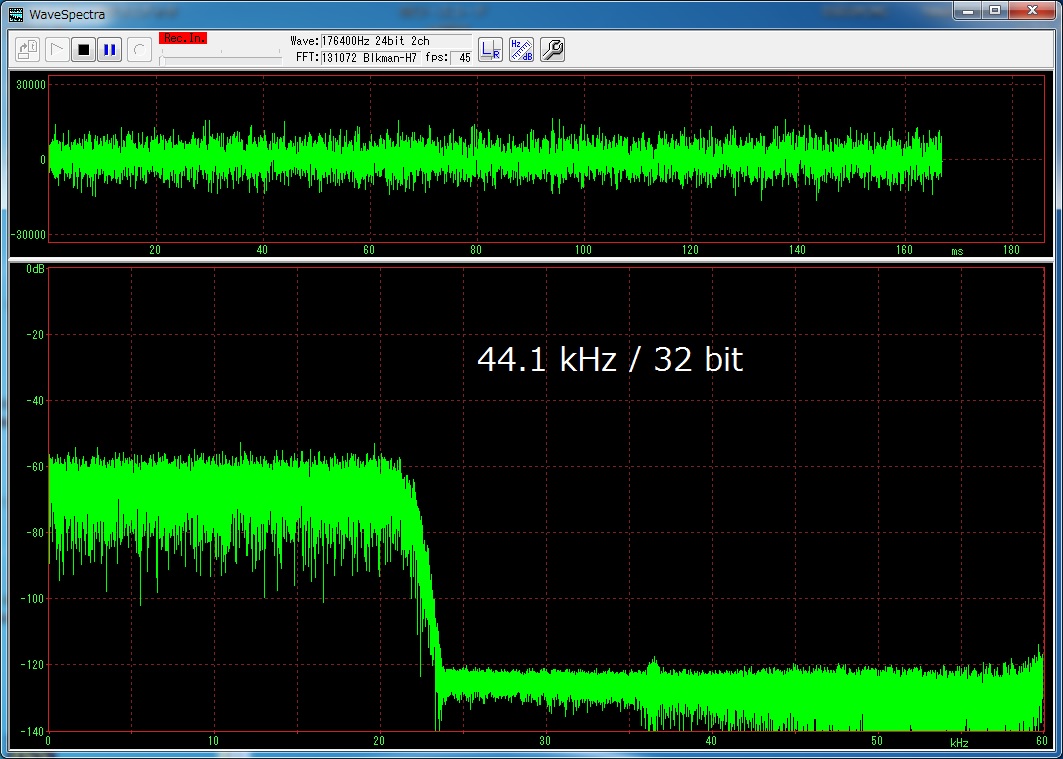

Hi, meiro!
As far as I know, you have never shows details about your Buffalo DAC and its settings.
I'm sorry if my understanding is incorrect.
Do you set "SPDIF auto detect = OFF" when you make experiments through I2S?
Bunpei
Bunpei
You are right, here is my B3 settings & wiring:
- SPDIF autodetect OFF
- Oversampling & reclocking ON
- Fast FIR roll-off
- DPLL Lowest, 128x multiplier (BBB has low-quality onboard clock)
- Quantizer 6, True differential, outputs joined
- "Buffalo II compatible input wiring configuration" for both PCM & DSD stereo input
- Input remapping ON
Nevertheless, I've been testing the most extreme cases when data gets clipped during oversampling. In the normal conditions it works perfect. Sorry for confusion if it was not clear.
- Fast FIR roll-off
OK, so the DAC doesn't have enough headroom built-in... at least it clips cleanly and doesn't wrap around like some buggy ones do !
Since it is just a setting (not a hardware bug) it will go away if you reduce the digital volume a little.
The spectrums you get are normal, if the oversampled signal clips, it will generate out of band noise.
Almost none have. Oversampling DACs cannot handle artificially generated signals like 0dBFS square in principle (oversampling + interpolation principle).
