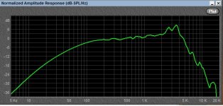

The database provides "Acoustic Response" from the Response tab.
Not sure if that equates to FRD.
With just the driver loaded, second pic shows Default 8W 5411 response.
Looks exactly like the PDF.
I realize this is factory default, and not actual.

That's interesting, that's a lot more data from XOP than I had. 🙂 I didn't mean to say it was just factory traces. I meant I couldn't find anything near that.
The only thing I could find in XOP was T/s parameters. As far as I could see besides the T/S parameters it seemed to act as if everything was ideal. Clearly I missed a lot in there!
