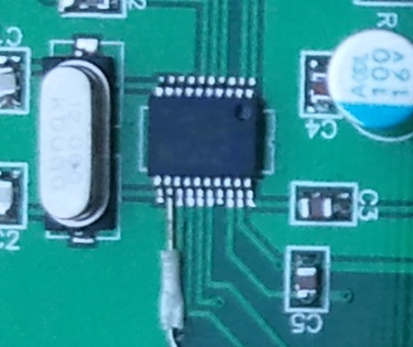

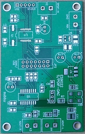

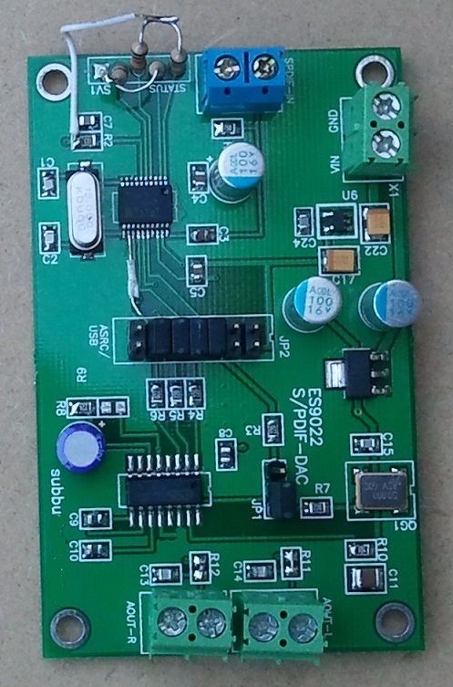

ES9023 PCB with WM8804
I made a PCB to evaluate ES9022/23 with WM8804 SPDIF. I have got the draft version (one error in the WM8804 section). The board has I2S header and separate power supply for ES9022, so the whole WM8804 section can be ignored.
I have been listening with it for few days and it sounds great.
I have got about 4 spare boards and ES9022 if someone wants to evaluate it. The PCB costed about $10 and DAC $4. Let me know if anyone want them.
-Subbu

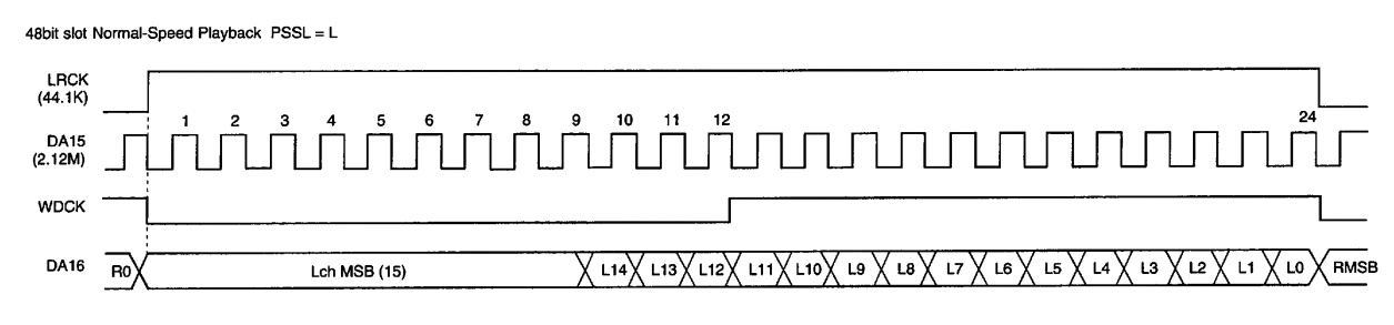

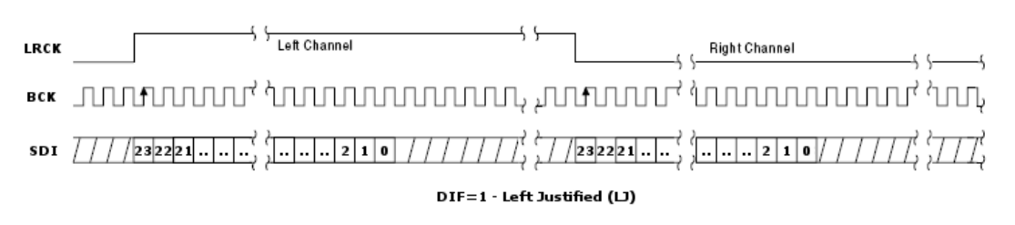

Hi guys. I want to try SE9023 as a replacement to an ordinary delta-sigma DAC from Cirrus Logic. This one will be linked to Sony's CXD2515Q. Those two chips are not directly compatible. The CXD2515Q chip outputs 16 bit right-justified standard format MSB first. This is the output data from CXD2515Q:
ES9023 will be used at 384fs fed with 16.9344MHz and set to left-justified format. This is how it looks like:
So from what I see, I only need to delay the LRCK by 8 cycles to make things work together. Am I correct?
Regards, Venci.
Regards, Venci.
