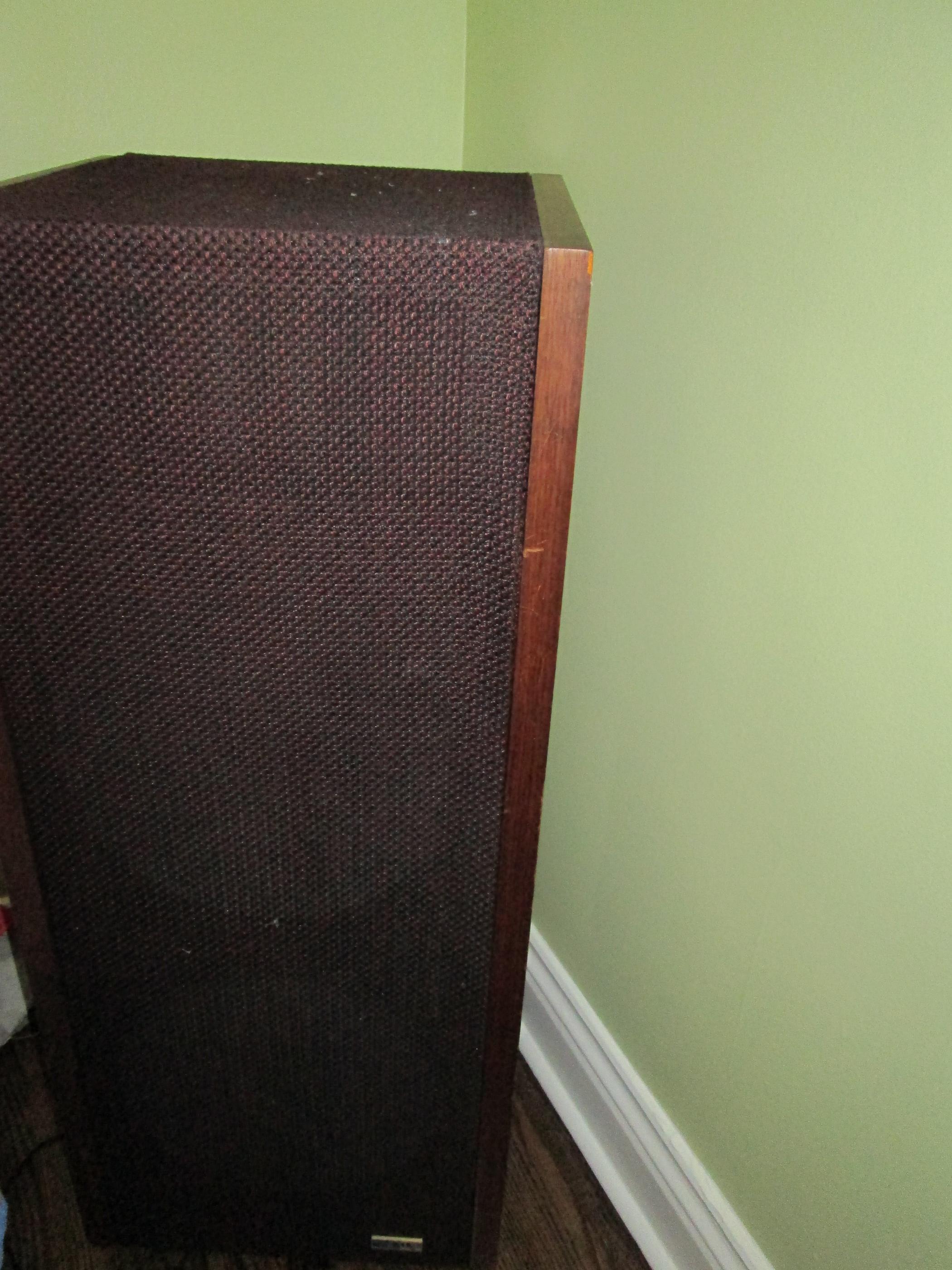

I inherited a pair of ESS AMT Monitors with "the great" Heil Air Motion Transformers! Wow, I'm just blown away by the quality and workmanship. Oh and they're a bit flimsy ... 😉 Nearly busted my hump carrying them to my car and 2 story walk-up appt. by myself!

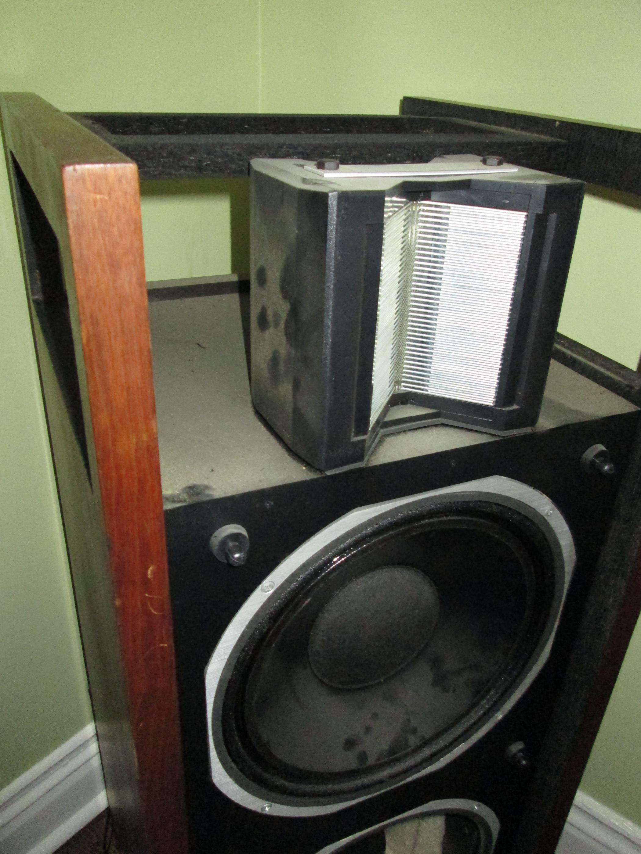

Oh you poor thing, all dusty ... and that's dust that came through the grill cloth! Nasty, ... and smells like Old Man.

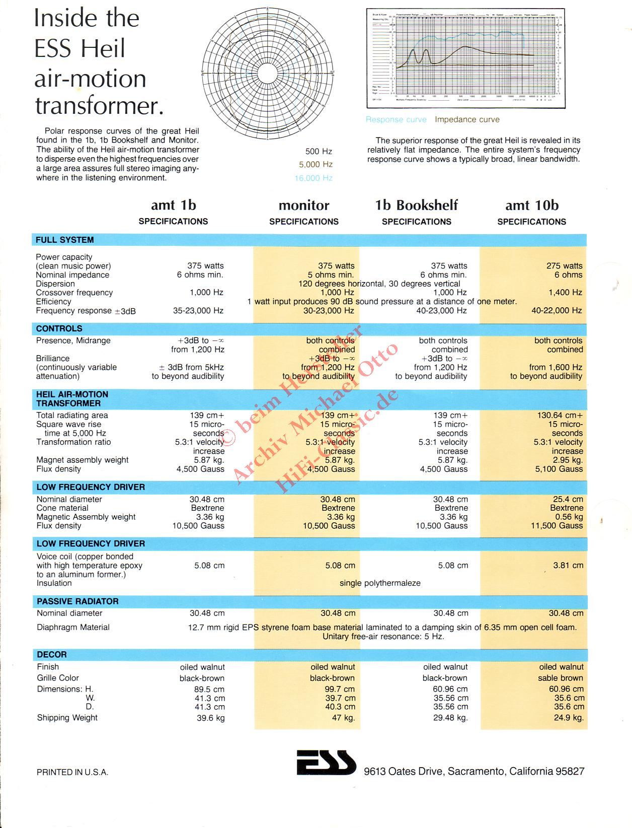

Having trouble finding specs, manual, xover schematic, etc ...
Here's good ol' HiFi Engine - Owners and Service Manuals
ESS Monitor Manual - Loudspeaker System - HiFi Engine
Description
Powerful in it's sonic delivery, tall and stately in appearance, the AMT Monitor represents the utmost perfection in ESS's superlative AMT series.
The AMT monitor effortlessly unleashes thundering crescendos with great force, yet deftly reveals the most subtly detailed musical tapestries.
Specifications
Type: 2 way, 3 driver loudspeaker system
Frequency Response: 30Hz to 23kHz
Power Handling: 375W
Crossover Frequency: 1000Hz
Impedance: 5Ω
Bass Radiator: 305mm cone passive
Bass: 305mm bextrene cone
Tweeter: heil air motion transformer
Grille: black, brown
Finish: walnut veneer
Dimensions: 997 x 397 x 403mm
Weight: 47kg
Wait ... 997mm x 397mm x 403mm is ... 39"x15"x16" and 47 kg is ... 104 lbs. 😱 No wonder I almost busted my hump!!!

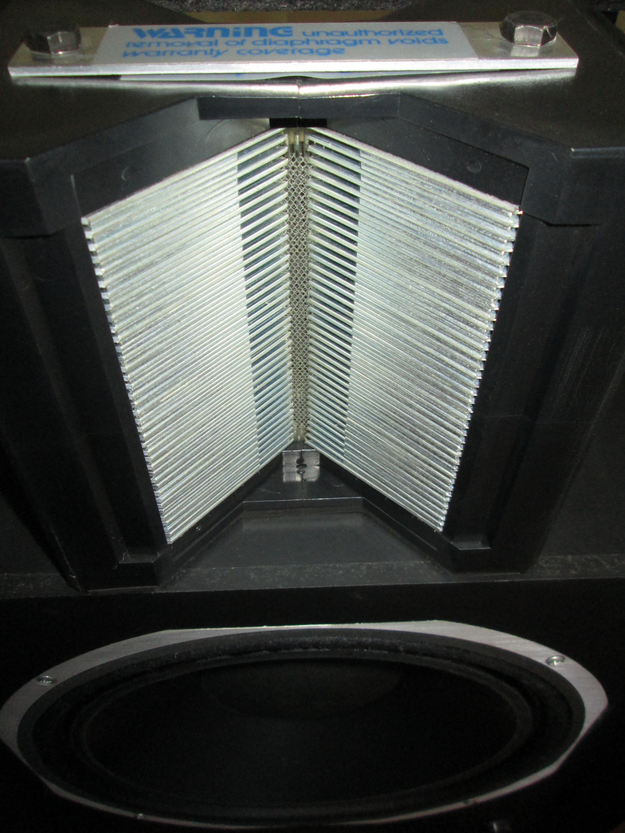

So here's the Great Heil (all cleaned up)

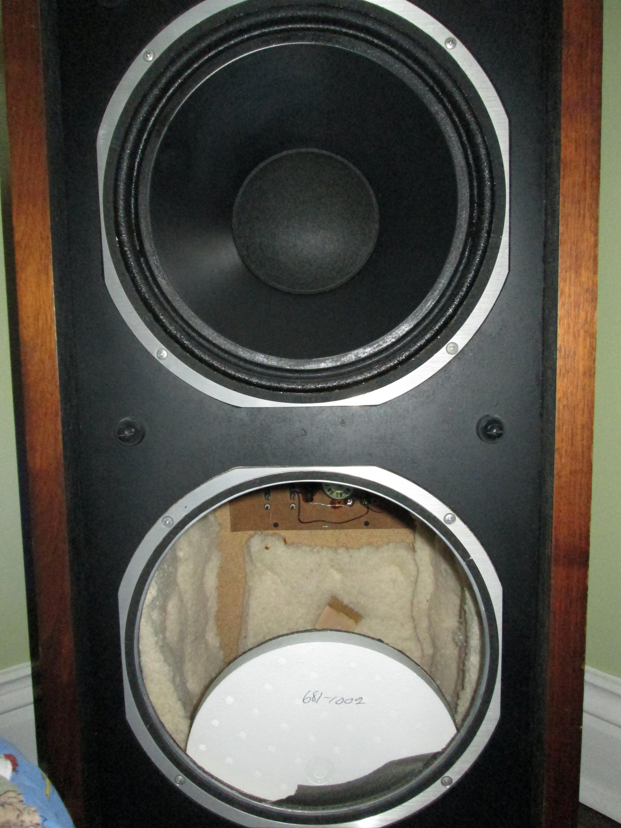

The 12" passive radiator just ... dissolved! All that's left is the Styrofoam disk!

Mine is the 1st version with the simple passive radiator: just foam surround and 0.75" Styrofoam circle (or is it the 2nd because it has the flat black Air Motion Transformer--AMT?) I'll need the replacement kit, it's:
PART# ESSPR-12 $28.95 usd (12")
ESS Laboratories USA (Replacement Passive Radiators at bottom)

Then maybe later I'll upgrade to the more advanced passive radiator: speaker without voice-coil (cone passive).
ESS Factory Replacement Passive Radiator, 689-12P

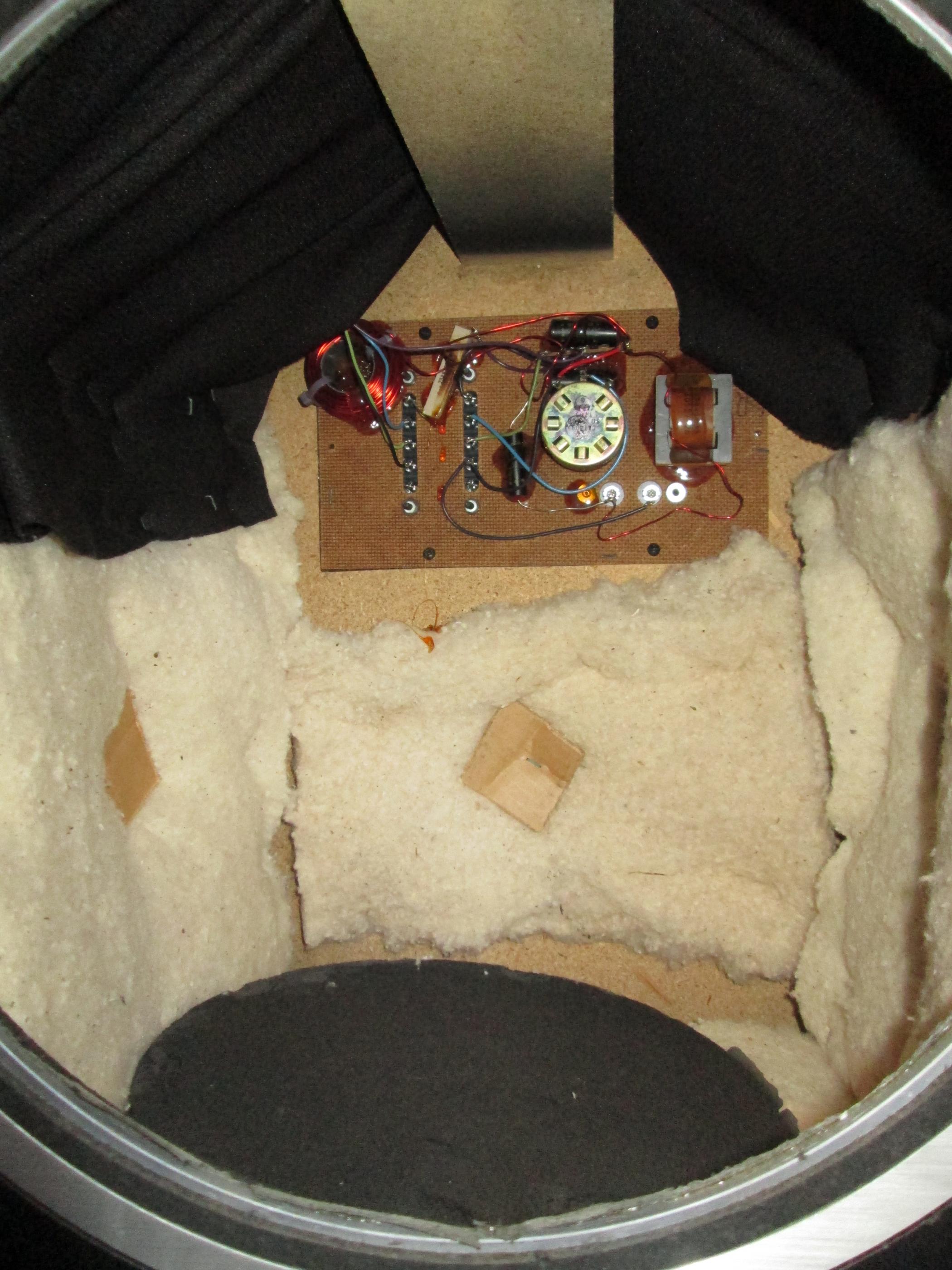

Here's pics of the xover and the back panel:
Anyone know where to get official stats, manual, xover schematic?

Looks like the same frame as their "rock monitor" ... that's the one NP worked on. Dual 10's w/6" mid.
The configuration you have could use the amt 1b xo. same/same 12" w/12"PR and a 1k xo point. Don't have a schematic for it though.

Hey, I just picked up a pair of these myself - first version as well. Sound fantastic, but have some issues with the veneers and one of the grill supports at the top is busted - looks like you're missing one entirely! I recapped my friend's AMT 1b's a few months ago - I was expecting to see the same crossover which has two 33uf caps, but also two 10uf caps. I haven't cracked mine open yet; do you happen to know what value the remaining cap is?
Anyone know which wires go where?

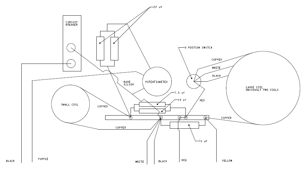

This week I picked up a pair of AMT – 1a tweeters with the crossovers. The speaker cabinets had been damaged beyond repair in a move 13 years ago. The owner had remove the tweeters and then cut the tops off of the cabinets. So now what I have is the top of the cabinets with the crossovers and the tweeter separate from that. I made a diagram of the physical crossover lay out. But I don't know which wires go where. The back of the tweeter has a purple wire and a light blue wire. I would assume purple goes to purple.

Hi Jeff - this is L7. (obviously!)
I wouldn't recommend the cone passives for your towers. Stick with the flat radiator as the suspension employed in the active woofer is too stiff for a conical drone. 😉

I am pretty much done with recapping the original crossovers, by just replacing the old caps with Dayton audio grade MPT 5%, and the square power sand resistors with low inductance wirewounds.
