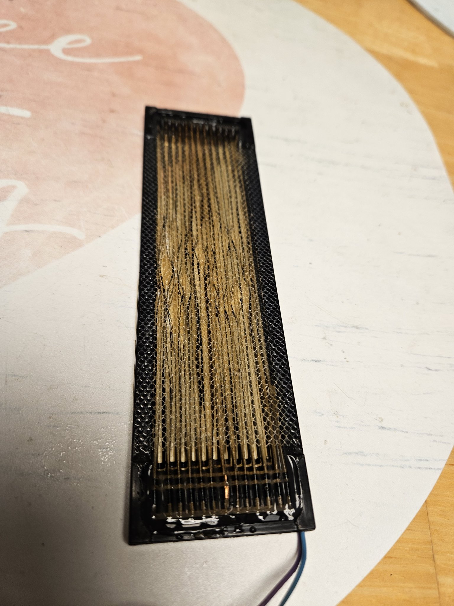

I acquired a pair of Heils from someone that used them with “Horned Heils” from the Horne Shoppe. I tested them on DMM and one was 7.9 ohm and the other read 3.9 ohm.
Just yesterday the seller offered the Horned speakers with the crossovers in a trade and I asked him why the Heils were different impedances. He told me he did replace one diaphragm awhile back and told me he didn’t realize they were different. He mentioned thinking the necessary ESS Heil impedances for the “Horned Heil” is 8 ohm.

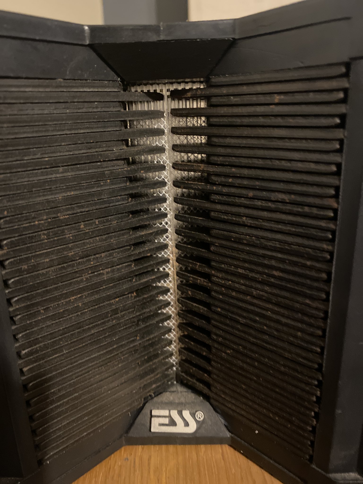

The technician I communicated with said they haven't produced 8 ohm diaphragms for decades. And the 2012 horn shoppe speakers are probably 4 ohm diaphragms. The AMT in the picture looks like one of their more recent designs. The older models did not have the ESS badge.

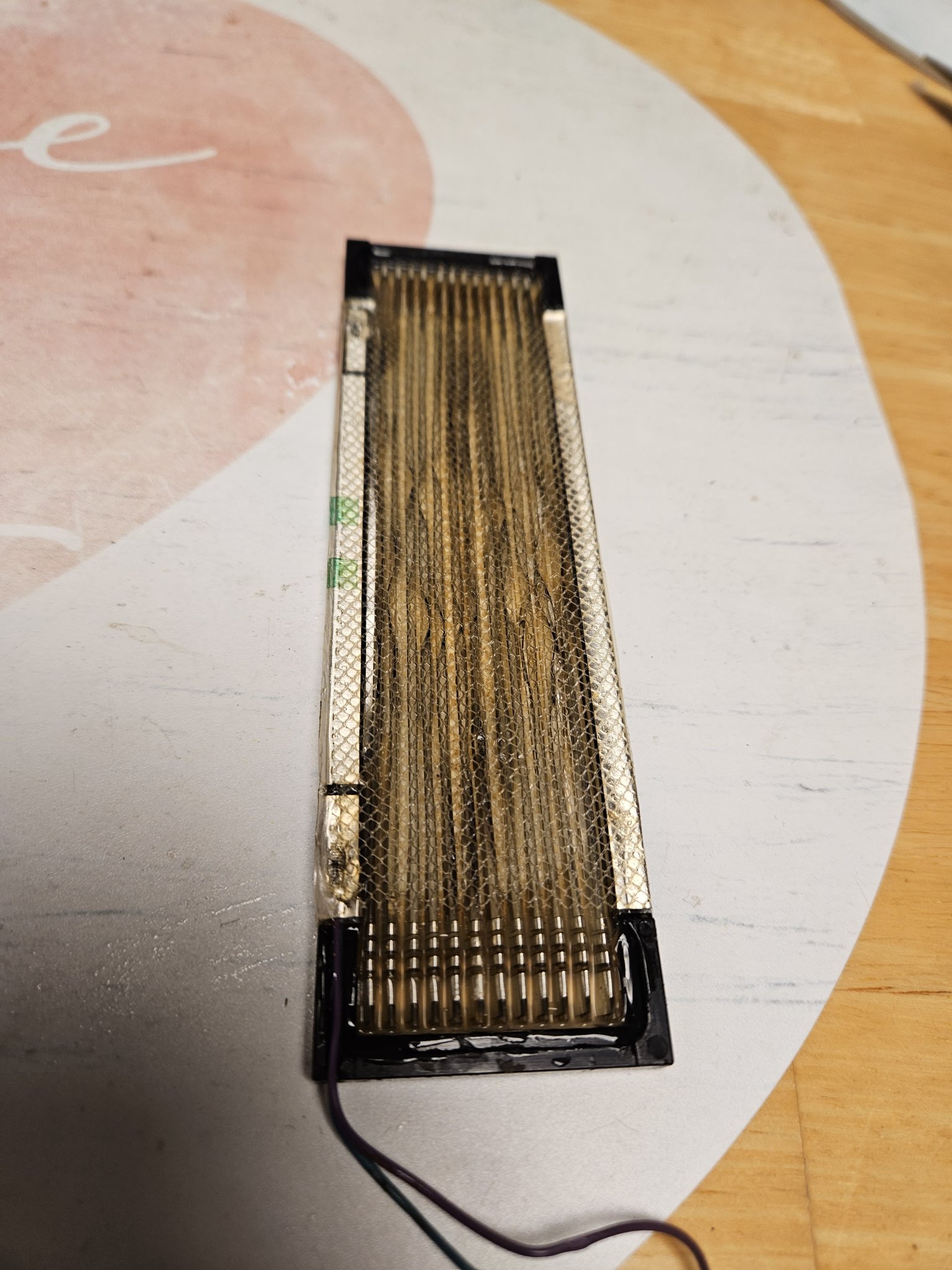

one of them definitely does not match the other just looking closely at the diaphragms. One of them has what appears to be a metal grate while the other doesn’t.

The picture you showed is the most recent design and was delivered with a 4 ohm diaphragm.
Show us a picture of both of them.

Actually if one of the diaphragms was 8 ohms and they haven’t made 8 ohms for a long time it means that you have an original pair of 8 ohm units in which one was replaced with a newer 4 ohm unit. That means the crossover is made for 8 ohm units so either find a old 8 ohm diaphram or redo the crossovers for 4 ohms.
The corrugated diaphragm in the main picture does not appear to have the bridal veil gauze damping material attached. Perhaps it may have been removed or the AMT has had an early type fitted . Certainly the housing is the current version of the the Heil. For clarification , there should be serial numbers and a manufacturing date etched on the rear face of each unit. If you have this information, it will indicate if they are a pair, as that is how they are supplied from ESS.
Yes. They are consecutive numbers on the housing. The guy did replace the diaphragm on one of them but couldn’t remember which one and didn’t realize them to have different impedances. I wonder if he bought a used diaphragm from someone and it was 8 ohms.

Here is what I think happened. He bought the Heiled speakers from Ed and the pair dated 2012 with consecutive serial numbers that were 4 ohm. He accidentally blew one diaphragm and got a new one (not from simply speakers or ESS) that was 8 ohm not realizing there were different diaphragms completely.
I asked him where he got the diaphragm and he thinks he got it from Ed as a replacement. I wonder if he accidentally sent him a very rare 8 ohm version.
Another thing of note. When I first opened the diaphragms to look at them and test them. The 8 ohm one appeared to have the clay molding that seals the diaphragm in unevenly put back and the bottom sticker removed. I would guess this to be the one he replaced.
I will call ESS today to get a new diaphragm and pull out the 8 ohm one. I’m sure someone would want/need one in the future.
