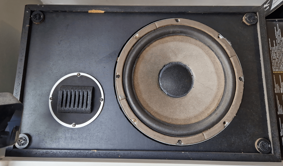

Here a "naked" front view:
What I figured so far is:
  • Finding a proper 2-way assembled crossover is very unlikely
  • To change the crossover frequency of the original crossover without messing up I need to use XSIM and thus I need the frequency response and impendence files (ZMA and FRD) for the woofer and the tweeter. Which I'll never find.
  • Even more so if I later want to make the speakers 3-way, I need the ZMA and FRD
  • I also suspect that even in the unlikely case that I find the right files would be better to make my own measurements since these drivers are almost 50 years old
