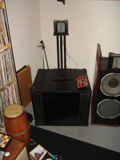

Frankenheils
DIAMOND:
I noticed you were using amt Monitor s or amt1aM s as well.
(the amt is mounted at about 36in in height in the factory tower config.)
I also noticed you mounted your amt what appears to be considerably higher.
so I have two questions
what height did you use ?
Do you have an opinon / thoughts on the effect of the increased height?

They are about 45" off the floor. The sound of the Heils at that height is good, they do have a fairly broad dispersion pattern.
My thought is that the optimal height of the Heil is dependent on room acoustics. There is no doubt a sweet spot for every room. Seeing that under 1000 Hz is bass-mid bass (omnidirectional) decoupling the Heil from the bass-mid bass driver is an interesting consideration.
I'm close to getting a single Heil so I can try four on each side. I'm thinking of setting them up in a vertical array using ready rod to bolt them down to a wooden base.
