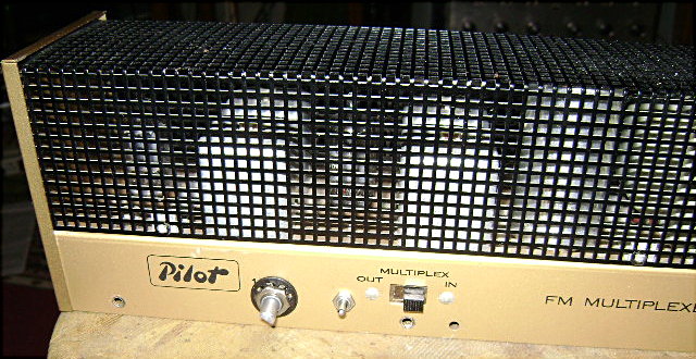

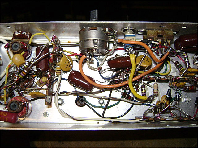

I connected my Espey 200 to a Pilot 100 demodulator and am getting good results from them.
Espey 200 am/fm radio & Pilot 100 stereo demodulator

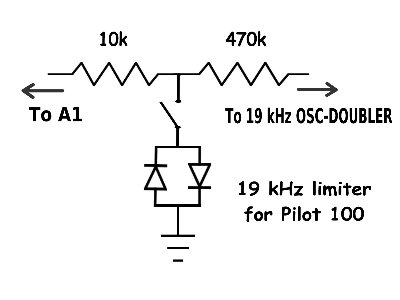

19 kHz limiter for stereo demodulator
I got the idea of putting a 19 kHz limiter in my Pilot 100 stereo demodulator from these three patents.
US 3235663 Fm stereo multiplex receiver having limiting means in the pilot channel
US 3287501 Multiplex detector circuit
clipper 35
US 3270138 F. M. stereophonic receiver having noise prevention means in the pilot circuit
The simplest modification seemed to be to use antiparallel diodes across the signal path to clip positive and negative peaks outside the +/- 0.6 volt range (for two silicon diodes). I put the limiter at point A in the schematic http://members.shaw.ca/pacifictv5/pilot100.jpg .
The limiter includes a 10k resistor between tank circuit A1 and the 470k resistor with the antiparallel diodes connected between ground and the connection point between the 10k and 470k resistors. I put a switch in the circuit to switch the diodes in and out of the circuit to compare the effect with and without the limiter. WMUC (88.1 MHz) broadcasts with 10 watts of power and when the Pilot 100 is set to stereo, usually a grumbling splatter sound can be heard during silent passages which seems to be from interference from nearby stations, like NPR on 88.5 MHz and probably other stations. Sometimes when WMUC is off the air I can hear a lot of noise at 88.1 MHz which sounds like other stations bleeding over into that frequency, as well as another distant station on 88.1 MHz. Switching the diodes into the circuit essentially causes the grumbling splatter sound to disappear, but some noise can still be heard at a lower level during silent passages. Its a distinct improvement. Before this, I put a 500k pot having a switch in the Pilot 100 between the slide switch stereo outputs as a blend control which can be switched on and off and adjusted between stereo and mono. Blending the left and right outputs tends to reduce noise since the stereo noise is out of phase in both channels.

I put a dynamic limiter in the Espey receiver with amazing results, ie. lower noise and better stereo separation. Details are at the bottom of this page.
