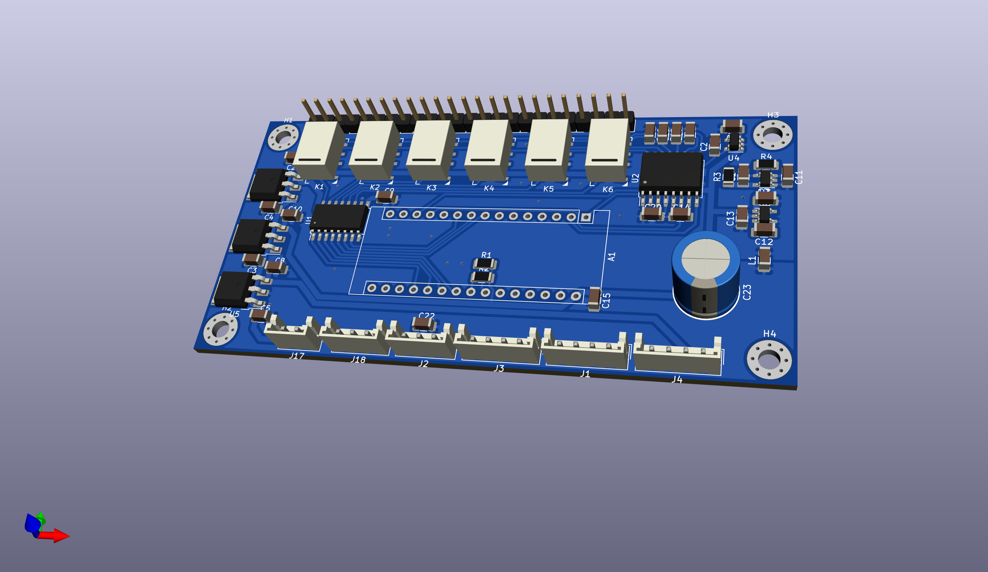

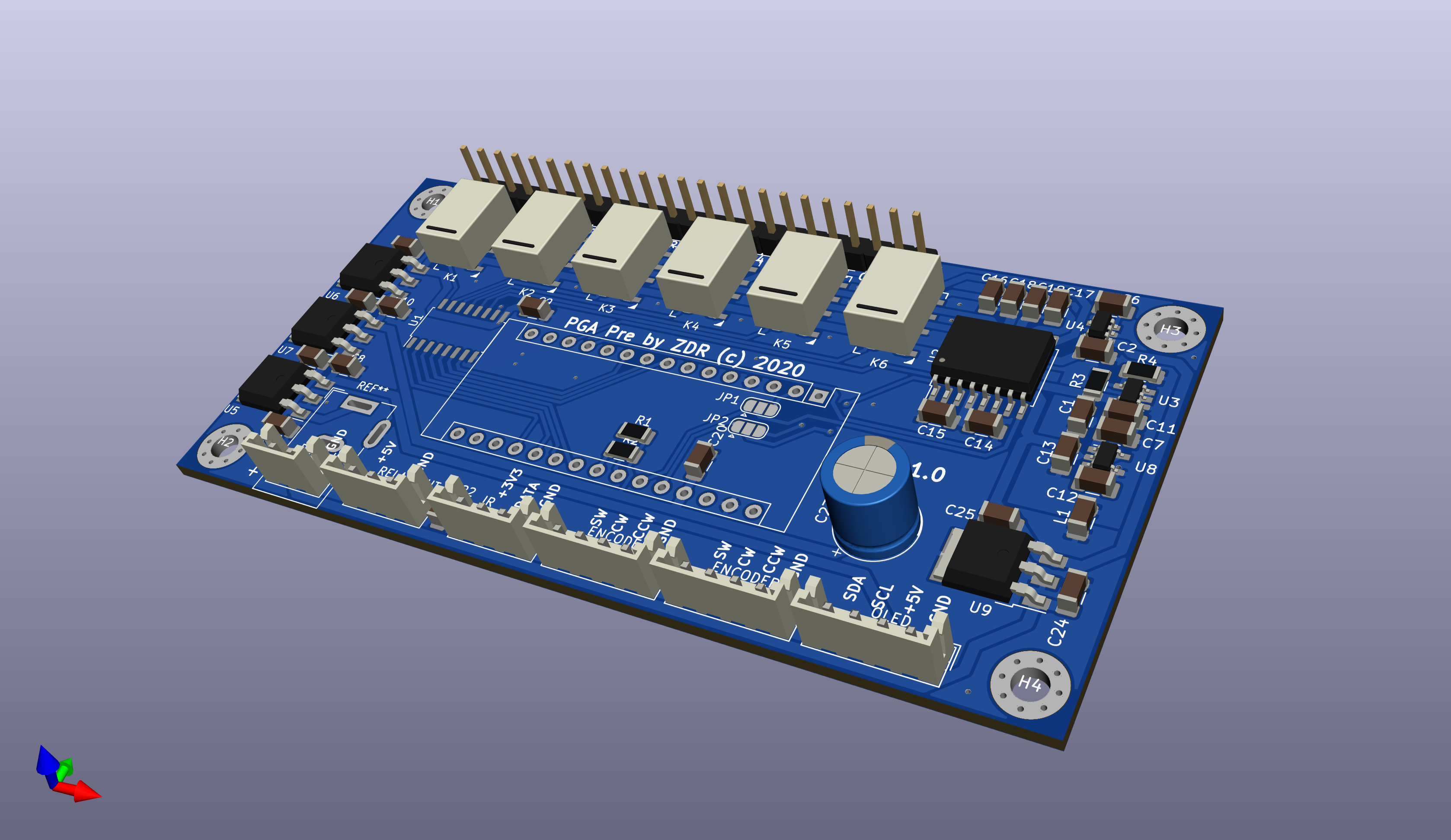

ESP32 driven PGA2320 preamp/IO switcher

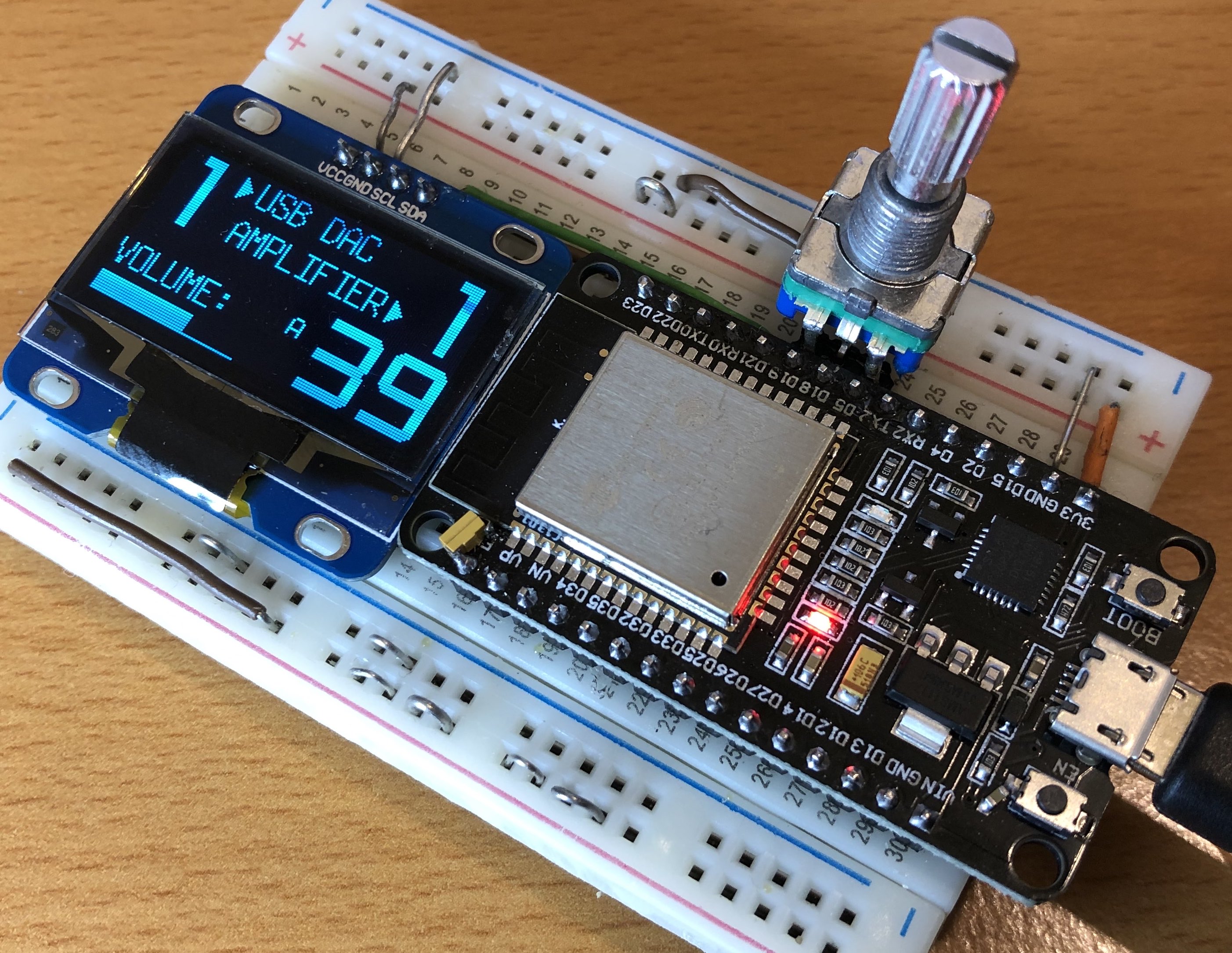

Before starting the project, first I would like to check if similar thing already exists, and secondly, if it makes sense at all...
I plan to base it on LDR Pre MkII code:
https://www.diyaudio.com/forums/ana...dr-pre-mkii-ldr-volume-control-switching.html
which means 2.42" OLED display, dual rotary encoders, IR remote, 4 input channels and 2 output channels switched by relays, only PGA2320 instead of LDRs. Additional features available from ESP32 would include web interface for channel switching and volume control, and potentially even A2DP BT audio streaming.
Why PG2320 instead of LDRs? It's simpler to use, much lower distortion and coloration, which some might prefer as opposed to LDRs. I heard PGA2320 in M3Si and I liked it a lot.

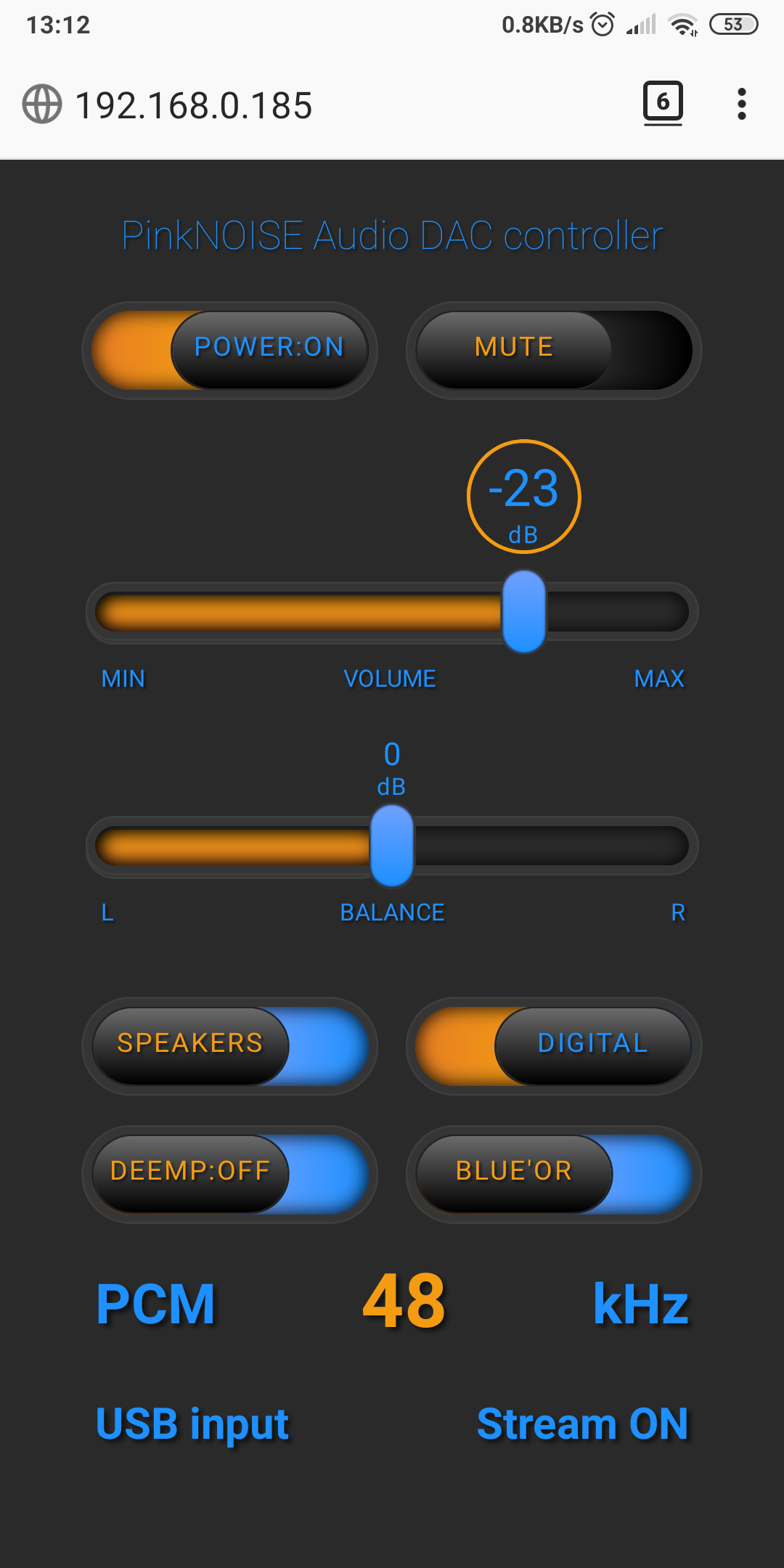

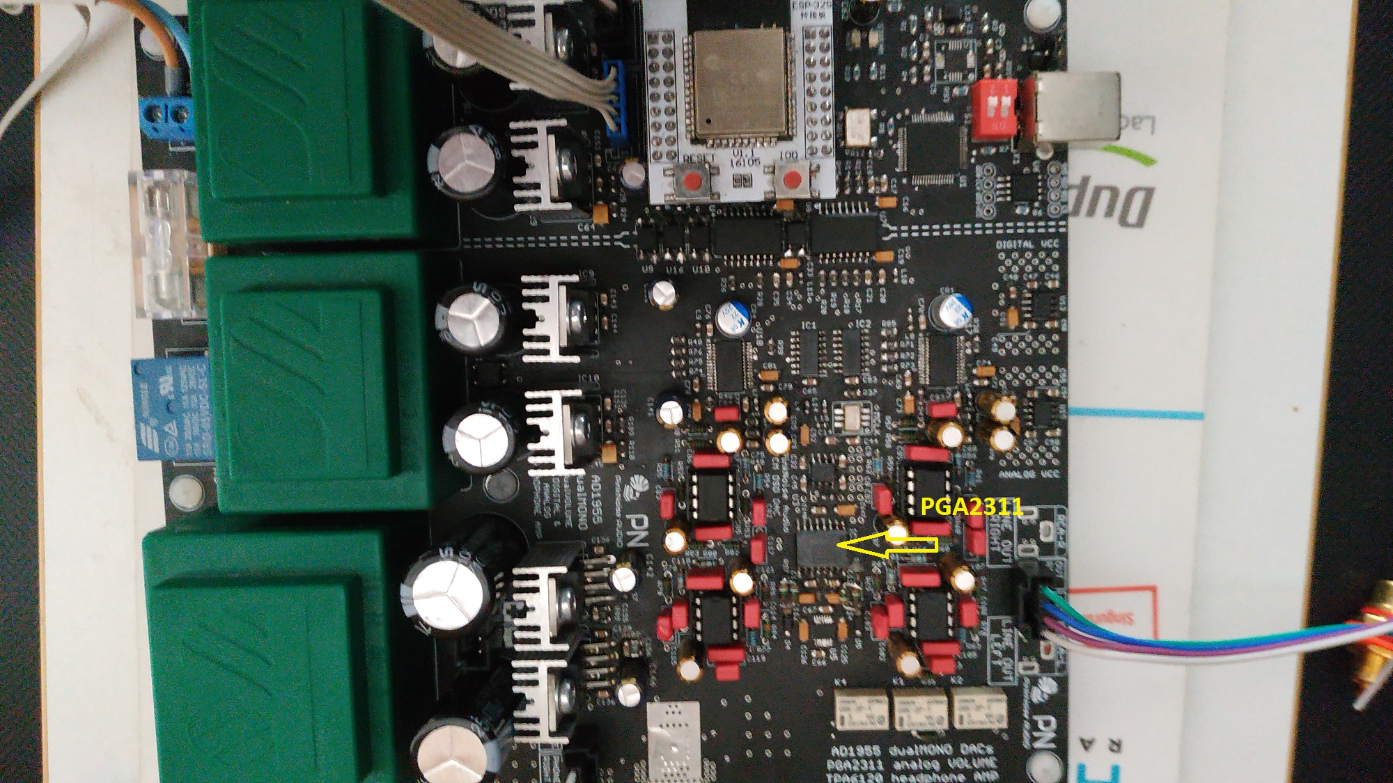

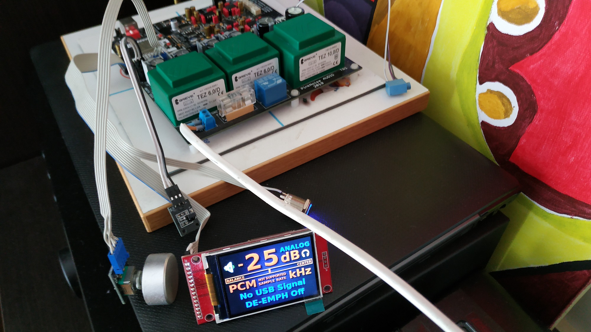

I used ESP32 with PGA2311 in one of my USB DAC project. I have made my own PCB, except for the ESP32 adapter plate, which I have bought from Aliexpress, the white PCB in the pictures below.
The USB to I2S chip, XMOS, has a few I/O pins connected to some ESP32 I/O pins. They are like F0...F3 pins from Amanero board. Every time one of these pins goes high, to tell ESP32 that it is 24.xxx related sample rate (48kHz, 96kHz, etc), the web server freezes (web based remote control). It took me a while to figure out that it is an issue related to WiFi antenna. After I spent 2 days checking the software, I have found that there is no issue in 1 meter range, near my router, so there is a problem because of the poor design of that white PCB adapter for ESP32: in a certain combination of the ESP32 I/O pins state, its PCB antenna dramatically loses the signal strength, because of the PCB traces below of it that shouldn't be there.

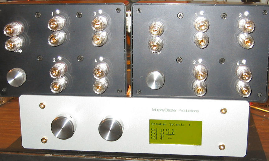

Many years ago I made an 8-channel preamp with 2 PGA4311 chips, and eventually used that circuitry to make a volume-compensated relay switch box. You can switch between speakers using relays and each switch position has the volume controlled by the PGA4311.
Recently, one of the two boxes I made broke--the spring tension on the flex cable to the LCD caused that connector to fail, so I made a new CPU board using the Heltec ESP32 WiFi module. The updated display is a Nextion 3.2"module, which fit OK in the front panel opening after a bit of cutting on the inner chassis. There isn't an antenna connector on the Heltec module, but you can solder an antenna wire to the printed "F" antenna printed on the board. I used one of these, and it improved the ESP32 signal strength by about 6dB. I epoxied that antenna to the outside of the chassis--it looks nice and works great.
One of the two boxes I made is mostly finished. You can navigate through the menu with the rotary encoders or IR controller. A new feature is Bluetooth control via a simple cell phone app. I'm just using the MIT App Inventor tools for the cell phone app and I'm hoping that the IOS tools will get released soon--already got the Android version working OK.
One problem I ran into is that there are some issues using the Arduino remote control library and the EEPROM library. Read through this if you are using that combination and want to save yourself some grief.
To answer your questions: yes, a similar thing already exists, and yes, it makes good sense to go this route. Cell phone control is a lot nicer than those cheezy remotes, and the ESP32 is a powerful and fun chip to work with. It's also got enough resources to implement the MQTT client. I've got that running on a different project, but decided on Classic Bluetooth for this upgrade.
Another thing to be careful about: the Heltec ESP WiFikit V1 and V2 chips use a somewhat different pinout for the voltages, and the V2 chip generates a lot of smoke if you put it in a V1 socket.
Here's a pic dated 2008 of one of the original boxes. I can take pictures of the updated version if there is any interest.

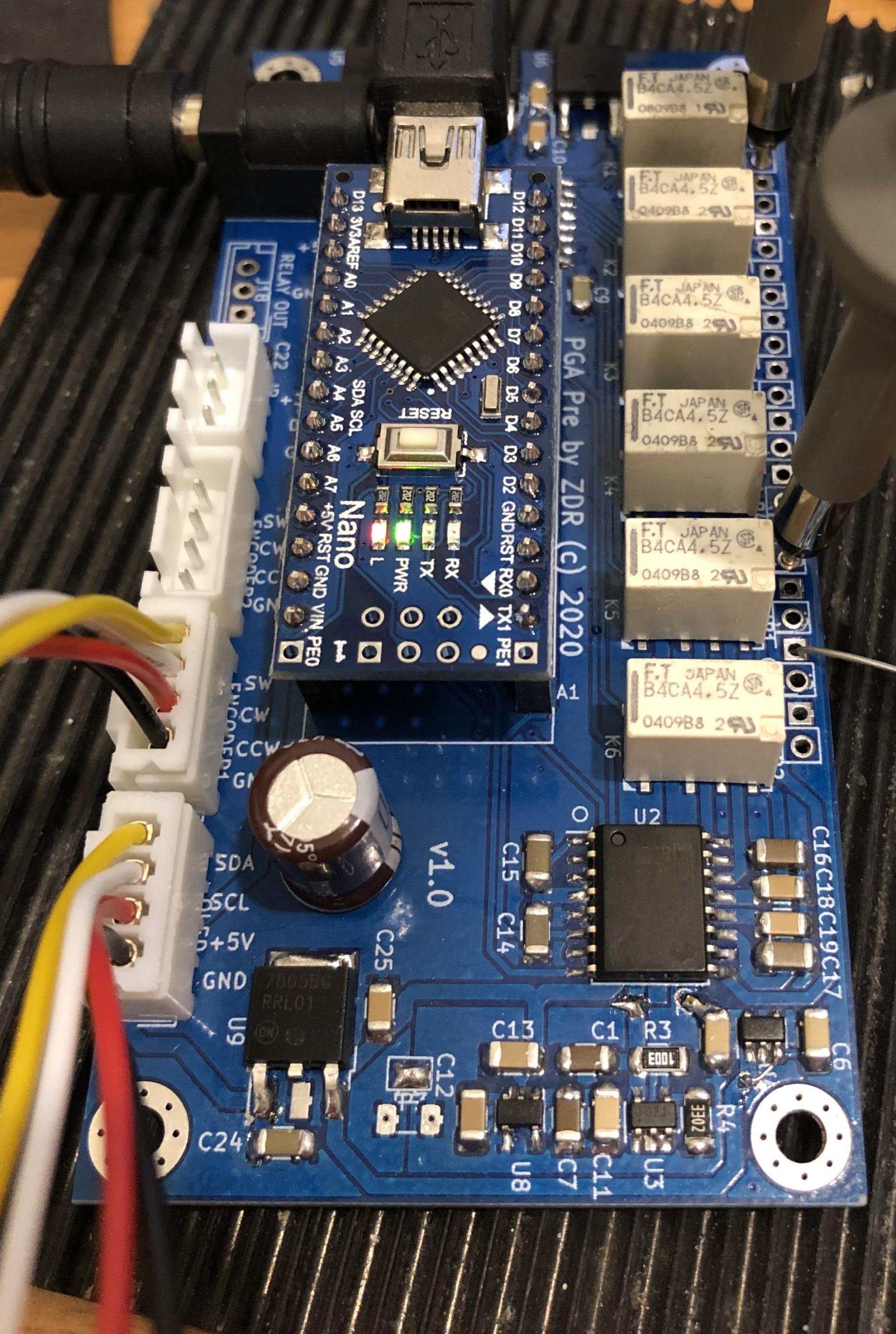

I was disappointed to see a lack of eeprom in ESP32, since my solution uses it extensively. So I revisited the idea with Arduino + PGA2311, until I figure out how to resolve ESP32 issues.

Ah, did not know that ESP8266 had an EEPROM. Anyway, I ordered PCBs already, so will play with Arduino version for a while, hear how it sounds before moving to other options.
