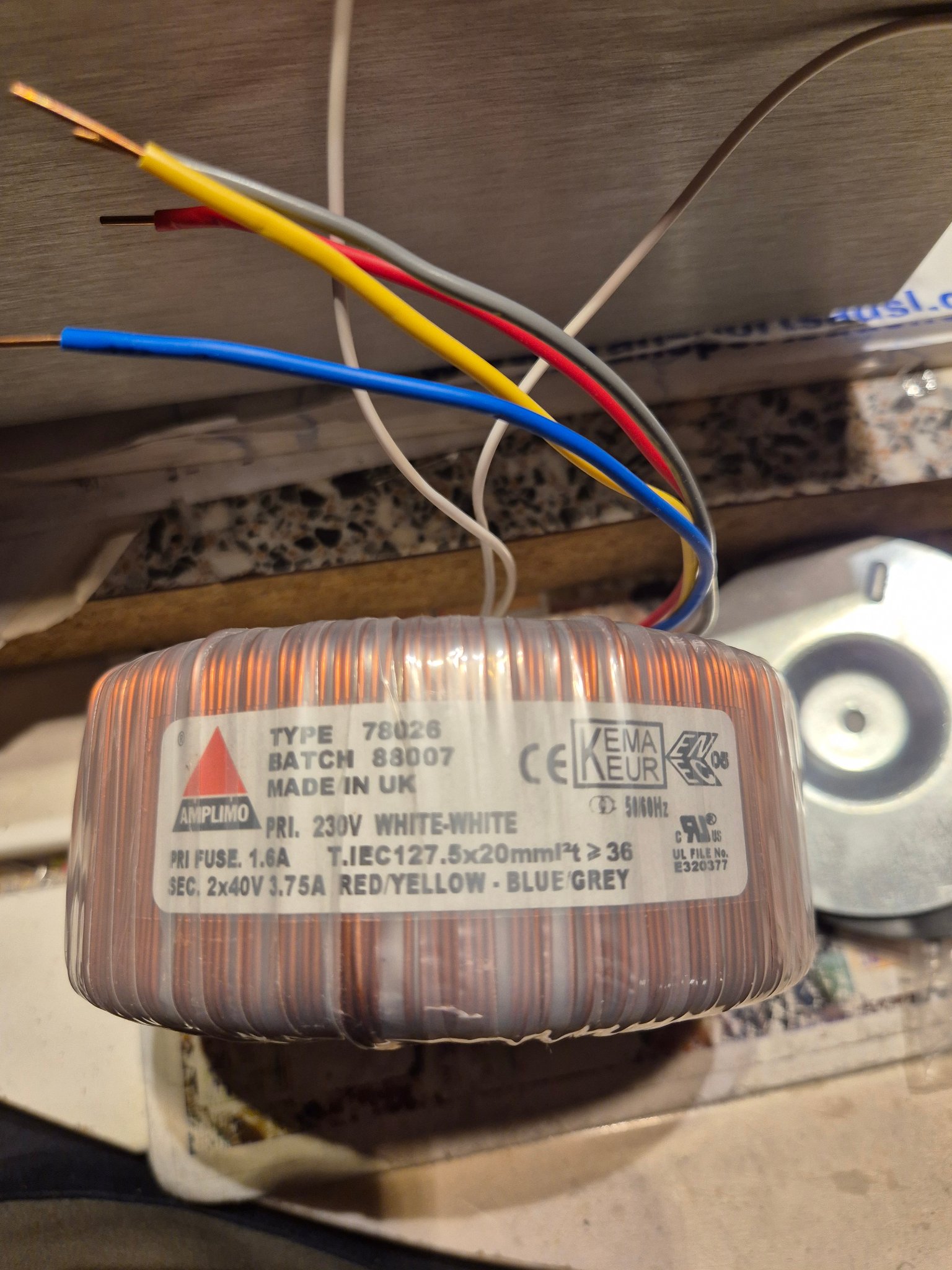

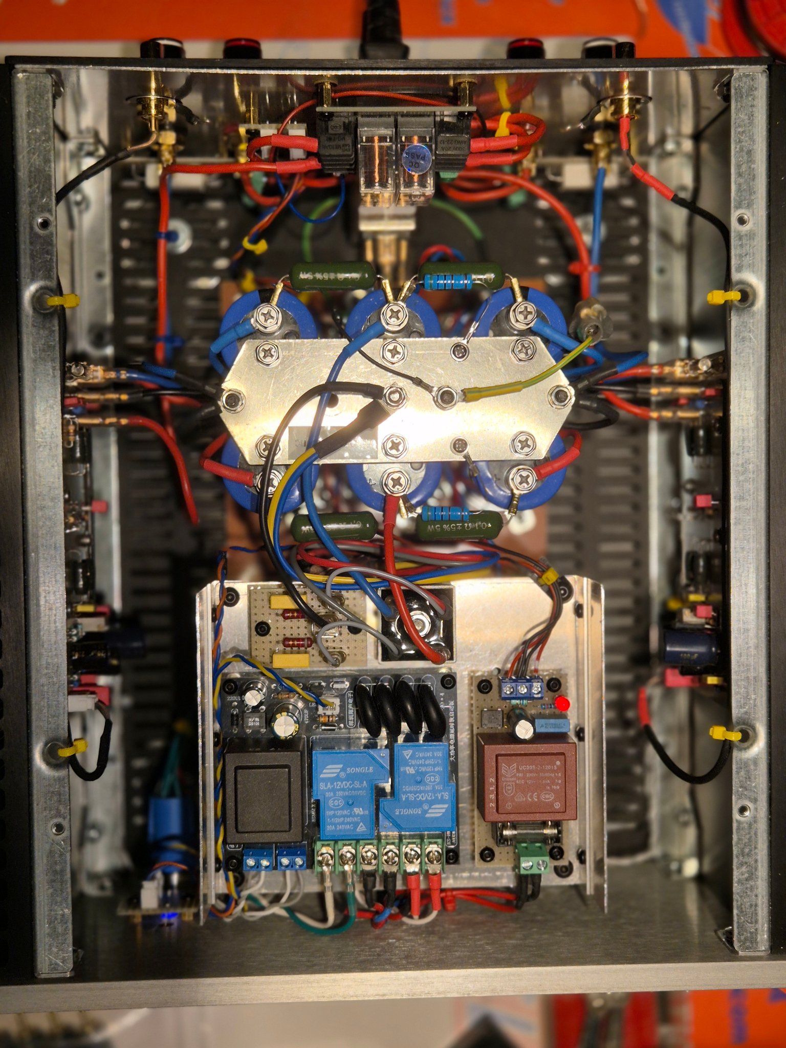

I made a stereo amp with 2 P101 circuits during the last few months and was a little disappointed by a faint background noise remaining on the right channel. Noise output level was about 3-4 mV pp, with a square shape visible on scope.Power supply was clean thanks to 8.2ohm+0.1uF Zobel networks on each 40V secondary. The transformer was lightly buzzing, and I discovered it was radiating some 50Hz to the phono cell nearby. The background was probably induced by the induction of the transformer.
After some time, I decided to purchase a new 300VA toroidal from a Dutch famous maker. The new transfo weighs 2.9 kg, against 2.5 kg for the former. Magnetic field is probably lower in the new one.
Now, my ESP P101 is absolutely quiet. The sound seems also clearer, more precise, but this is only subjective.
A well designed and heavy power transformer is a must for this Mosfet amplifier.
