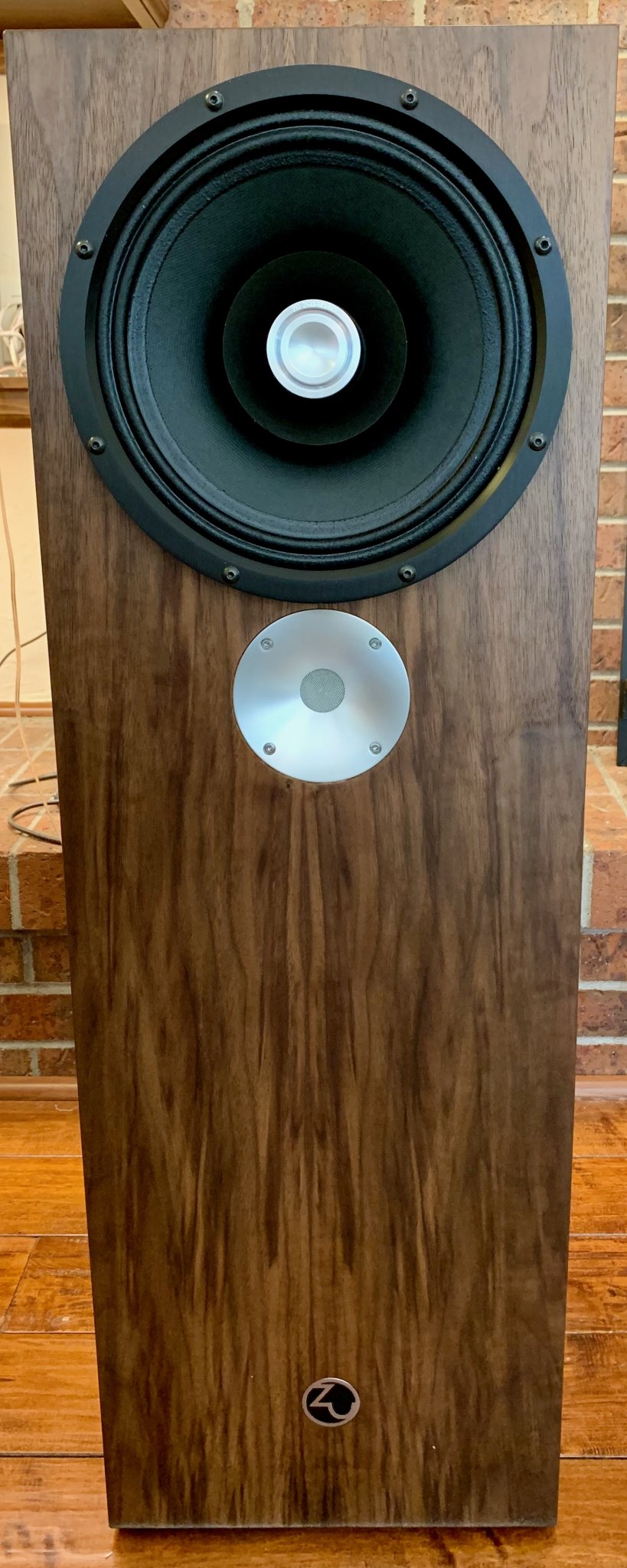

That review link is talking about a Zu Speaker that I had never actually even heard of, the Zu Essence, which was released in 2009. While there are some similarities between those speakers and my Zu Dirty Weekend 6, they're more different than similar. Both drivers are different, the tweeter isn't even the same kind of driver - the DW6 uses a compression horn loaded tweeter (in fact Zu don't use ribbons at all anymore), the cabinet is a different design, and the porting method is completely different. I also didn't pay anything like $5k for mine - the DW6 starts at $1599.
I will also say that one of the big draws of Zu speakers was the finish. They're in my living room, so I wanted a speaker that looks like a nice piece of furniture, not a black plastic box. I went with a walnut finish, and they are absolutely stunning. It's bookmatched, figured walnut, absolutely beautiful.
So far, on the same electronics, the Zu's outperform the Wharfedales in every way to my ears - and of course they should, at about twice the price. The bass is more extended and textured, the midrange is more detailed, the treble is smoother, and the imaging is significantly better. Once I'm done nitpicking with the phono pre, these aren't going anywhere.
