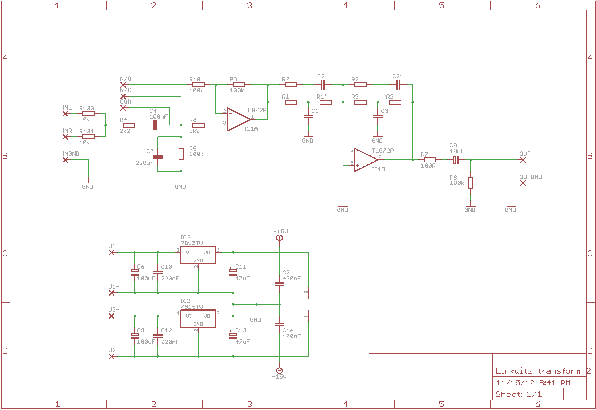

I'm interested in building the Linkwitz transform circuit shown at Rod Elliott's website:
http://sound.westhost.com/project71.htm
This project page has a very good article about this sort of subwoofer equalization. It has some schematics for a Linkwitz transform circuit so I drew a printed circuit board for it with the Eagle layout editor. I have access to a PCB manufacturing machine at my school and I'm going to use it to fabricate the board for me.
I've never used Eagle before, so I'm not sure if my beginner's design would have some obvious pitfalls.

I would look up some newer op-amps. Nothing exotic needed. I would also look into a few suggestions on improving the regulator circuit. Not much, for the use intended this is all quite workable but a bit has been learned in the past 20 years.

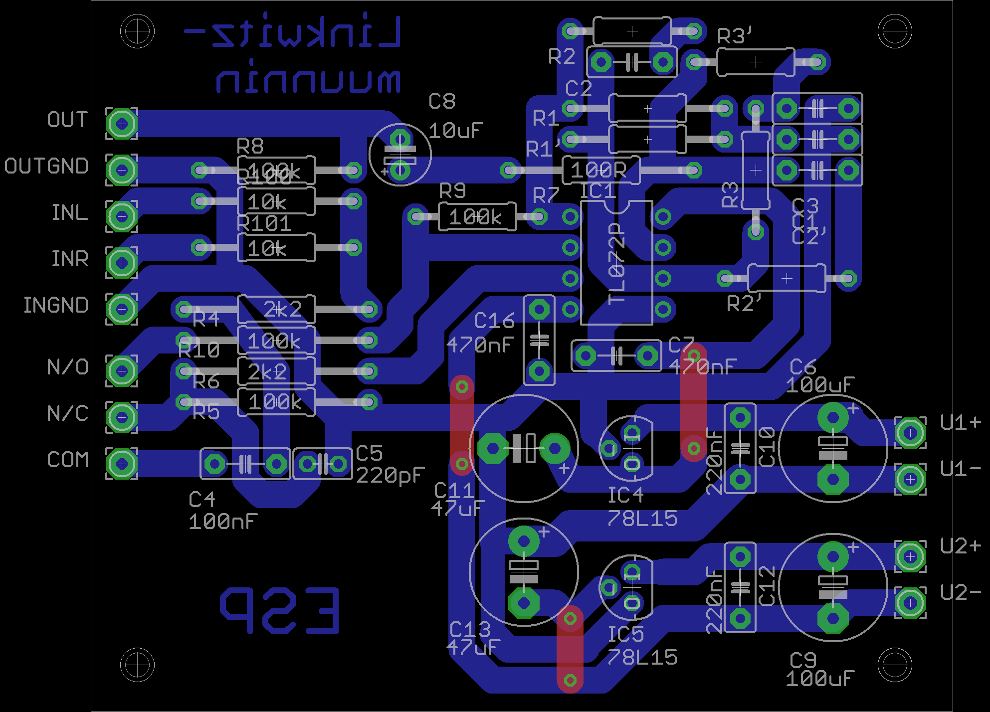

As you did not describe where this is to be mounted, let me assume in a stand alone box:
I like to mark drilling holes for mounting. I also prefer to put all the jacks on one side to make it fit in a box easier. For a board this small, I would be inclined to put the transformer, rectifiers, caps, and such all on the board. Why fool with point to point wire for the power supply? I would leave a tad more space between the lands.
Why are you using two positive regulators? I would use one positive, one negative. I would try not to have to use an output blocking cap. Doing tracking regulators could help that. It sort of depends on the amp it is feeding. If the amp has DC blocking, you don't need it here. I did not verify the circuit. I'll leave that to others.
Note, I have built these on perf board just fine. Point to point.

I understand there's a large number of audiophile-grade op-amp chips available, but since I see TL072 used in many DIY audio projects I'm inclined to think it would be a decent (and low-cost) choice.

Thanks for the suggestion to put all connections into the same side of the board, I made another version of the PCB where I moved the output into a different place. I also replaced the TO-220 voltage regulators with TO-92 models as the operating current of this circuit would be minimal (to my understanding in the range of 5..10 mA?).

The TLO-72 was a great op amp in 1978. Almost revolutionary compared to a 741 or 318. (very static sensitive though) I used many of them in my time. Please, the NE5534 is a far better choice for today. You don't need anything expensive like the LME4562, which is today's super chip.

Hi d1030180,
A trace width of .032"[.8128mm] should be sufficient, and make it much easier to look at the circuit.
The 072 is fine for this purpose. The 5534 has a higher output drive capability, and lower noise, for what it's worth.

Why 2 positive regulators???
Is one supposed to be 7915?

Looking at IC1A: it looks like you'll be loosing channel separation compared to Rod Elliott's circuit, and it will not be the same for the inverting/non-inverting configurations. Elliott uses the inverting summer configuration, which I would recommend.

I would add a ground plane and guard traces between input and output. And why use trough hole components? SMD is usually the way to go, shorter traces.. Personally I like the BB OPA2134 a lot, but as stated already there are plenty of capable opamps out there.
If you decide to put it inside the plate amp, there is a reasonable chance that you could pick off the supply voltage from inside the amp. It's likely to have a regulated supply for its line-level circuitry. Some plate amps have an internal split supply like +-12V that would be perfect.

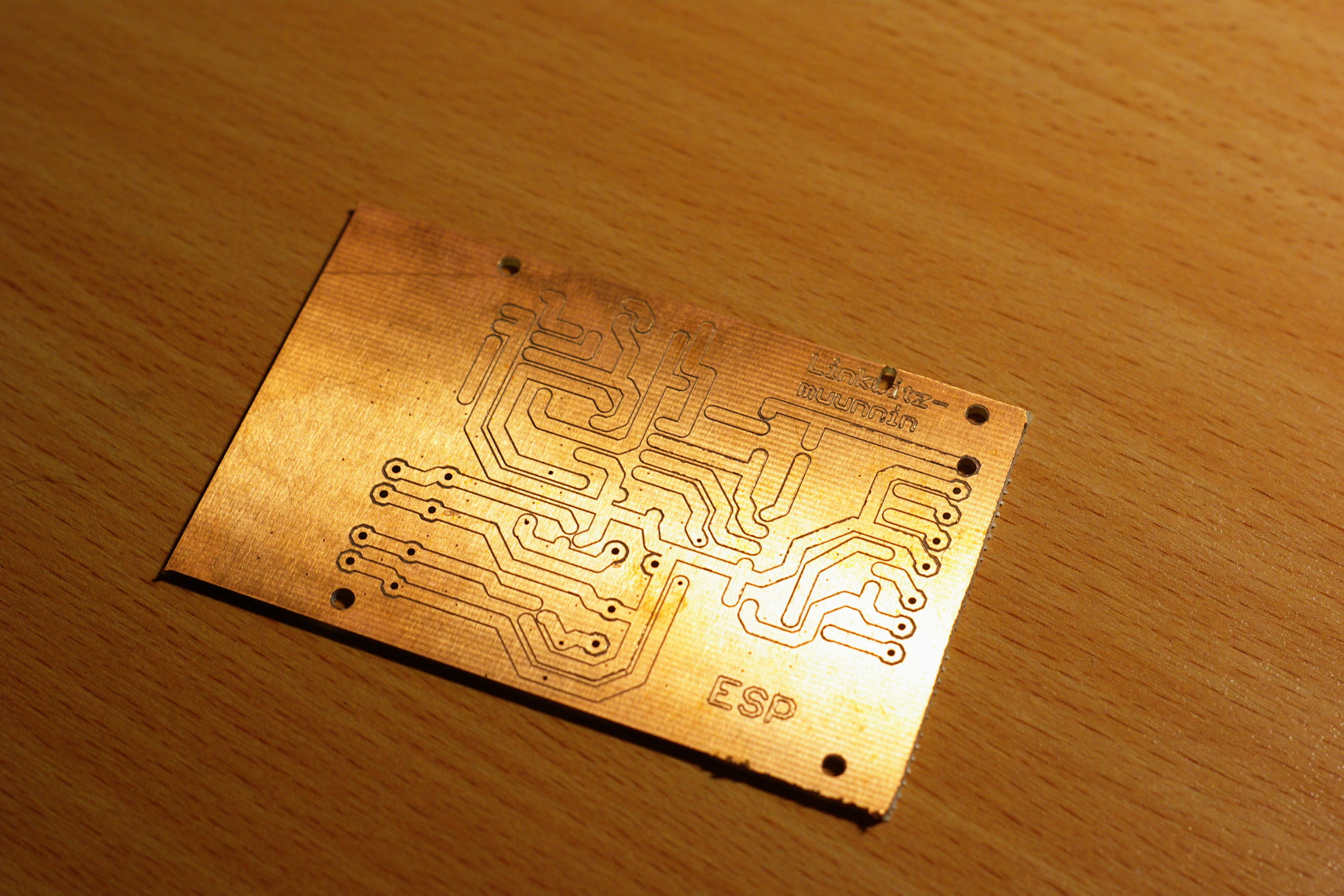

Thanks to my nice teacher I finished making to PCB for the filter. The milling machine made some mistakes in cutting the board outline and also left half of the component holes undrilled (most probably operator's fault).
Anyway; I can finish the PCB by myself using a 0,8 mm Dremel drill.
Perhaps it's just a photographic artifact, but it appears that the copper plate is a bit oxidized. You might want to remove that before soldering; otherwise the solder won't flow as well. You can soak it in a vinegar/salt/water solution, then thoroughly rinse in clean water after the copper becomes bright. Google for "chemistry with pennies" for proportions.
With your layout and fabrication, there will be a fair amount of capacitance between the various opamp pins, so start with an opamp that is fairly stable; don't go for a super high bandwidth one initially.
Enjoy!
Enjoy!
Enjoy!

I don't see any signs of oxidization on the copper layer but it has some fingerprints on it. Better to clean it with some cleaning solvent after I finish the drilling.

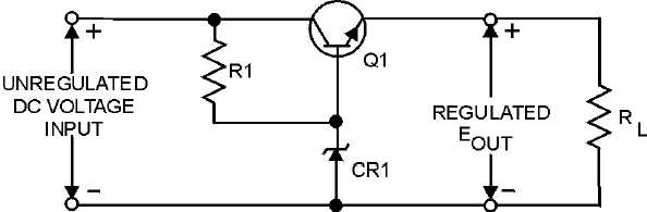

Also, I have measured the power supply rails on the plate amp. It has a double-sided supply of ±40 VDC. Unfortunately the maximum recommended input voltage for 78L15 is only 30 V. Maybe a simple series zener diode/transistor pre-regulator arrangement could be used to make the supply voltages suitable for 78L15.
Your pre-regulator will work, but the transistor might need some heat-sinking, depending on how much current you are drawing. I wonder if the power transformer might have additional taps for lower voltages? I would be a little surprised if +-40V is the only voltage inside the plate amp, as they usually have some lower-voltage circuitry for auto-power-on and the like. But maybe not.
There exist linear regulators that can handle more than 40V, for example MAX5023/5024, LT3012, LR12, TL783. Some semiconductor companies are pretty good about giving you a few free samples. TI is certainly very generous in that respect.
Actually, the venerable LM317 (positive) and LM337 (negative) adjustable regulators can handle an input-to-output differential of 40V. If you want to run your rails at +-15V, the differential from 40V is 25V, well within the limit.
