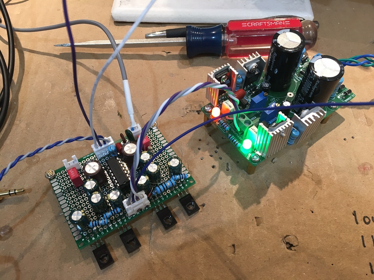

I built up one channel of the ESP HPA on veroboard with an LME49740 (will use two chan of a quad). It oscillated badly at first. I had to add a 680pF input low pass film cap filter to block RF in, I added output Thiele 100nF film and 4.7R (which also blocks RF feeding in from headphone cable), and added 33pF silver mica across 22k feedback resistor. Probably had a lot to do with P2P layout as Elliot warned about if doing in veroboard. It's stable now and plays music. I am not sure what the bias is supposed to be but quiescent is very low at 2mA. When it was oscillating (400kHz and 8v p-p), and bias measured 150mA.
I built it according to this circuit (I using nice Silmic II 100uF for C2, and 1uF 63v Wima MKS on C1):
Now stable, no input, output measures 0.0mVac on Fluke 101 and 115. But if I turn volume up on my preamp (Focusrite 2i2 DAC), the Fluke 115 (true rms) will show increasing noise - hiss amplified from DAC. But even at 0.0mV it is not dead quiet on headphones. On scope, I can still see about 4mV of high frequency hash. Not really audible when music playing, but not dead quiet like my SE Class A discrete headphone amps that I am used to building. I wonder if this is opamp noise? This LME49740 had very good noise specs though.
Anyhow, listening to it in pseudo stereo and sounds decent. Just puzzled by the low quiescent bias current - is that normal? If I want to turn this to Class A with 120mA bias current all the time, is it as simple as changing 10R emitter resistors to smaller value (maybe 2.2R?).
Actually I want to use this not as a headphone amp but a powerful instrumentation amp where I need to have low distortion signal to drive a sensor. Having a simple push-pull pair of BD139/140's seemed to be a good way to give an opamp some muscle.
You will recognize that I am using the shunt regulator (nice PSU) from your Juma BJT HPA project. :)
Here is a photo showing amp with just left channel wired up (components are in place on right but no wires connected yet).

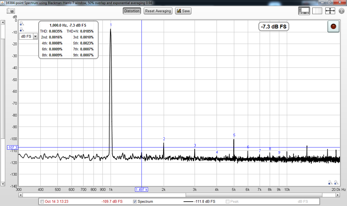

Here is quick FFT driving 700mV into the on-board 4.7R/100nF (Thiele) load. Not bad, but has some elevated 5th harmonic. Dominant 2nd is nice to have rather than 3rd.
attachment.php
I think bass authority could be improved if we change those emitter resistors to smaller value. But in general, probablyI agree with your choice to add input filtering,and output Thiele. It would be good idea to include a feedback compensation capacitor pad in parallel across R4 for a 5mm pitch silver mica (circa 33pF) But looks like a worthwhile PCB layout and certainly I would use it if you finished the layout. Thanks for doing this - the circuit actually sounds surprisingly good for how simple it is.

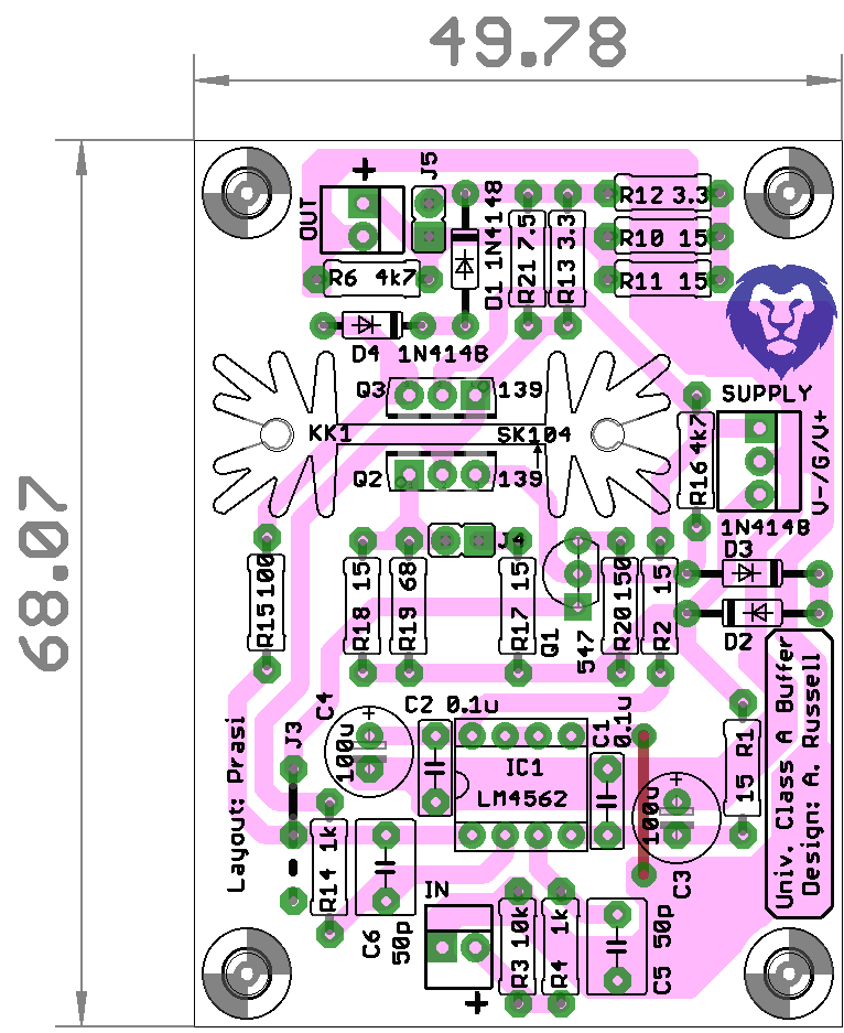

Just a rough layout to see if single sided is possible..I know you only need diy friendly PCB's.
So here it is, I will refine it a bit further and post pdfs.

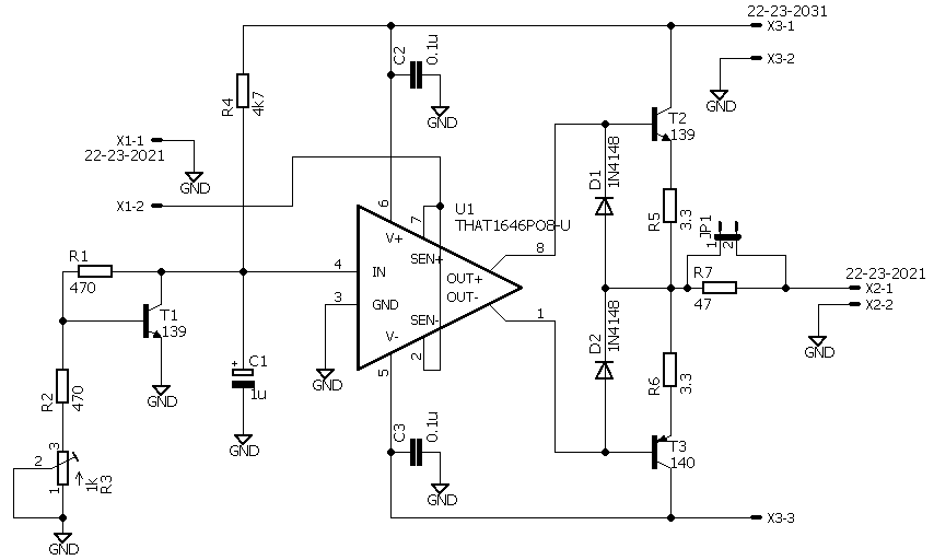

I have another one for you that is similar to the title circuit but is Class A and uses a very low distortion THAT differential input driver. It's a clever way to control the bias too. I think Kirkwood is a designer from THAT Corp? If you have time, pllease consider making another layout.
Thanks,
X
attachment.php

here are the files. also attached is his website document (linked by him) for convenience.
regards
Prasi

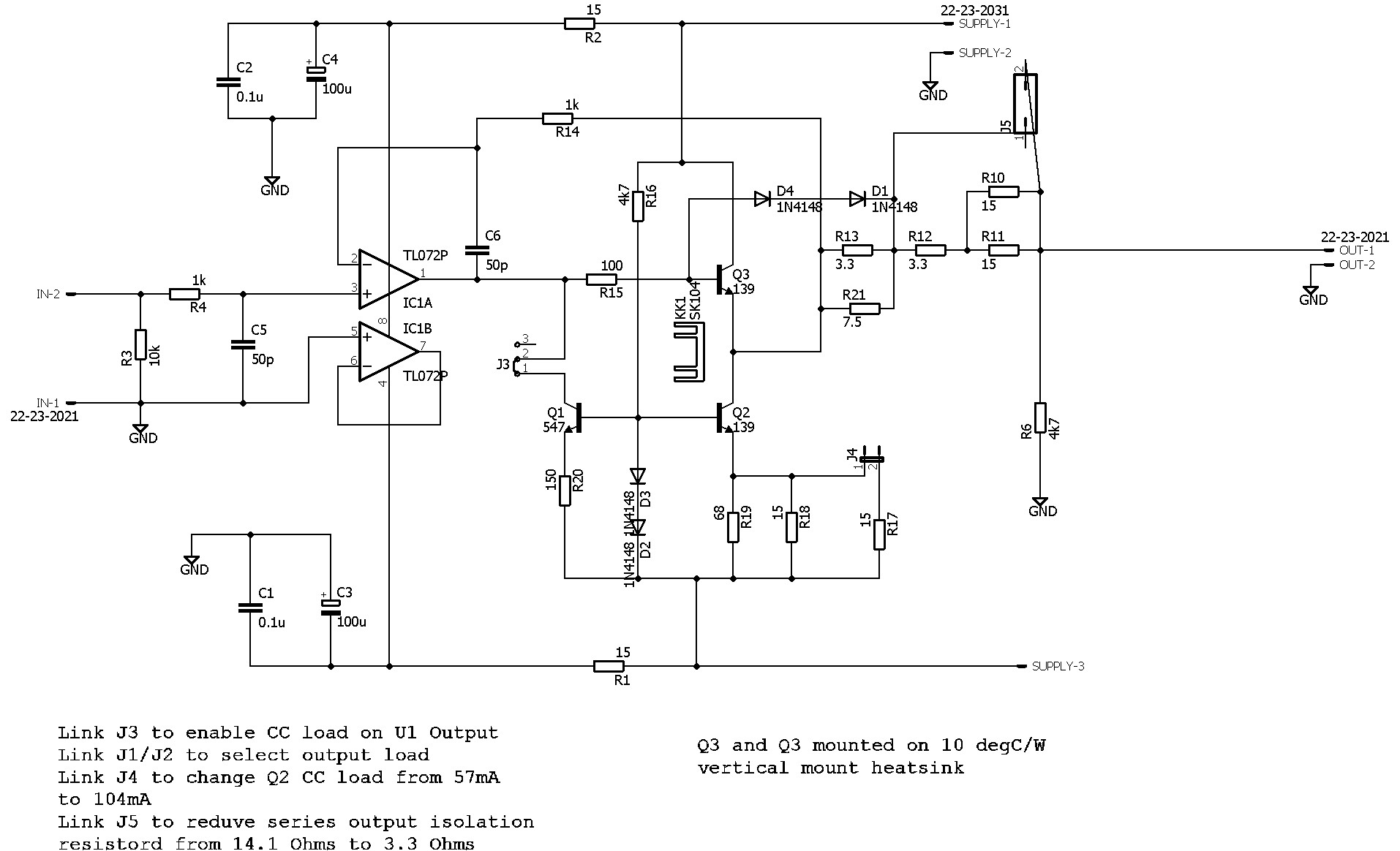

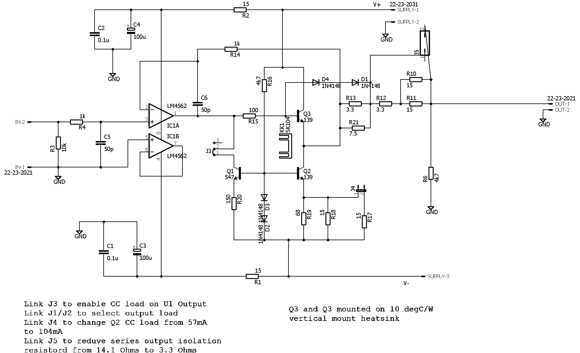

Hi Prasi,
Thanks,
X
640861d1508309176-esp-hpa-img_6310-jpg
can you pl confirm sch? I might have misread it and I have a very different symbol or 1646.

Hi Prasi,
I am not 100% sure but the notes say that the differential input is used to set bias, and the common mode feedback is used for the signal, and the amp runs open-loop (zero global feedback) so it is a different implementation than the usual opamp driving a push-pull stage. This is actually very clever and might make a nice ZGF Class A amp.
Here is the data sheet for anyone interested. Perhaps the way to really check if this the case is for me to vero board it. My 1646 is an SOIC8, but luckily I have a DIP8 adapter board.
http://www.thatcorp.com/datashts/THAT_1606-1646_Datasheet.pdf
For now, I would redraw the schematic per the drawing pin outs.

Hi Prasi,
Thanks,
X

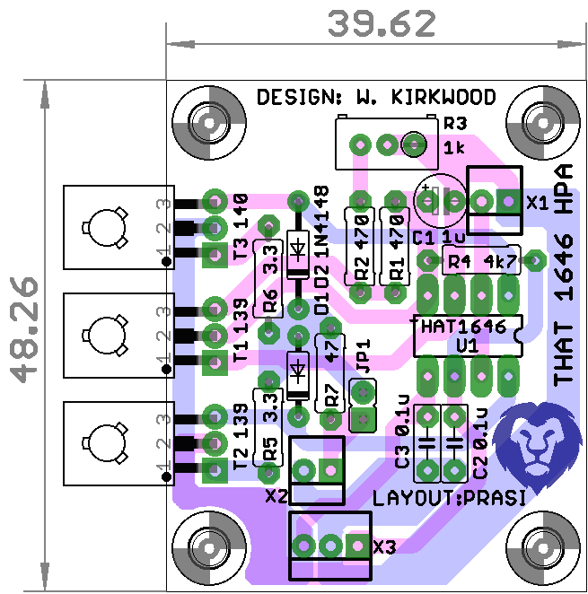

here is a quick 50x50 layout
Founder of XSA-Labs
Joined 2012
Thank you, Prasi. Looks very nice and love the tiny 50mm format. One thing though, I think T1 is a big BD139 because it needs to match the output as close as possible to be a Vbe multiplier for temperature compensation. Thus, I think T1 need to be on the same heatsink as the two outputs, preferably in between the two. That may require some work though and if you are not up to it, I can use flying leads on T1 to relocate it to the main heatsink.
mounting all BD's inline would result in something like this:(.
