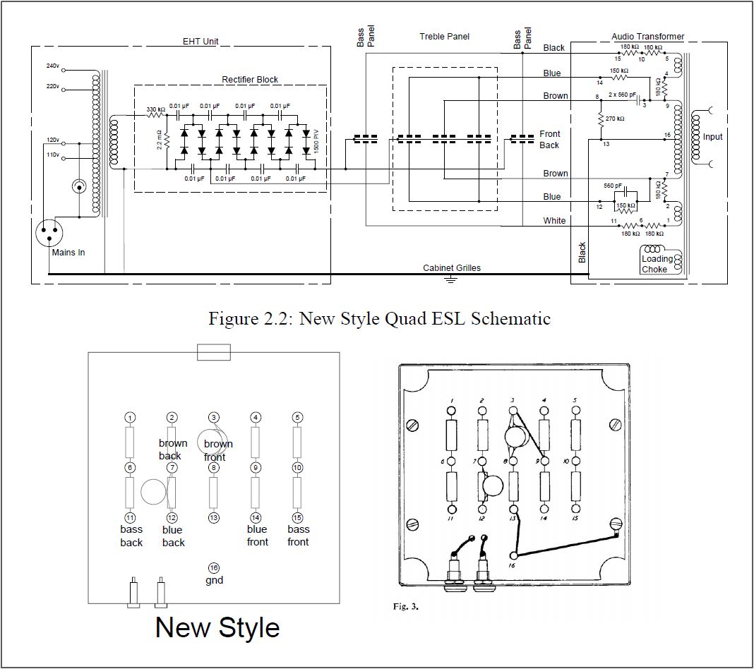

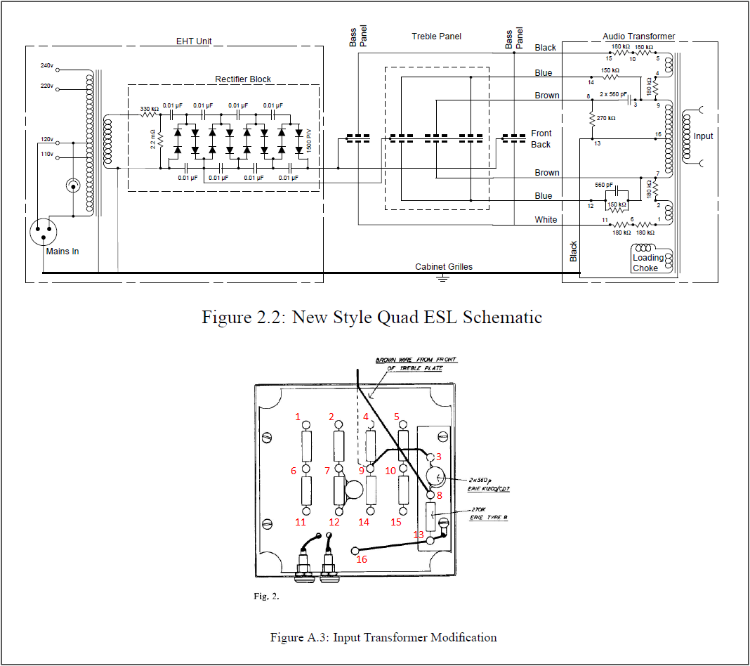

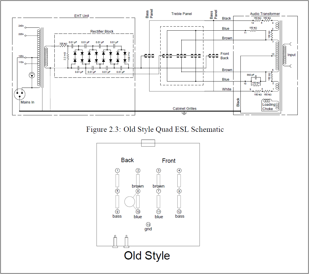

Attached are some combined images from the book you may find helpful.
The first image is one I had numbered the posts of the modified 12 + 3 configuration you have to correspond with the later circuit.
The other 2 images are just the earlier 12 post and later 15 post configurations.

Thats perfect!, that clears up the post numbering and the schematic clarifies what goes where. When it comes to wiring ',ve researced different opinions on what wire to use, currently I have 600v hook up wire 18 swg in the correct colours. Is this ok or should I be using a higher rating, I have 14 swg 10k for the EHT block.
