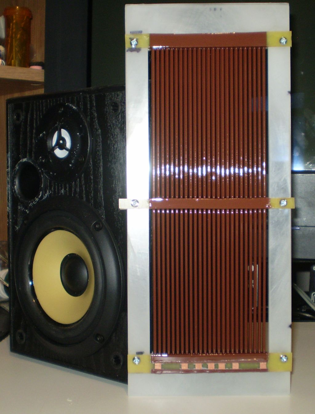

Below is a picture of the latest build that I mentioned.
It is a desktop version and is only about 10" tall but it is also electrically segmented as well.
