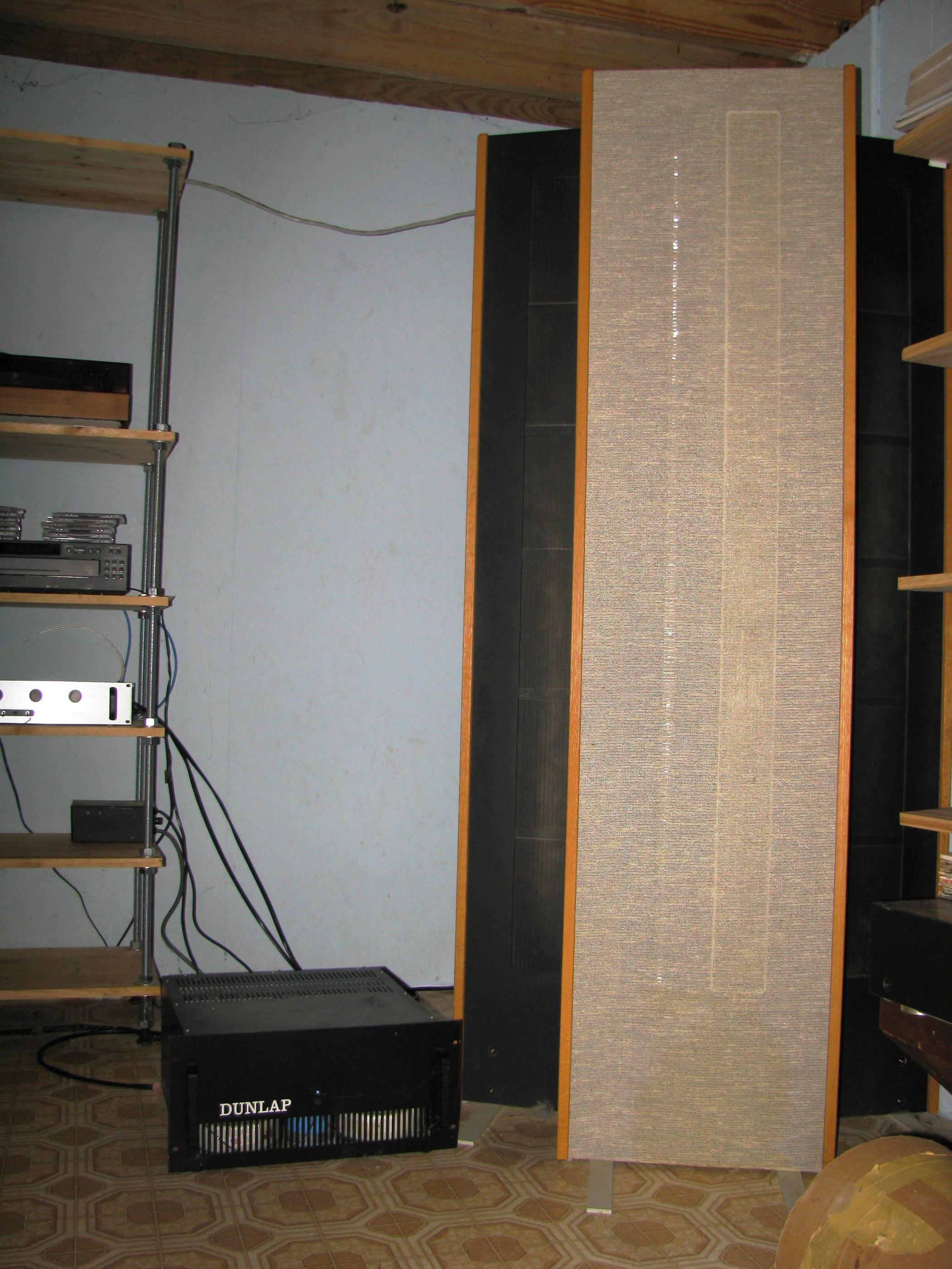

It doesn't look all that impressive to me, but I have been living with it for many years. I no longer take pictures as it is too difficult for me these days. My speakers are Magnepan T-4As being driven by a pair of 1200W mono blocks. I have removed the fuses for the speaker mids and tweeters as I don't worry much about the amps clipping.
Steve doesn't take pictures - but that doesn't mean that there aren't any laying around! :devily:
