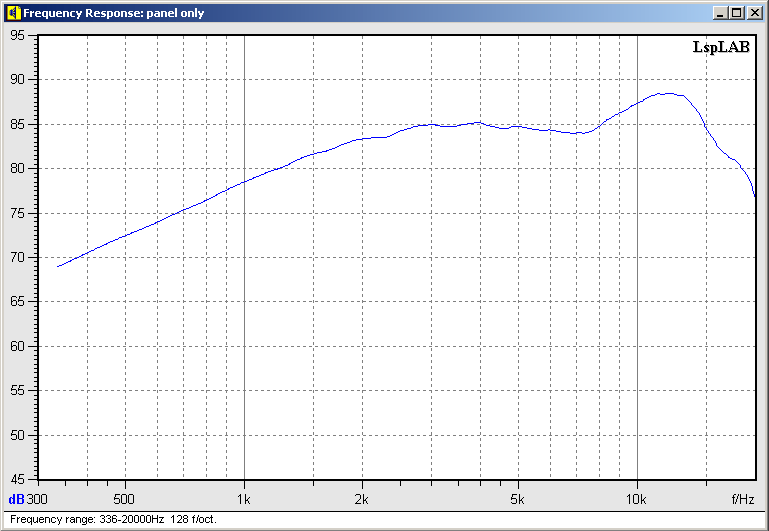

On diy esl designs I've seen the speaker start rolling off at around 15khz.
http://www.quadesl.com/speaker/minimite/measurements/panel_response.gif
What can be done to prevent that?
Thinner spacers? but they limit lower frequency reproduction.
Smaller subdivisions? the Fs goes higher
Or how thin the diaphragm needs to be?
Or how about equalisation?

The graph I posted was taken from www.quadesl.com simply to demostrate the roll-off at the 15khz+.
Anyway, What I was thinking to do is a 100cm x 30cm panel, to be able to cover from 500hz to 20khz.
And I was not sure of how this kind of relativly small panel would cover down to 500hz (at somehow nice spl's) whitout compromising the response up to 20khz.

the top end response of electrostatics is dependant upon many factors....hole size and depth in the stators, diaphragm mass, and transformer design to name a few.
An excellent reference book to read up on all of this is the "Loudspeaker and Headphone Handbook" edited by John Borwick. ISBN 0 240 51371 1
It contains a chapter written by Peter Baxandall, a life long friend of Peter Walker and is the most comprehensive treatment of electrostatics published.
It is not however a practical guide to DIY.
