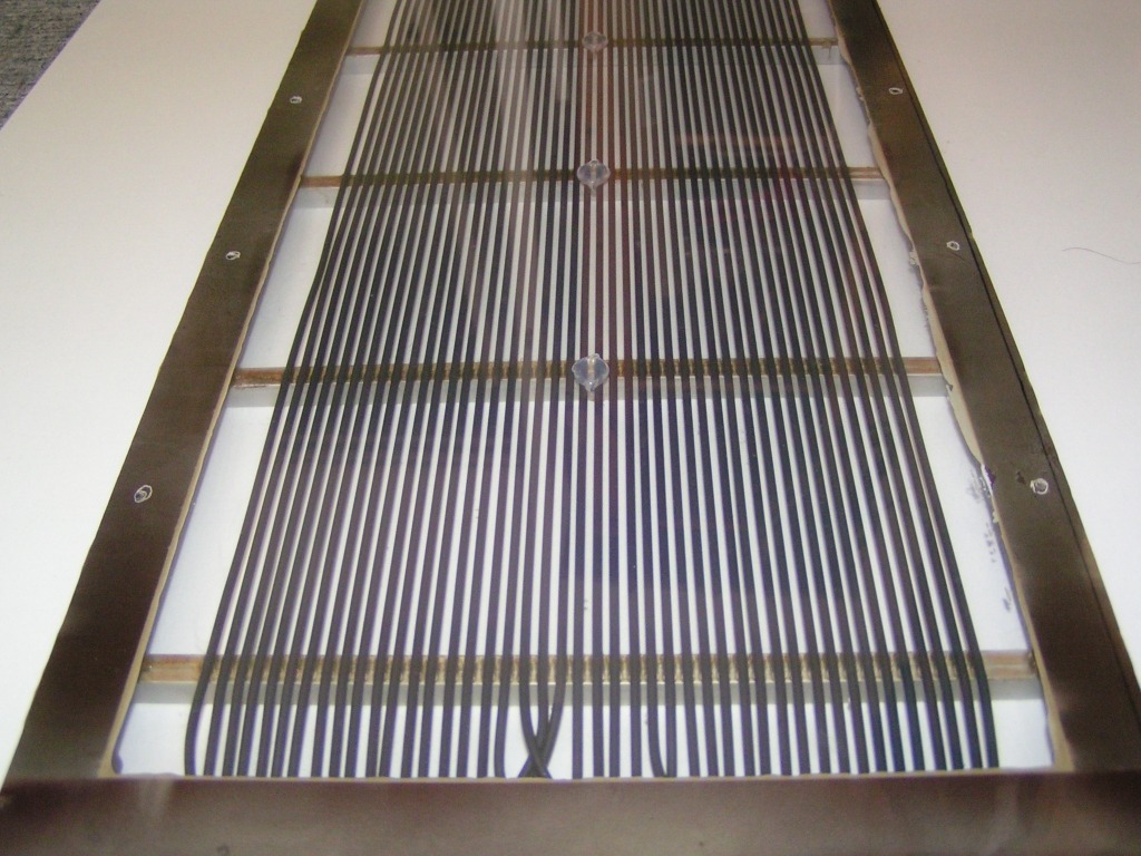

The panel works well when it is powered (2800Volts), without making any noise, it is only when I cut the mains supply that it generates noise for about 2mn without there being any modulation.
But you're right, I'm on the limit when it comes to width.
I based myself on Pierre Frank Jensen who uses the same specifications.
http://steenfrankjensen.com/projects/electrostatic-loudspeaker/
I've also used an antistatic spray which isn't Licron and I think it could cause problems, so I'm going to rebuild a panel with 6 micron mylar and maybe increase the D/S to 2 mm.

The Pierre Frank Jensen design uses a 3 mm membrane to stator spacing according to link. That would be more in the ballpark. Although 3 mm is pushing the limits of drive voltage requirements. And for a panel that only operates down to 300Hz, there is no need for such large DS or for such a large panel.
I would build the next panel not as wide, maybe 150mm. You can increase the frame width left and right of the panel so the total width stays the same, that will maintain the same frequency where phase cancellation sets in. With a 1:100 transformer, there is enough drive voltage to increase DS as well. As a bonus, capacitance will be much lower making things a lot easier for the amplifier.
Just to give an idea, I play with a panel that's 20 x 100cm, it plays down to 100Hz where it is crossed over to a dipole sub. It will even play fullrange with enough output for a small room. DS is close to 3mm, bias 5kV.

Maudio, following your advice, I'm going to glue two 0.5 mm thick wooden edge strips around the stator, which will give a D/S of about 2.5 mm. I could keep the width (2.5 mm x 100 = 25 cm)?

Should work yes. And you can always play with the bias. Or add extra support for the membrane. Audiostatic uses silicone dots on each crossmember, in the middle of the membrane. It also helps to spread the fundamental resonance.
Before you tear down your current panel, try feeding it a frequency sweep. That will tell you where the resonance is, and it will tell you when the membrane touches the stators. That will make a very loud rattling noise. Start at 20Hz and sweep to a few hundred Hz
Your panel d/s is 1.5 mm and the width is 25 cm. Is that correct?
What caught my eye in your panel photo is that I don't see any center diaphragm supports-- at least none are visible.
Roger Sanders "Electrostatic Loudspeaker Design Cookbook" provides a guideline for diaphragm stability, which insures that the diaphragm will not be pulled into a stator by the recommended bias voltage-- or too-easily driven into to a stator during music playback.
Sanders' guideline states that the span between diaphragm supports should be 70-100X the d/s. Most builders follow this guideline.
A span less than 70X d/s would merely give up some efficiency, but a span greater than 100X d/s would not provide sufficient diaphragm stability.
With your panel d/s being 1.5 mm, the span between diaphragm supports should not exceed 15 cm.
In your panel photo, it appears that the diaphragm is spanning the full 25 cm width of the panel with no center supports.
If that's true, the span is excessive, and that might explain why you are still getting static after reducing the bias voltage below 3KV.
You noted that you patterned your panel/segmentation arrangement on Frank Steen Jensen's excellent speaker and website.
As the d/s is Mr. Jensen's panel is 3mm, the diaphragm span in that case would not exceed Sanders' 100X d/s limit.
If the diaphragm span is the problem, there may be simpler fix that redoing the panel. Many wire-stator ESLs with wider panels stabilize the diaphragm with a line of silicon dots (locally bonding the diaphragm to the wires) spaced a few inches apart along the mid-span of the panel. Think of the silicone dots as tent poles that keep the tent (diaphragm) lofted away from the ground (stator). A Google search would probably find some photos of this arrangement. I think builders who use silicone dots in lieu of spacers just get a tube of clear RTV and squirt some in thru the spaces between the wires.

Hello CharlieM,
Thank you for your reply, I made a mistake reading Frank Jansen's site, you're right I'm going to reread Sanders and Wagner's book (which I haven't opened in 20 years) so as not to make any more mistakes.
Silicone dots would be a good thing, but I'd rather go back to a 2.5 mm D/S panel + 6 micron Mylar + Licron, I still have the materials to do it.

Hello SB,
Yes, I think you are right-- the silicone dots may have worked but once done, it would not be possible to disassemble the panel again without bending the wires at the dot locations.
Increasing the d/s as you suggest would be the best fix, and that would also allow going back to the higher biasing voltage to offset the lower drive force.
One more tip:
Your post didn't mention whether your stators are mechanically fastened together or bonded with adhesive tape.
Prying bonded stators apart can be tricky and risks bending the wires. An safe method to separate bonded stators is by cutting thru the tape bond lines using a string saw made from 60-80 pound braided fishing line.
This works quite well (I've done it).
That depends. When you place the dots behind the horizontal supports, disassembly is no problem at all, no risk of bending the wires. This is in fact how Audiostatic does it, I rebuild several pairs without ever damaging the wires. After removal of the old membrane, the dots that stick to the wires can be peeled off by hand. After placing a new membrane, I use a syringe without needle to place the new ones. The small tip allows me to inject the silicone between the wires. When you do so with the panel flat on the table, membrane facing down, it will form a nice round dot that is easy to control in size.
That's good to know. I was concerned that it would be a problem, but apparently not when implemented as you've shown. Thanks for sharing that!

It was a question I wanted to ask you, as my stators are glued as you indicate on your site, you've beaten me to it.
I'm going to try and find some fishing line.

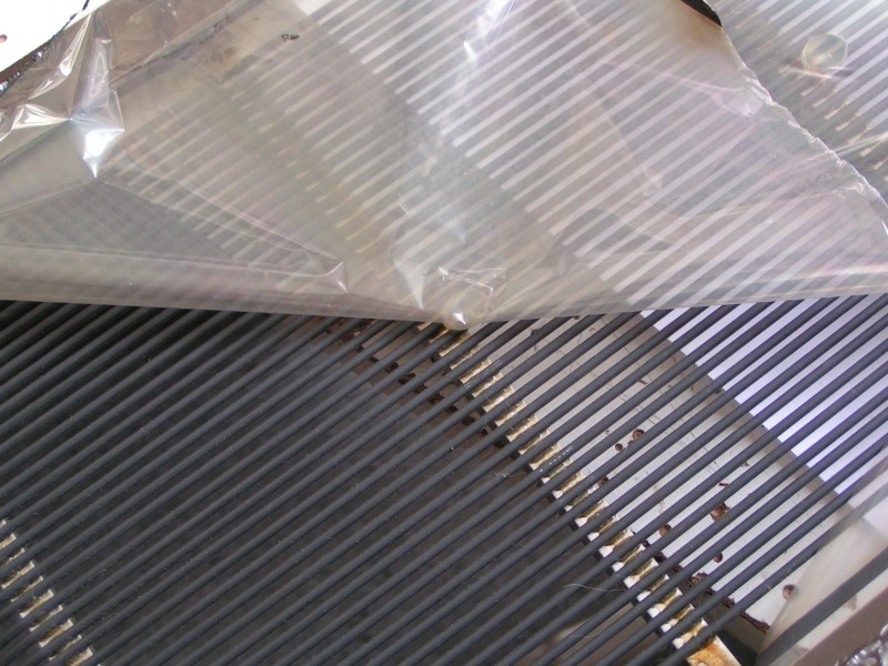

The saw thru part will be easy. Removing the adhesive residue from the stator edges afterwards will be a pain. No solvent that I know of will dissolve it but acetone will soften it and allow you to roll it off in bits and pieces -- no fun!

I finished modifying the stators to 2.55 mm D/S with double-sided tape.
I glued two strips of 0.5 mm wood (1 mm thick) around the perimeter of the stator and used 6 micron Mylar and high tension.
The crossover will be digital (ADAU 1452 Analog Device), LR4 for the woofer and panel.
Thanks for the advice.
Serge B.
Hello,
Just to keep you up to date with the modifications you advised me to make:
The D/S was increased from 1.5mm to 2.6mm, and I was able to increase the bias voltage to 6000 volts without any noise problems.
Should I keep this voltage or lower it?
Thank you all for your help.
Serge B.
Serge B.
