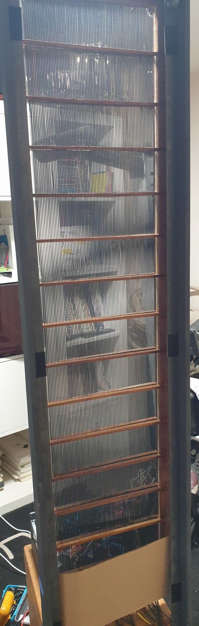

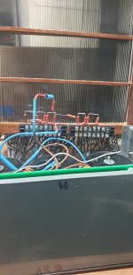

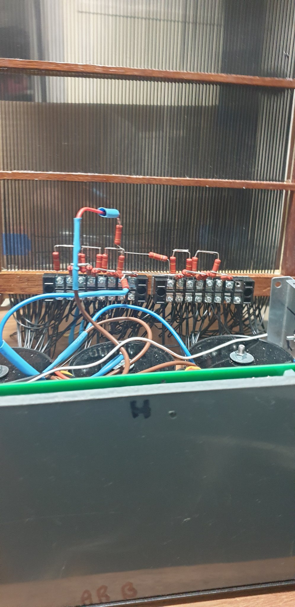

Can you post some pics of the panel and bias supply board and segmentation resistor connections?
Hello ChatlieM,
The files Panel+resistances + power_supply.
I recorded the noise but I can't put the file on diyaudio.
Nice build!
You can zip the audio file, zips are allowed. Not sure about file size though.
I see you use wooden supports for the stator wires. Are these stiff enough? The panel is quite wide. If they flex too much, that could be another possible cause for the distortion you mentioned. The forces are quite substantial at higher volumes.

The stator is made of "Iroko" wood, triple impregnated with epoxy resin diluted in : 20%, 10% 5%. The wood is very rigid and is used for boat building.
Noise occurs without a signal and with a signal there is no noise.
The stator is CNC machined and the horizontal bars are grooved to insert the stator wires 1.5mm deep.
