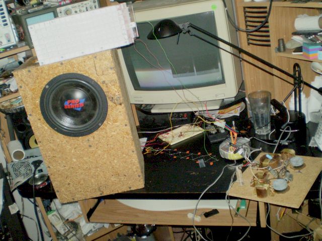

My panel size (diaphragm) is/was 3.25" X 9.75" with about 5/8" border for the frame.
I was using white and pink noise as well as sine test tones for my measurements.
Yes, I know that those were extreme voltages and it was quite exciting when the panel exploded but very depressing at the same time.
Luckily the are cheap to build!!!
The goal of my little experiment was to prove that there was a 6db increase of the sensitivity for every doubling of the bias voltage.
I was able to run as much as 10kv of bias at normal levels <95db quite well the way the were.
But they were right at the edge of breakdown and I spent more time taking them apart trying to fix the leaks than I spent listening to them or just building a new ones like I already have done here,
A Segmented Stator Desktop ESL
The second goal was to see how high of voltage I could go with the coatings I had used at the time when I made them back in 2003.
Some deterioration had set in through the years and had weakened them a bit.
The did surpass such DC voltage tests of about 15KV or more when I built them.
Although I didn't have any means to accurately measure such voltages at the time, as it was calculated by how many stages that I used in my voltage multiplier and its input voltage.
Also the length of the arcs it produced was a good positive indication as well as to how much voltage was being produced.
I did for about 10 to 15 minutes in 2010 have had about 25Kv to 30Kv p-p across the stator's the First time they blew up.
And I kept trying to fix them to do it again ever since then.
This was after I First fired them up again after they were laying dormant for the last 7 years.
I have explained this several times in other threads.
The whole goal was to find what the limits were, and, How to improve them to get every last bit of efficiency out of them since they are small panels and don't have a lot of surface area to start with.
When I First fired them up, I struggled to get any sound out of them at all and thay were blown away by the 8" sub that I was using at the time.
So, My goal became "What does it take for them to have an equal efficiency with the woofer I was using".
Since they had three times the area and a capability of at least 3 to 4 times the Xmax of my dynamic midranges, they should at least match their performance if not surpass it.
So I kept pushing them until I reached my goal!!
Therefore my measurements are something that can be compared too, and, they do come very close to what the ESL calculator predicts as well, Much to my amazement!!!

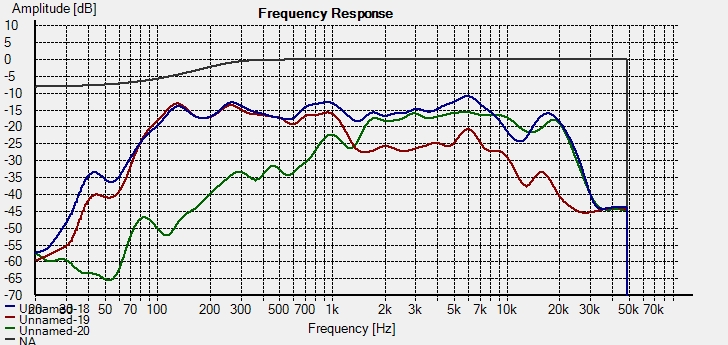

Electrostatic Loudspeaker (ESL) Simulator

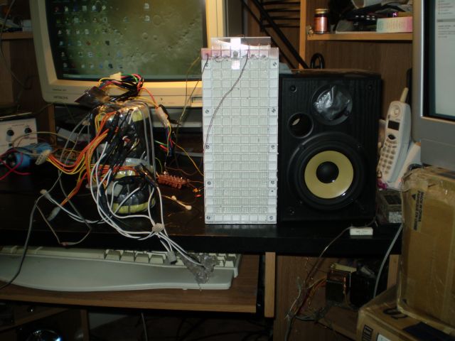

The First Two pictures are of the very last setup when it burned for the last time and the actual calibrated frequency response of the combined and individual drivers.
No particular crossovers were used and it was biamped.
Only the shelving filters on my mixer was used to EQ the setup.
Also I was using both channels of my Awia CD player amp that I used during my transformer study back in 2010.
