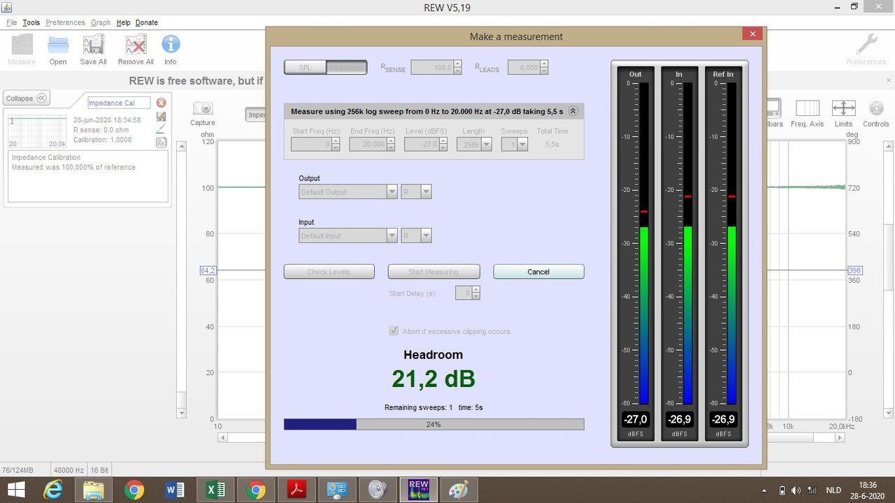

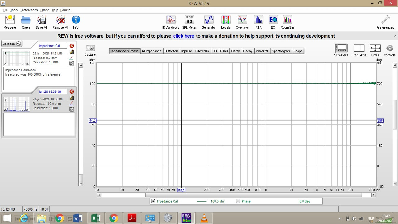

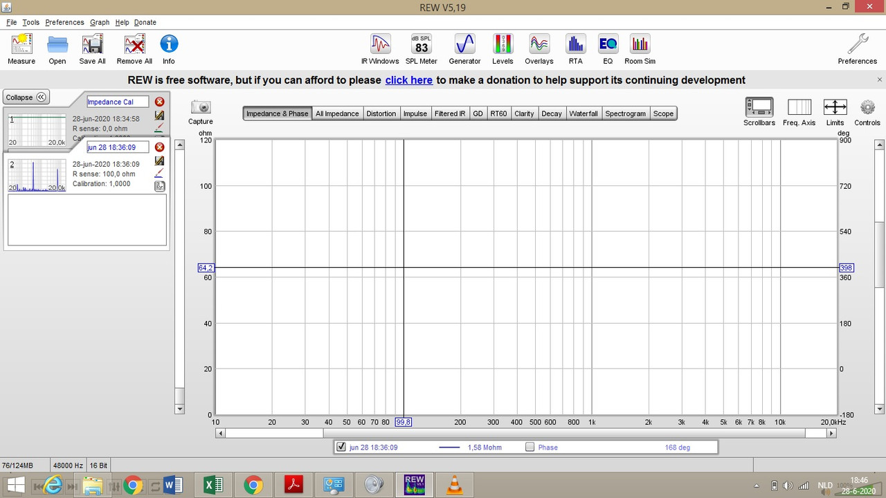

Hi, thanks for your suggesions! I just tried to do an impedance measurent, but unfortunately I ran into a lot of problems. On my mac it didn't work at all, but on a Windows laptop I got some bad measurement results: although I selected the USB audio codec as input and output, and I did a callibration beforehand, I still got unreliable results: impedance values of 1.58 M-Ohms. I attached some screenshots and a picture of my gear. It looks messy, but I used this scheme: https://www.roomeqwizard.com/help/images/impedancesetup.jpg
I used a 100 Ohms sense resistor and I used a 0,33 Ohms load resistor.
First I used the headphone output, but as this didn't work I tried the RCA output instead - also with bad results. Do you have any idea what could be wrong? Should I try the asio driver instead? Is there an error in my hardware scheme?
Not quite sure what you did, but the impedance is based on a large resistor (say, 200 Ohms) in series with the device under test (say 70 Ohms or 2 Ohms). You are trying to see the reading you get across the little resistor (and later, substituting the speaker for the little resistor).
With my empirical method, there's no calibration. You just want the FR to register in a useful working band. The 70 and the 2 are your benchmarks. Then you plot all the curves together on the REW screen that puts various curves on the same framework.
Your headphone output should work OK. Unshielded alligator clips leading into your DAC are also OK if the load is just 70 Ohms or less.

For best fidelity of impedance measurement, you would use an amplifier with a 10ohm or lower sense resistor. I have also had good luck with a 47ohm sense resistor when using the headphones output. Make sure you have the mechanical volume control for the headphones on the unit turned all the way up.

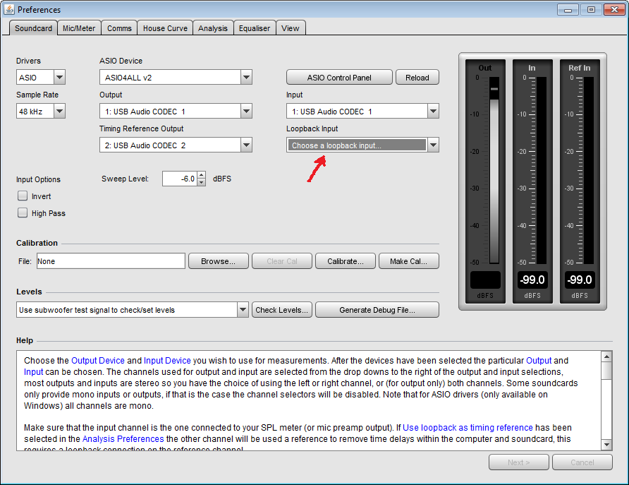

But, before optimizing your setup, you can work with the Lineout setup that you have wired up right now. For easier troubleshooting, I would recommend a higher load resistor than 0.33ohm …something in the 4 – 10 ohm range to avoid confusion with wiring resistance.
First, check your Preferences to make sure you have something selected for both the Input and the Loopback input. My guess is that nothing is selected for the Loopback. (see Pic #1) The channel that is selected for “Input” on the Preferences window should be the same one you choose as Input on the Impedance measurement window. This is the channel that will be connected to the junction of the load and sense resistor. Note that if you change channel selection on the Impedance window, sometimes you have to go back to the Preferences window and reselect the Loopback input…always good to double-check the selection before Calibration or measurement.
When taking a measurement, you should always see the “In” Level to be lower than the “RefIn” level since there is a voltage drop across the sense resistor. (see Pic #2) If you see “In” level higher than “RefIn” then you need to swap your input channels, either physically, or in the software on the Impedance measurement window.
Hopefully these few suggestions will get you reasonable results for measuring components with known impedances. Once you get that, then you can move on to measuring your ESL.

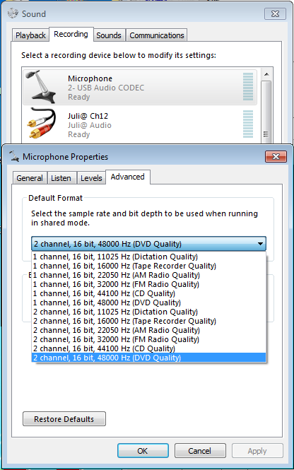

… I selected the USB audio codec as input and output
I just realized you are probably not using an ASIO driver option like I am. For reference, I use the ASIO4ALL universal AISO driver with the UCA202. If you are using the Java driver and select the USB audio codec, you might double check the recording mixer panel to make sure the USB microphone is set up for 2 channel operation. Often the default is set to 1 channel. In that case, REW would be receiving the L channel information for both the L and R signals it uses and you could get the high impedance results like you were showing.
Hi, thanks for your quick and helpful responses! I tried the two channel option as well, but I remember getting no input measurement in REW at all after selecting this option. I will retry that option again and also check the other options like the ASIO4ALL driver, checking the loopback channel etc.!

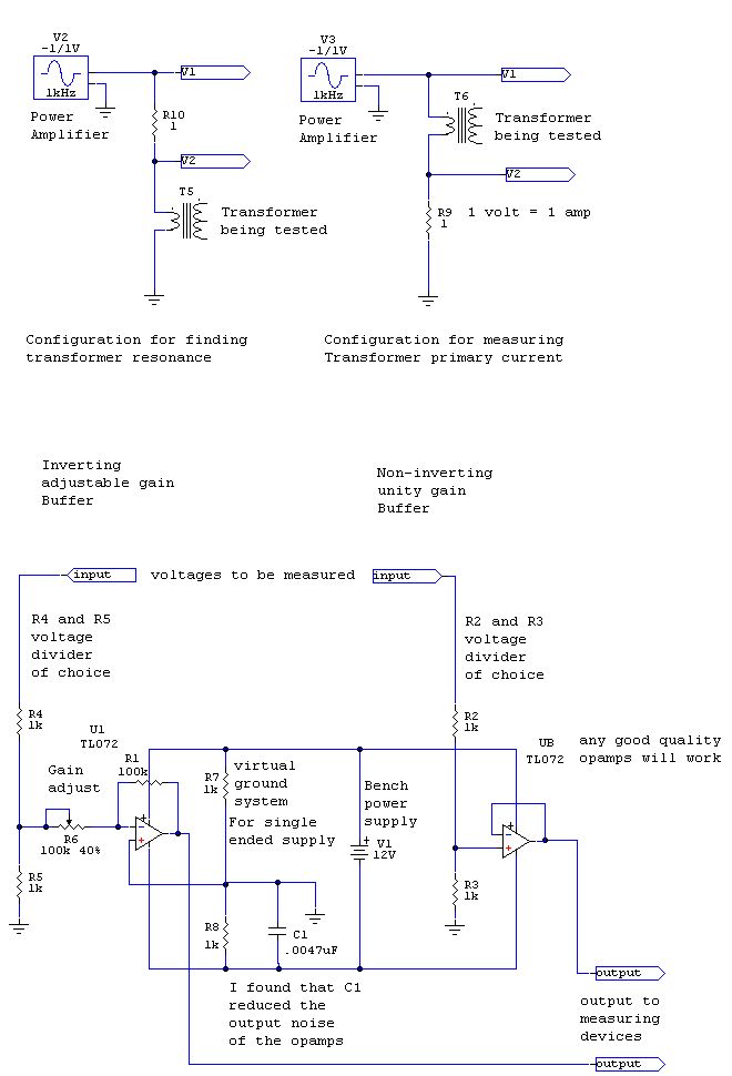

Here is Version 1 of my test jig,
Step-up transformer design
Attached is a detailed sheet of my test jig. :)

P.S. to save time here is the link to the impedance jig I use. :)

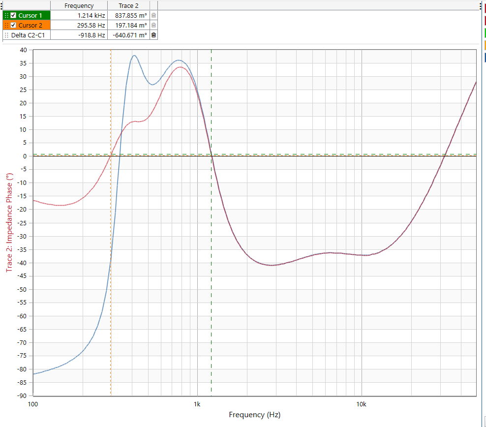

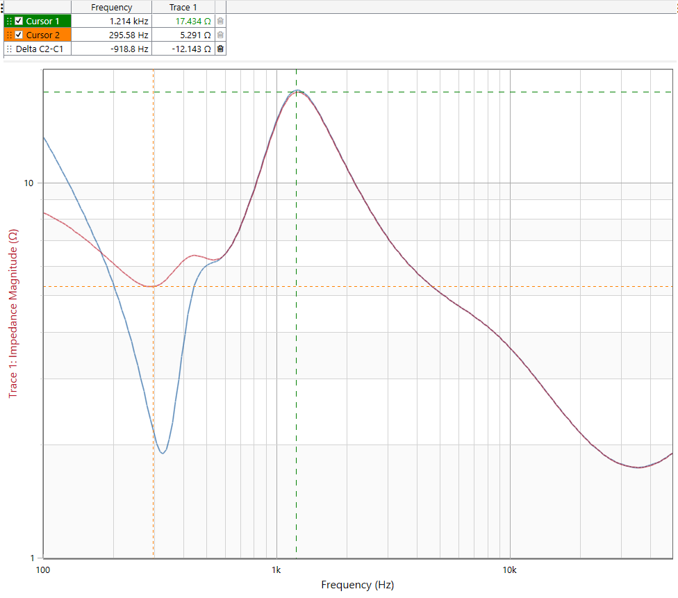

As much as I hate to admit, Paul was right: with the woofer connected, through it's own xover, the imput impedance of the combination now stays above 5R. Without the woofer it dipped below 2R.
See attached graphs, blue without woofer (I used an 8R resistor as 'woofer' for the measurements).

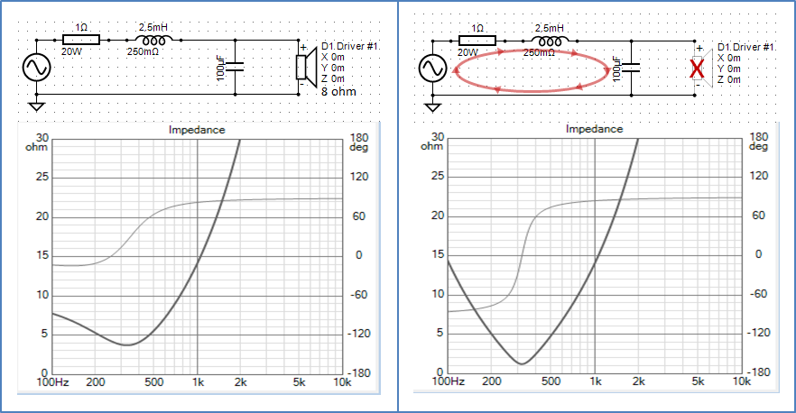

Missed it on first reading: how can the impedance be higher with the woofer connected? Isn't the woofer in parallel with the tweeter? Can you educate me, please.
B.
If you look at the woofer crossover, you can see that if the woofer is removed you are left with a series resonant circuit. At resonance the impedance will dip to the series resistance of the circuit loop which in the attached example is about 1.25 ohm. Adding an 8 ohm load in parallel with the capacitor provides some amount of damping, thus increasing the impedance at the resonance frequency. Of course below resonance the impedance is reduced with the added 8 ohm load, in line with intuition.
This behavior is seen with most 2nd order crossovers(HP or LP) when measuring without a load, unless the series padding resistor used for level matching is of a high enough value to mask the effect.
