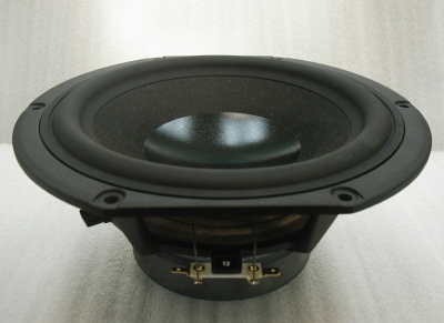

Rob mackinlay from ER-AUDIO will be introducing in a couple of weeks his new Isobaric subs. They won't be clamshell design, the will have 150w plate from Switzerland and a pair of peerless 8" XLS (custom version/not absolutely sure)-see pic. They will have 25 hz in room response with a bit of equalisation... Their crossover will be 180hz. Also he will introduce the ESL IIIb, the flat version of the ESL-III and the Acorn ESL which will have 60% biger diaphragm surface than ESLIII. A have the pictures of their prototypes from Rob, but I don't know if he wants them to be on the net yet
What do you think Steve M about these subs (pair)?.
