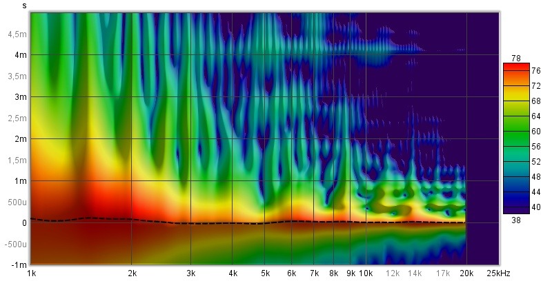

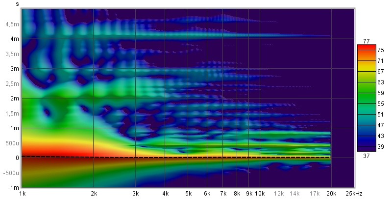

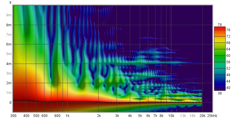

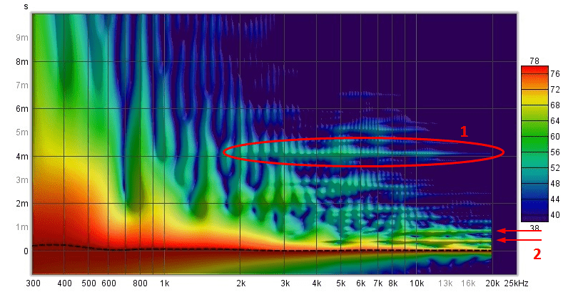

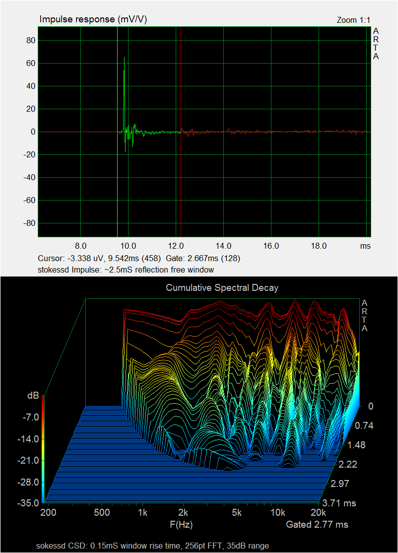

Thanks for those additional plots showing more clearly the < 1mS HF reflections.

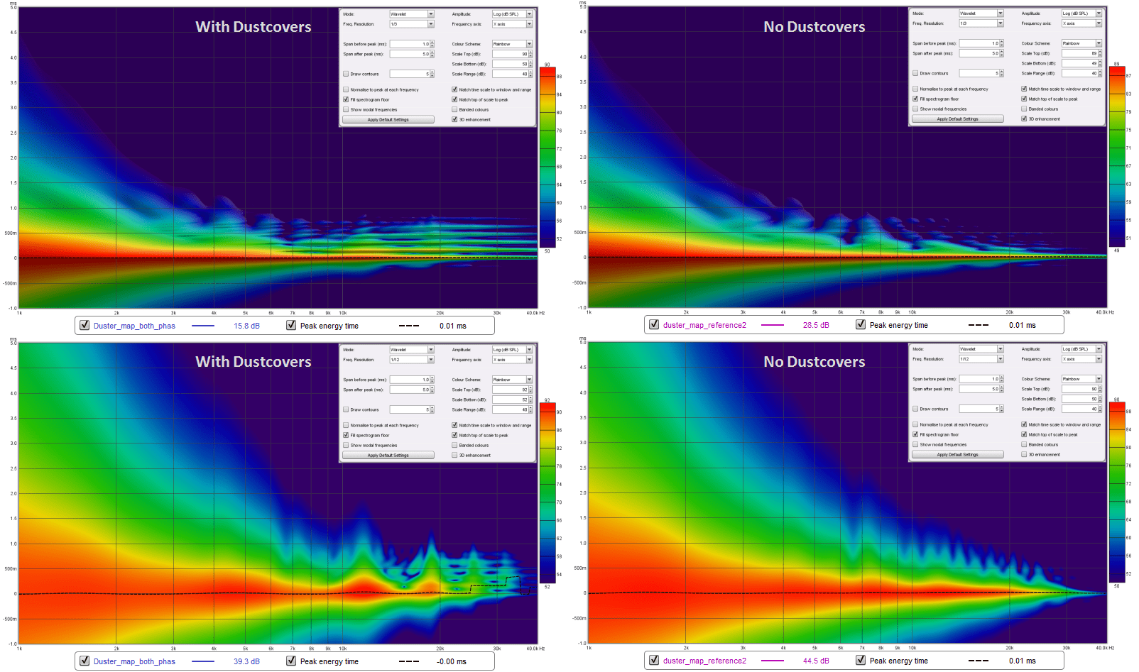

Can you estimate the distances between the diaphragm, dust covers, and grills? Is it the same for front and rear?
My dustcover test shown in Post#18 used front and rear dustcovers at the same distance(26mm) from the diaphragm and no grills.
Based on your outdoor measurement setup description, the ground reflection would be closer to 2mS...which actually seems to show up in your 1/3 octave wavelet plot but doesn't extend much above 4kHz. I guess that makes sense as grass wouldn't be a very good HF mirror. The 4mS reflection must be off the measurement equipment, perhaps laptop screen or chair.

The dust covers are 35 mm from the diaphragm, front and back
The grill is 65 mm from the diaphragm in the middle (vertically). It is closer to the sides, 40 mm.
The original louvre grill was used, not a flat metal so called pro grill.
I don't see how the equipment on the chair could have made a reflection, is was deliberately placed in the dead zone of the ESL. at least 2 meters away.
It is just a small object on a plastic bench with no arms rests, no back support, only a flat seat. But I could be wrong of course.

Thanks for the dimensions. I'll have to cogitate on those a bit to see how they may be related to the < 1mS reflections.
Your measurement setup looks great with the equipment in the deadzone of the dipole radiator...along with the operator no doubt.
I am about out of ideas for the source of the 4mS reflection, but it had to have come from somewhere.
The only other thought that came to mind is perhaps from the mic stand. I'm not sure exactly what your stand looks like or how it was positioned. But if it was similar to attached images(not to scale), reflection off the support pole could have been the source. I have definitely experienced this and had to use foam to minimize it. Another less likely possibility of reflection from the base of the mic stand is also shown. Either one could produce the neccessary ~1.4m path length difference for the 4mS reflection.

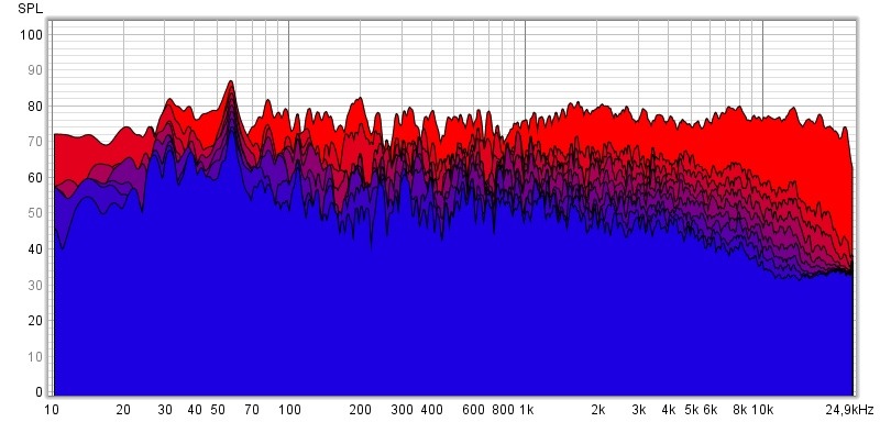

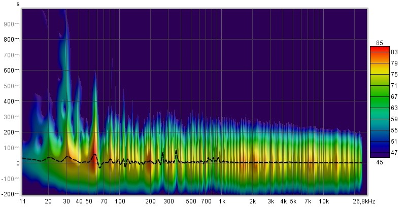

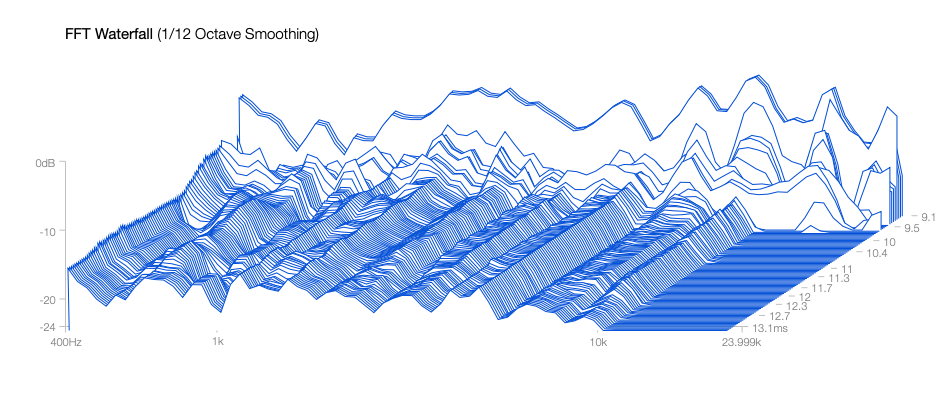

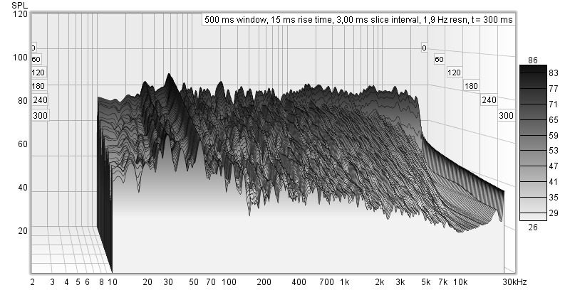

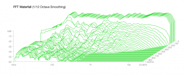

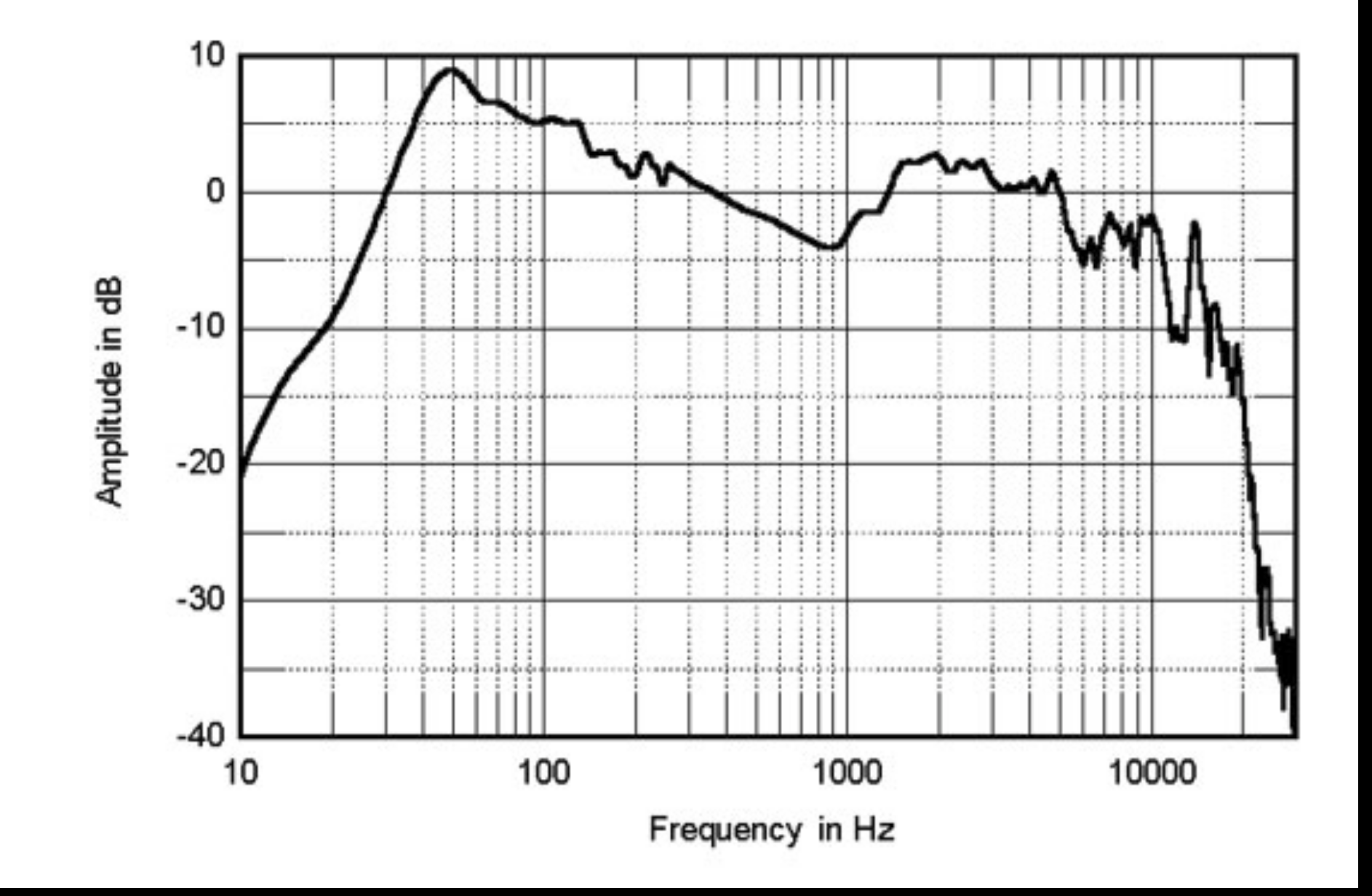

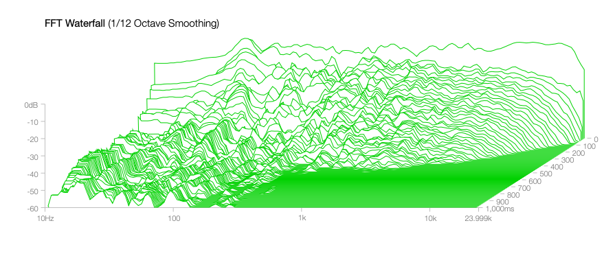

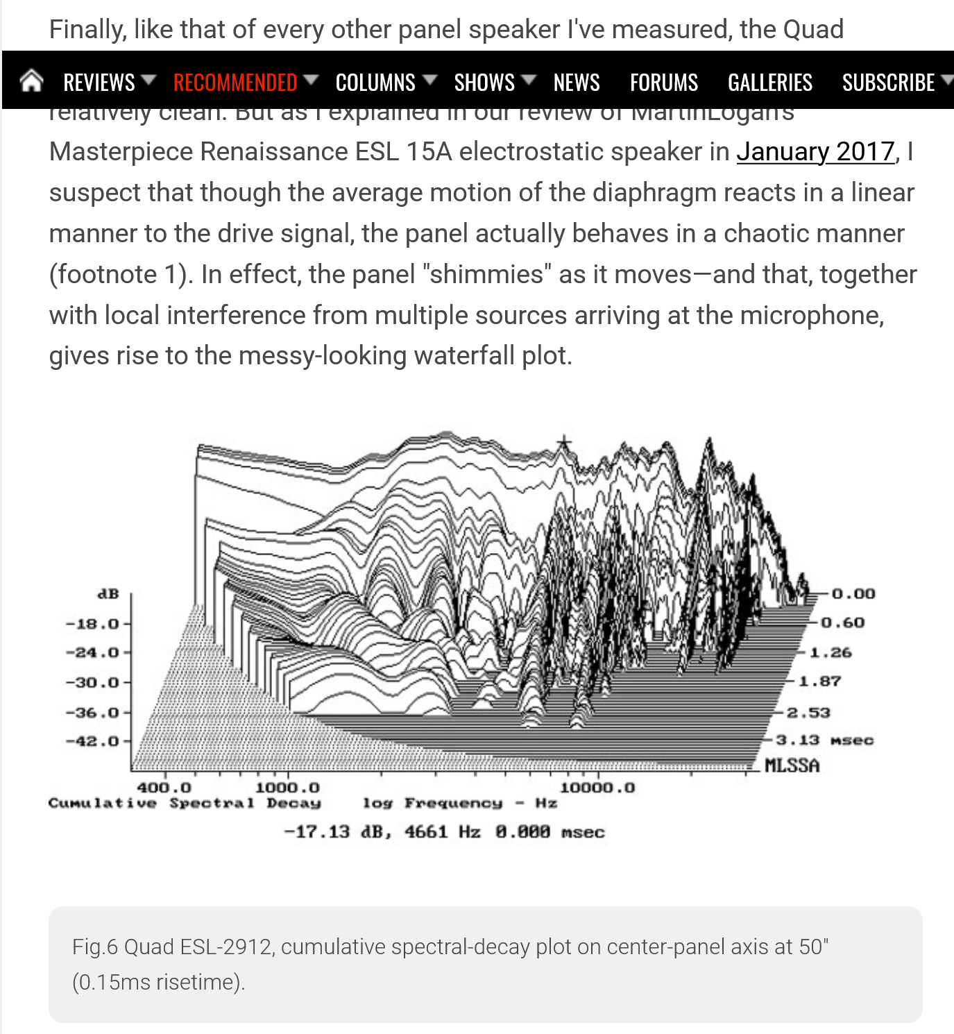

Nice ESL's! I havent seen them so did a search.I think they look great. Impressive size and great 40kHz bass extension.Capaciti E2.5 near field, far field and CSD.
Were there dust covers or reflection interfaces that might explain the CSD high frequency resonance bands? Thanks.
Idea behind replacing esl57 with Capaciti - segmented wire stator design so possible wider dispersion. Bass is more powerfull and extended - not sure if intristic resonance is damped (silkscreen?), see near field response. They are made very sturdy. They have external resistor sockets - 3R3 flatten high frequencies. Similar to Silberstatic?

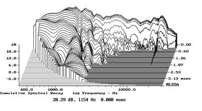

You can also see similarly clean CSDs from a Capaciti review I had grabbed from somewhere...although the pdf resolution is pretty poor. 🙁

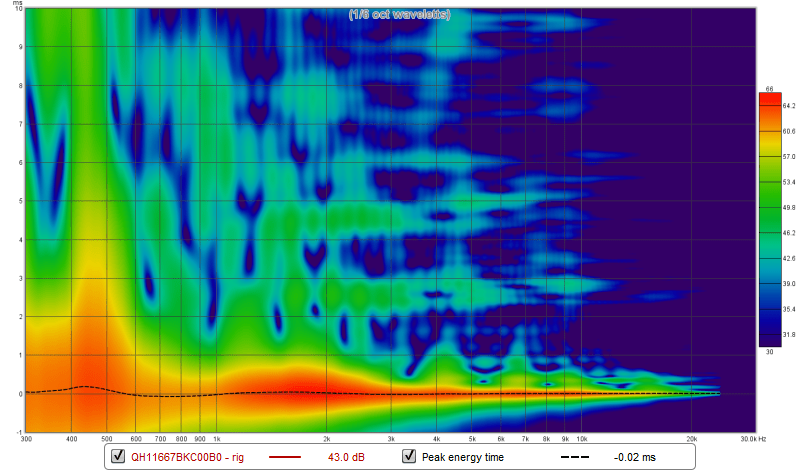

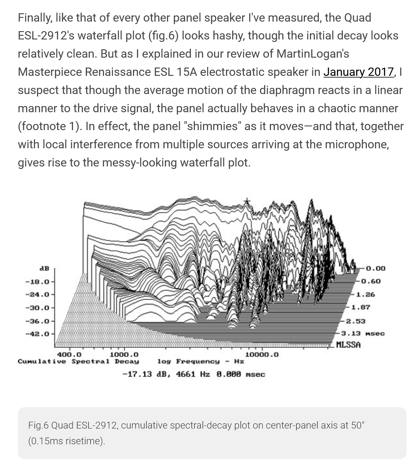

Wow. Those naked Capaciti panel waterfall plots are aspirational. They rule out the hypothesis that all ESL panels have inherent chaotic modes.
But the Capaciti CSD jzagadja posted looks like it might have reflections and the E2.5 has a sock and is 90mm deep:

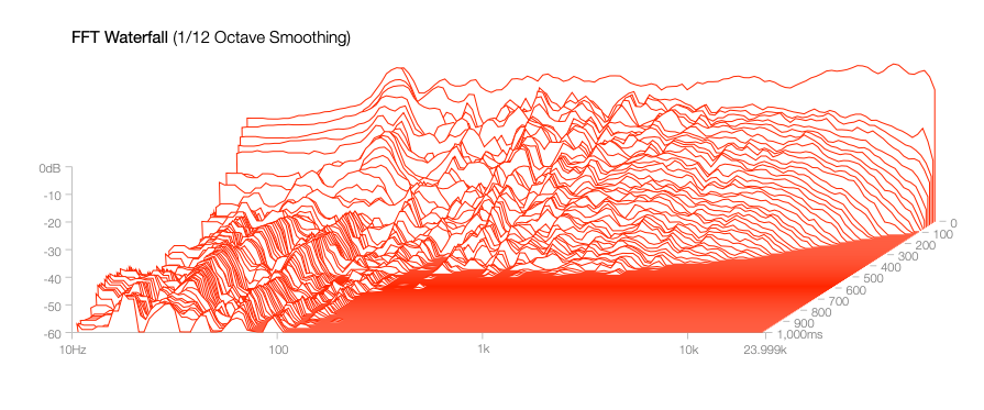

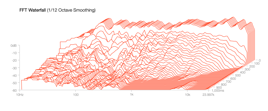

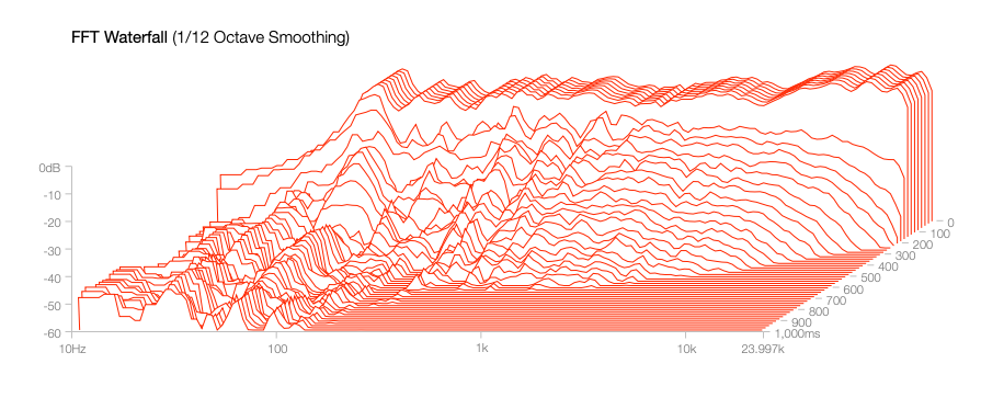

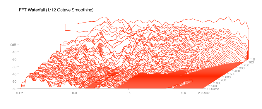

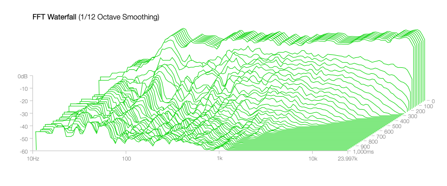

Capaciti seems to have a panel design that has conquered resonance. Despite the Ausdiostatic having similar construction it doent look as clean as the Capaciti CSD ,but could that just be a measurement and plotting scale artefact?

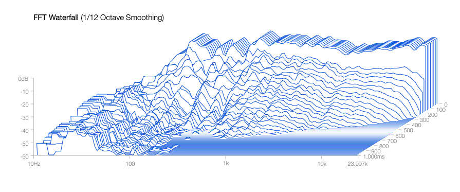

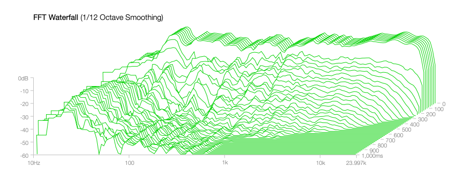

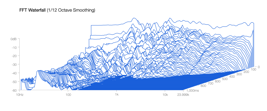

Heres the Audiostatic ES-100 loudspeaker. The panel has no covers and looks very open; yet there is some high frequency energy. Is this an indication of high frequency chaotic modes? Or is the plot scale just very sensitive?

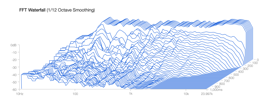

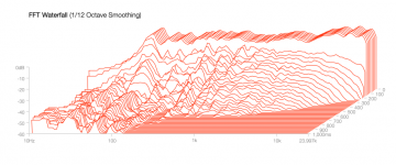

Capacity ESL - unkown finished model with a speaker cloth cover. Super clean above 5kHz but the scale is obscured with the poor quality image scan.
Could the bands at about 2kHz and 4kHz (be the speaker cloth setting up half wave and full wave resonance?

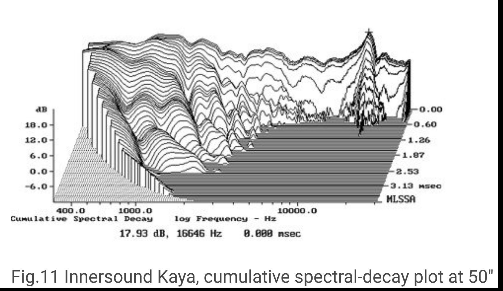

Lets check some data. Impulse response will reveal timing issues:
"Note the excellent right-triangle shape of the panel's arrival, which suggests a time-coherent presentation"
Fig.12 InnerSound Eros Mk.III, step response on mid-panel axis at 50" of electrostatic panel (red trace) and woofer (blue). (5ms time window, 30kHz bandwidth.)
